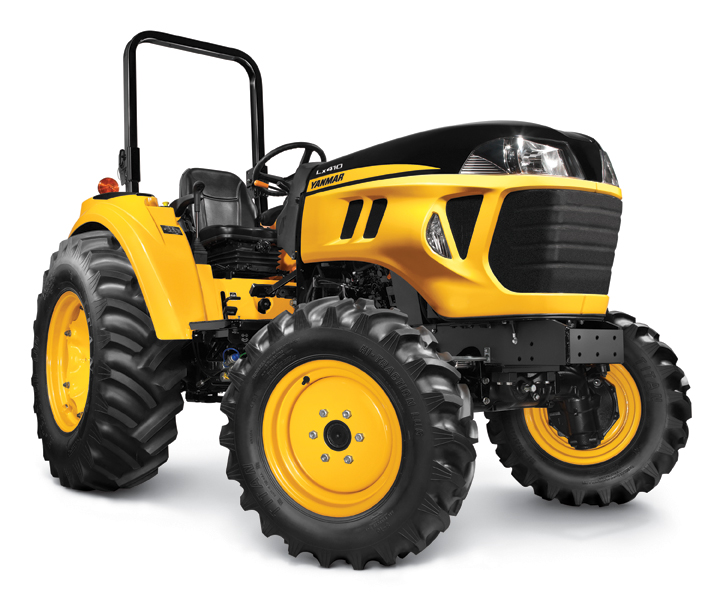

Yanmar is alive and well in the U.S. and now sells its new tractors under its own name here. FYI, my LX4500 (45hp with HST) is a 2012 U.S. model that was produced after the split with Cub Cadet and only has Yanmar labels and part numbers.
I would not be surprised if a U.S. model shows up in France, I've seen the U.S. LX450 being offered on Australian Yanmar websites. Edit: I suspect the reason the larger US shuttle shift tractors would go overseas is too many of them were made for the US market and there was no U.S. HST model available until last year. So as US buyers are buying the new HST models, Yanmar is moving out the surplus of 40hp+ shuttle shifts tractors to other markets. Those are my thoughts anyway.
I got out my caliper and went out to survey my LX's plastic body parts. The hood body is actually made of two parts (not including the grill, lights, etc). The top of the hood, the black piece, is a solid 8mm thick. The yellow piece that wraps around the engine measures a little over 4mm on the edges. The fenders and station body is one entire piece that measures 6mm on the edges. I wouldn't be surprised if the fenders are thicker in places where I can't measure them with the caliper. There are also plenty of ridges incorporated into the shape of the hood and fenders to add strength. The cowl that covers the instrument panel is the thinnest plastic piece and measures a little over 3mm thick.
