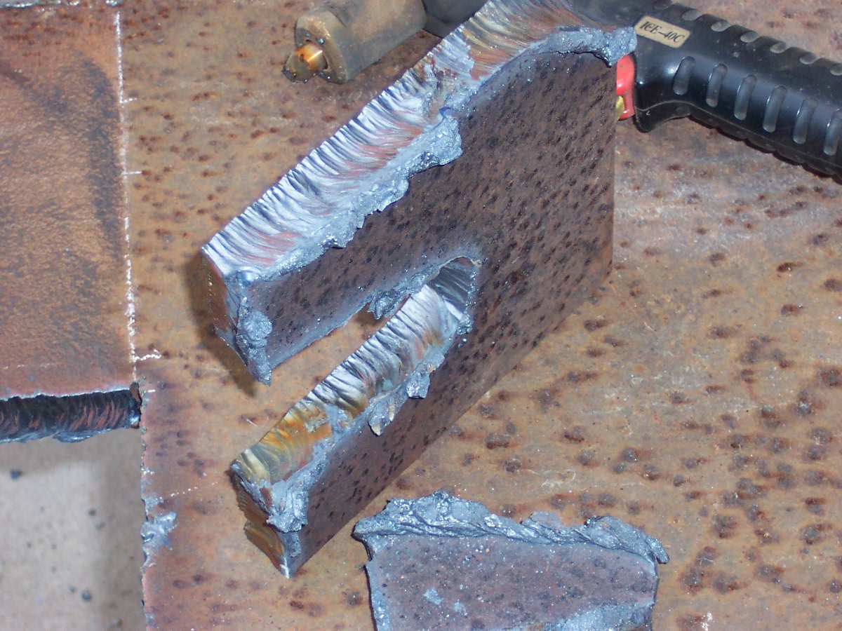

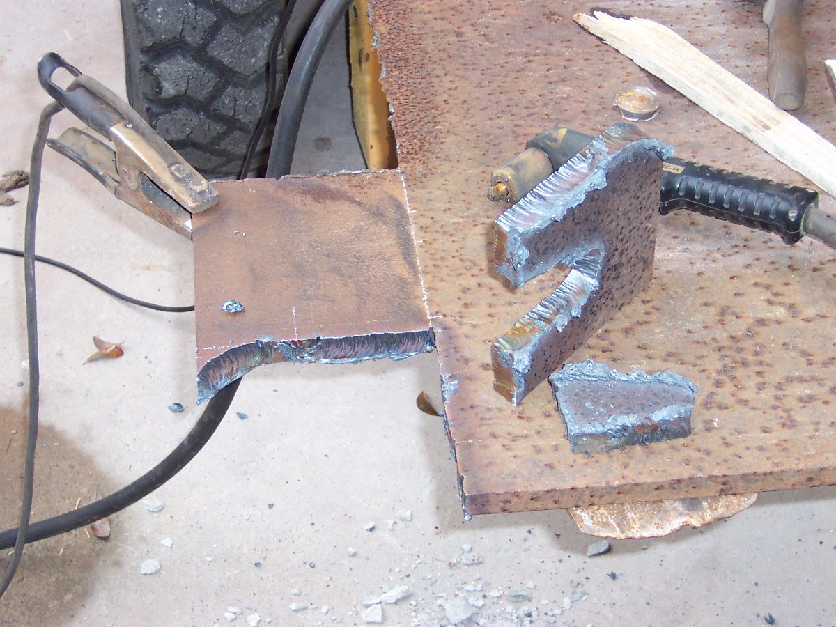

Here are pics of 3/4" plate cuts with my Miller Spectrum 625 40amp machine. This was free hand, stand off cutting. I was right at the limit of my machine. It cuts 1/4-3/8" like it's nothing. I have 25' leads but they also sell 50' for my machine.
I cut a lot of 3/8" and 1/2" bolts that have old mortar on them and it cuts them much better than a torch. Since I got my plasma cutter I ONLY use my O/A torch for heating!
Best thing about a Plasma is no pre-heating, just push button and go. I have learned to carve with mine just like you will do with O/A when fitting or trimming. Also carve out welds without hurting base metal.
Water will shorten tip life. I have about 80' of 1/2" pipe to where I plug in my Plasma so I don't have problems with water.
How do you do free hand stand-off cutting? When I cut free hand (and
most of the time with guides/templates) I am drag-cutting.
I do get slag on all my cuts, but it knocks off very easily with my chip
hammer. I use a dual in-line drier....I have not experimented with other
methods of keeping my air dry. I wonder how much less slag, and how
much cleaner my cuts would be with bottled dry air?
I have gone up to 3/4" with my 40A, too, but it is slow and not pretty. It
does the job, though.

I believe the amount and kind of dross is dependent on the current/amps selection, for the type and thickness of metal, plus the speed of cut, and torch height. There is a happy medium in there somewhere, similar to the sweet spot, where things come together to work best. I have one of the track runners that I am going to try one day. It can take a plasma torch or an oxy/acetylene setup.
Oxygen plasma cutting of carbon steel leads to better cut quality: higher speed, lower bevel angles (squareness), less cut face roughness, larger dross-free window, thinner HAZ, and a more weld-friendly cut surface, which can lower the amount of defects detrimental in a structure
   / plasma cutters #39
I have a track cutter, too. Used it only once. Now I just clamp straight
edges and drag-cut.
I have not experimented much with the relationship betw current, thickness
of material, speed, etc. I have only used compressor air (with drier), too.
Have you ever tried oxygen or other gases, JJ? It sounds intrigueing.
