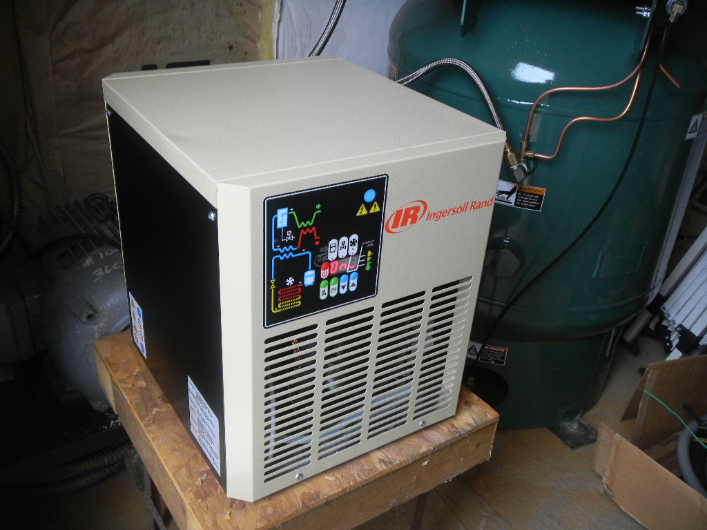

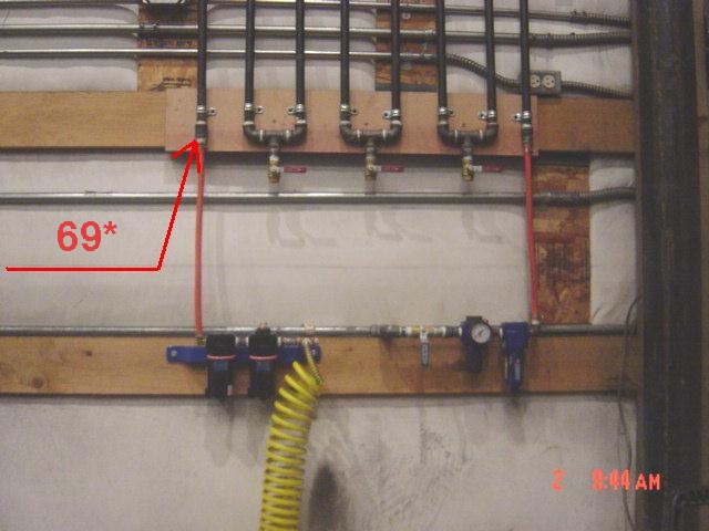

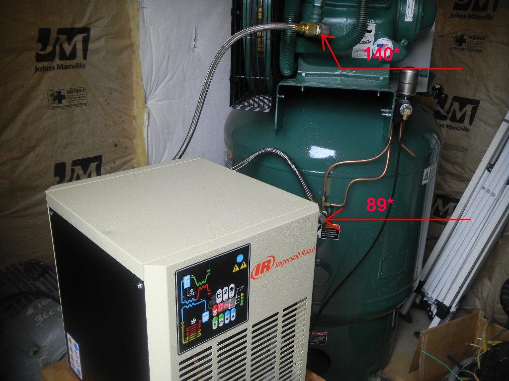

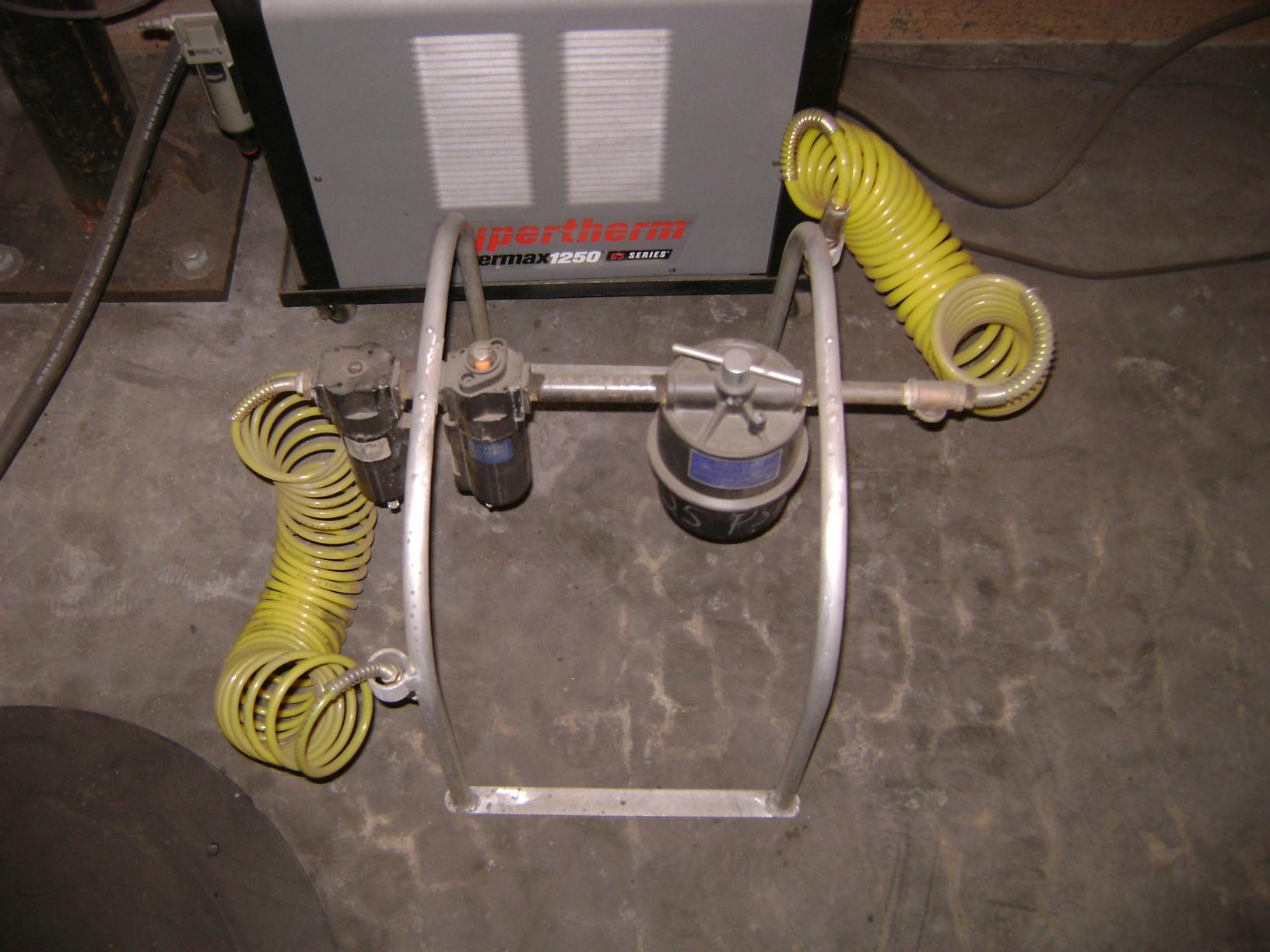

If you do a lot of cutting, or painting. A cooler, after cooler, and a Motor Guard filter system are very good things to add to your shop.
I have installed the large black iron "U's" with drains at the bottom of each. The Franzinator installed before it catches 80 - 90% of the water relative to the "U's". I find it the cheapest reliable way to get rid of most of the water.
