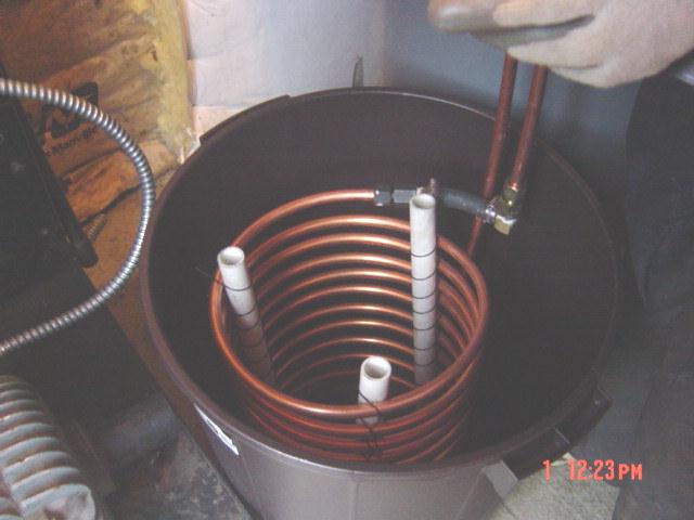

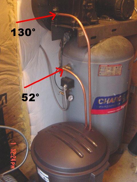

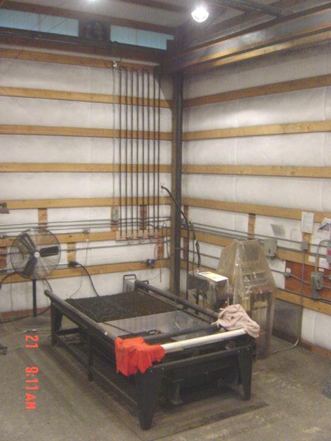

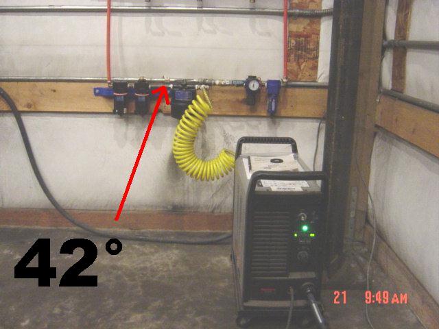

Here are some pictures of my redneck air dryer. :laughing:
Why do the pictures not load in order?!!!!!:confused:

Shield Arc would you explain your dryer, that's my style (homemade). I just bought an in-line water filter by hyper therm, I think, and have not tried it yet, but not using dry air, consumables is an under statement. I thought that with an 80 gal tank & very little use, that is no painting & very little air tool use, I'd be ok with just tank draining. I avoid using the 'plas and grab the o/a torch for this high consumption of consumables.:laughing:
I am guessing he fills the can with ice.
