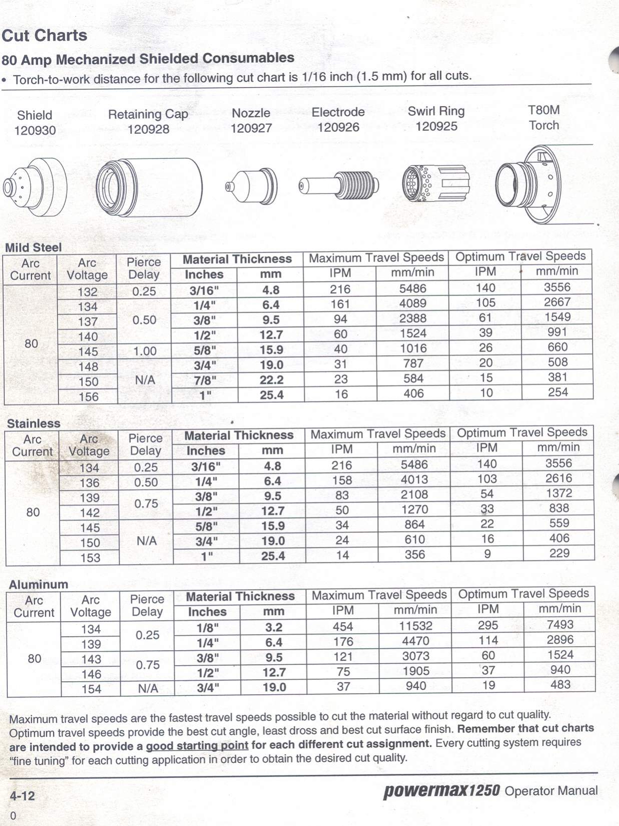

I've got a Hypertherm 30xp and have been using it a fair bit lately (hobby use). The other day I used the fine cut nozzle on 120 v and was surprised at how fast it cut through 3/16" plate at a 20 A setting. I usually run it on 240 V using the general cutting tip and leave the amperage setting all the way up (30A). My question is, should I be adjusting the amperage for different thickness metal or just leave the amperage at max? Are there any advantages / disadvantages to using a lower amperage setting, other than having a higher duty cycle on lower amperage settings? Will my consumables be damaged faster by using the max setting on thinner materials?

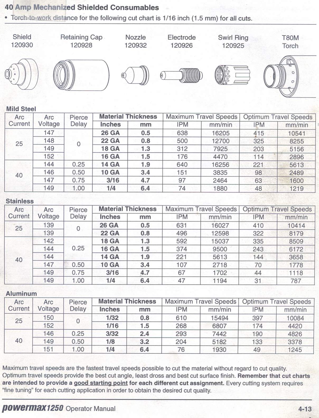

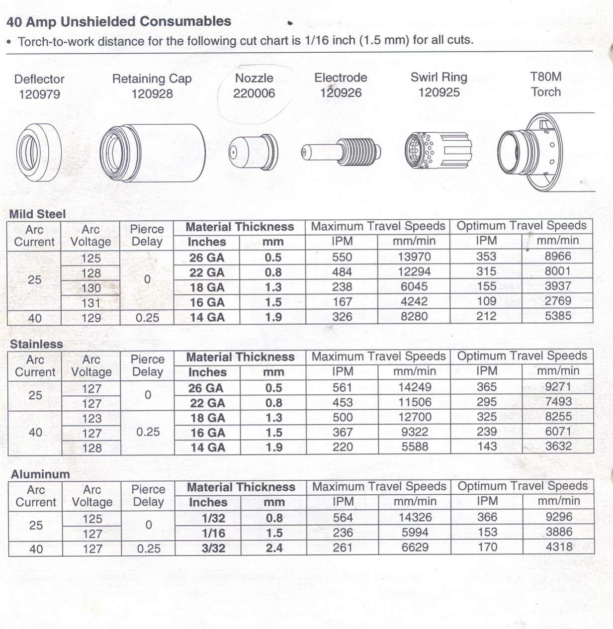

Using a plasma cutter at to high of amps for the thickness of material being cut, is like using an oxygen & acetylene, or oxygen & propane torch with to big of a tip. It's a matter of how fast can you move! Or you'll weld the cut back together, if you don't move fast enough!
These are the cut charts for my Hypertherm Powermax 1250.

The Hypertherm manual for the 30xp is like the one Shield Arc posted for the 1250. It lists cut speeds for various material thicknesses and 2 different amperage settings and 2 different voltage inputs. It appears that there is no need to find the lowest amperage setting for the material thickness being cut. Rather, adjust the cut speed based on what is happening in the cut.

Looks like you better have your running shoes on when you cut thin stuff with the 1250.:)

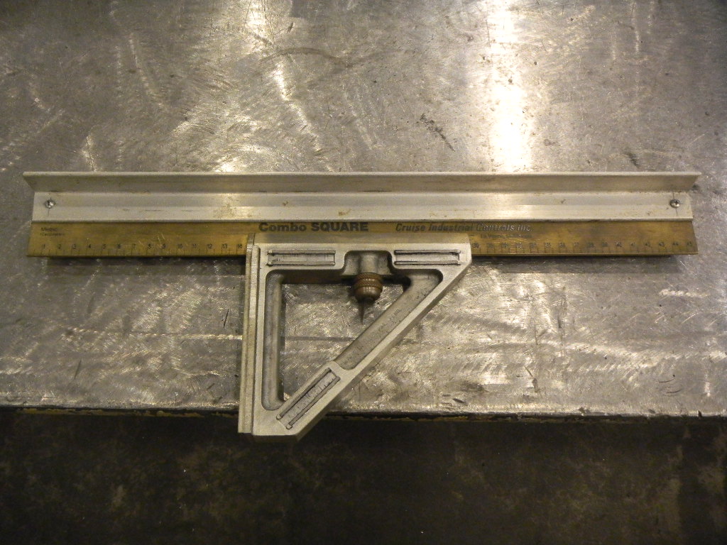

One thing that really helps with speed, is a magnetic burning square.

I like that. Did you make it? Is that aluminum bolted to the square?
Looks like something I could put together. I've been using pieces of flat bar clamped to the work piece but sometimes clamping can be difficult and I have already pulled the torch over the flat bar once. Sure glad I wasn't just holding the flat bar with my free hand.:shocked:

No I didn't make it. I did add the aluminum angle to work better with the plasma torch. You'll have to do a search, there are several different types of burning squares on the market.;)

You can run it wide open on thin material if you want to. You'll get a wider kerf and higher travel speed. You don't want to run 20 amp tips on 30 amps. Match tip to output amps.. Besides, 30 amps is considered a pretty low amp output in the plasma world.
