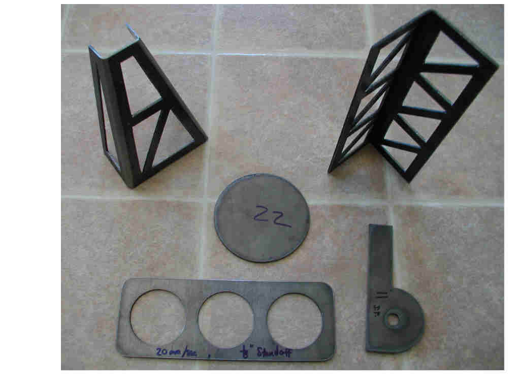

Here are some recent projects from the NC plasma cutter. Yes, it's still alive and working well! I have made a BUNCH of stuff from it over the last two years. It has greatly expanded my fabrication capabilities, to the point I had to add a press brake this fall (what a bad problem). Shown are parts for the snowblower project.
