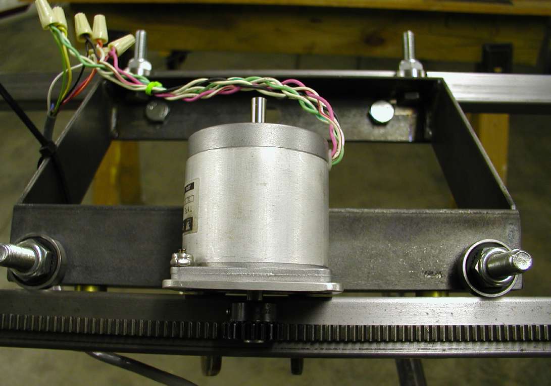

Not exactly a tractor project, but I am hoping this will allow me to build better attachments. In fact, I put the snowblower on hold a few weeks ago, in anticipation of cranking out some cool parts for it with this NC plasma table. The attachment shows a closeup of the 9"x9" truck which will haul the torch handle across the metal (X axis). The truck rides on a gantry which moves fore and aft (for Y axis). The computer will also turn on and off the plasma cutter, so multiple sets of non-connected lines can be cut at once. For instance, think of a complicated shaped sideplate for the snowblower, with a 15" diameter shape blending to a flat, then angling upward and forward, turning down to a small radius, then backwards to the start of the 15 inch diameter again, then it needs a bearing thru-hole and three slotted bolt holes for the hangar right in the middle. All this from 3/16" flat in about a minute to 0.025" accuracy. Plus, both right and left identical. And the uses list keeps growing.

   / Plasma cutter, automation project #7
I like it. I guess it's in gettin the rails dead parallel and then permitting some type of bearing bolt position adjustment? Is a machine torch a CNC mounted oxy/accetelyne torch? I saw one of these gas torches do the stainless steel mounts for my scoot's highway pegs. For days I envisioned all the things I could make with that. This is doing it again. Keep us posted and pictured.

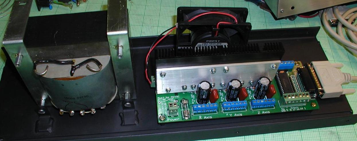

Here's a shot of the power transformer, driver card, one of the two cooling fans. I call this collection the "Power Chassis", and its all mounted on that black tray made of a couple pcs of angle iron and a strip of 1/8 by 6 flat iron. An aluminum enclosure goes over it all, with another fan in it.
