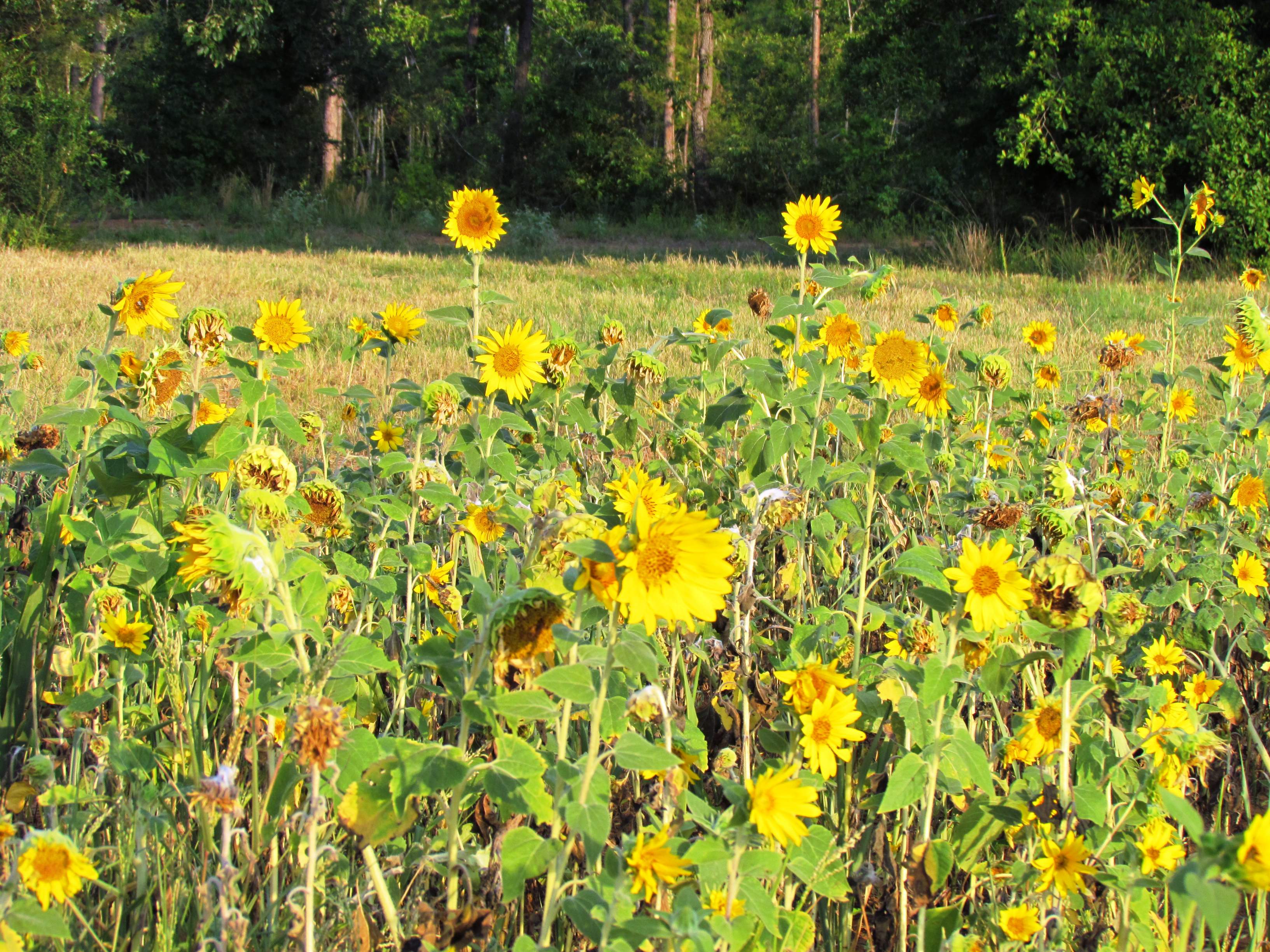

I disked my field and broadcast the seeds, then draged the dirt smooth to cover them. They start to sprout within a week. I bought black oil sunflower seeds for bird feeders. They come up about three feet tall and look real pretty. I do it for photography reasons. I was hoping the deer would eat them, but I didn't see any evidence of that last year. This year I did it a couple weeks ago and I'm seeing them starting to come up nicely. I have red clay soil, which seems to be good for them. When the drought came, they lasted quite awhile, but where all dead and gone by mid summer. We had almost three months of 100 degree temps and no rain. I'm hoping that this year it will be better and they last longer, but as long as I get good pics before summer hits, I'll be very happy.
