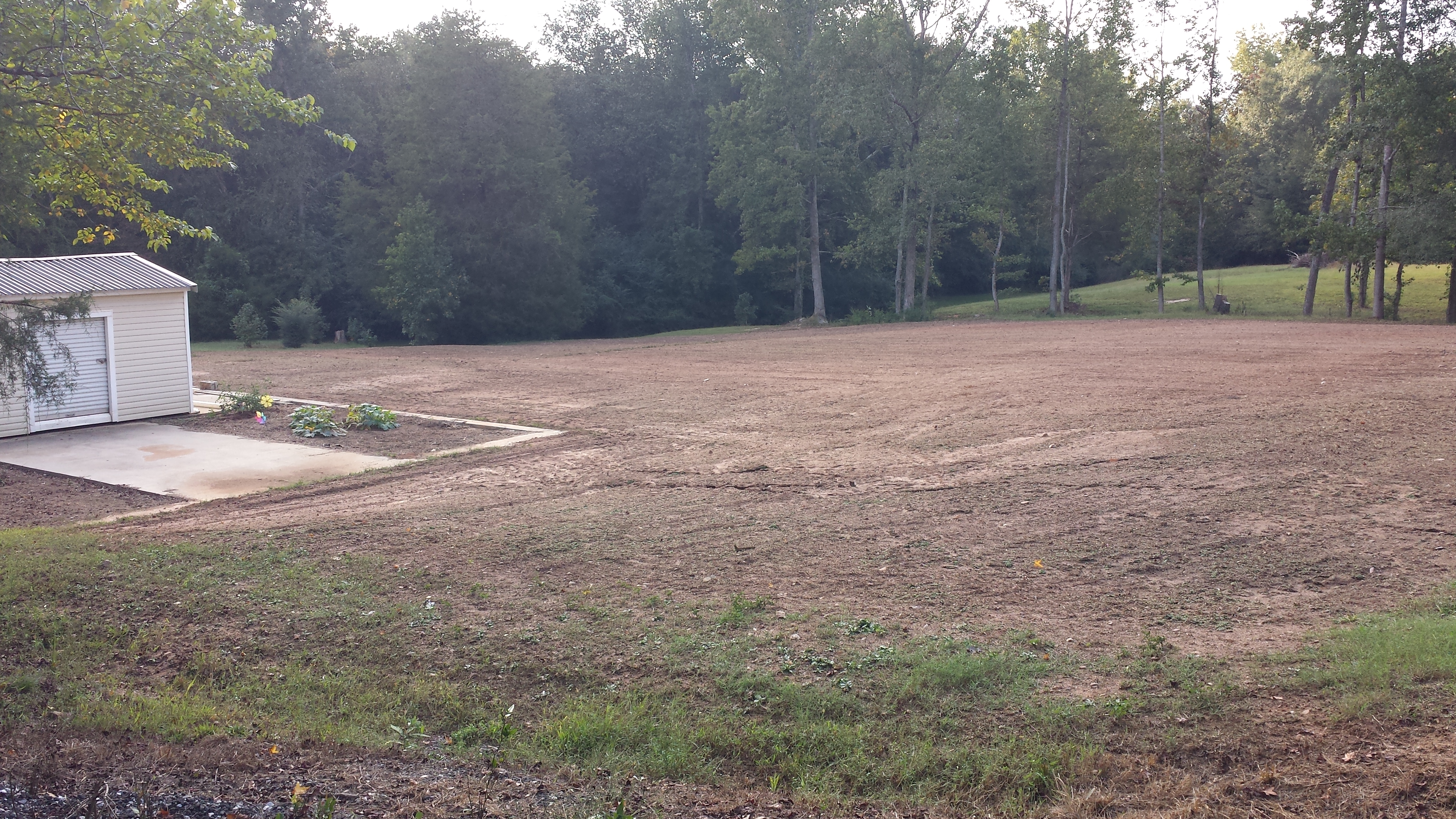

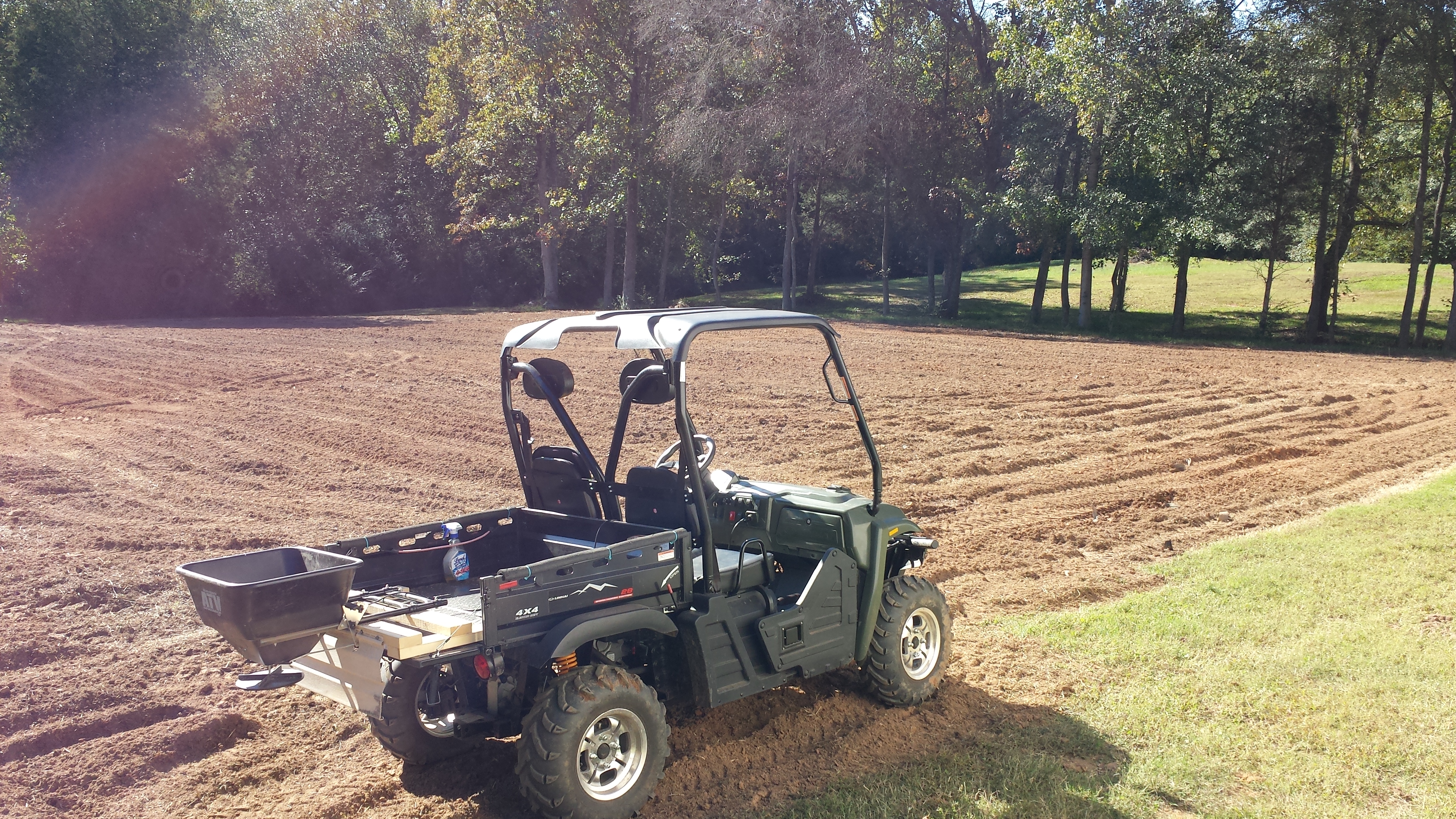

You may be able to get by dragging a chain harrow behind that ATV after you broadcast your seed. It worked for me but I tried using my landscape rake and it did almost as well. Of course, the best would be to spread a small layer of wheat straw hay over the seed immediately after broadcasting and watering it in good.

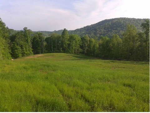

Well, we planted the Tall Fescue and White Clover in early April. The Ag extension suggested the seed ratio which we followed. Most of the soil was still relatively loose from being worked in October, so we crossed our fingers and did no prep before seeding. The co-op had no equipment to loan or rent. We waited until the weatherman said "rain tomorrow" and spread the seed. 12 miles on the ATV with an electric spreader. Did full field in N-S passes, then again in E-W passes. Rain came as promised. 1/2" inch in each of the next 2 days (deja-vu) then a mix of heavy and light rain for the next week. The light rains worked the seed into the top of the soil, so the heavy rains did not wash it away. The neighbor who did the spreading sent me this picture last night. Picture is from the south. Future barn site is at far end of the field to the north. He used less seed at the build site, as it will be destroyed as we work.
It looks great, but I know there is MUCH to do. Leftover roots and rocks abound, and are becoming visible as the worked soil subsides. I will be there in June, and expect to spend a day hauling that stuff out of the field. We are really pleased that the cover took so well.

Looks like the second attempt was a success. I would suggest that if you havent already, to apply some fertilizer now. Fescues need 50% of all fertilizer applications during the fall and early spring. When it turns hot and dry in the summer months, the fescue will go dormant and any fertilizer app's at that time will just fertilize the weeds.
