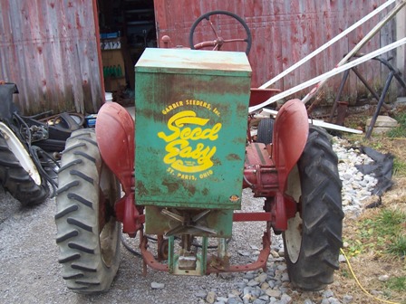

I have to agree with Sixdogs on the frost seeding. I've been using it for 20 years on my hay field, and horse pastures, in fact. it's almost time to do that here in Ohio. I plan to do a light seeding on my pastures myself. I use one of the old pto driven Garber Seed Easy spreaders. You can usually find them
on ebay for less than $100. I bought one, like this one pictured below at an auction for $20. Best $20 I ever spent. Bolts on the draw bar, and PTO shaft is a piece of straight radiator hose. It holds approx. 15 lbs. of seed. It's best to find one with the seeding rate settings decal on it. Most are still there, if it's been taken care of. The company may still have new one's if it's not there. The best time to do it here, is the last two weeks of Feb., or the first two weeks of March, when the ground is going through the freeze/thaw cycles, and the top surface honeycombs. You're basically mimicking Mother Nature, when grasses/plants drop their seeds. The honeycomb effect, opening and closing in the freeze/thaw cycle,will pull the seed into the ground.
