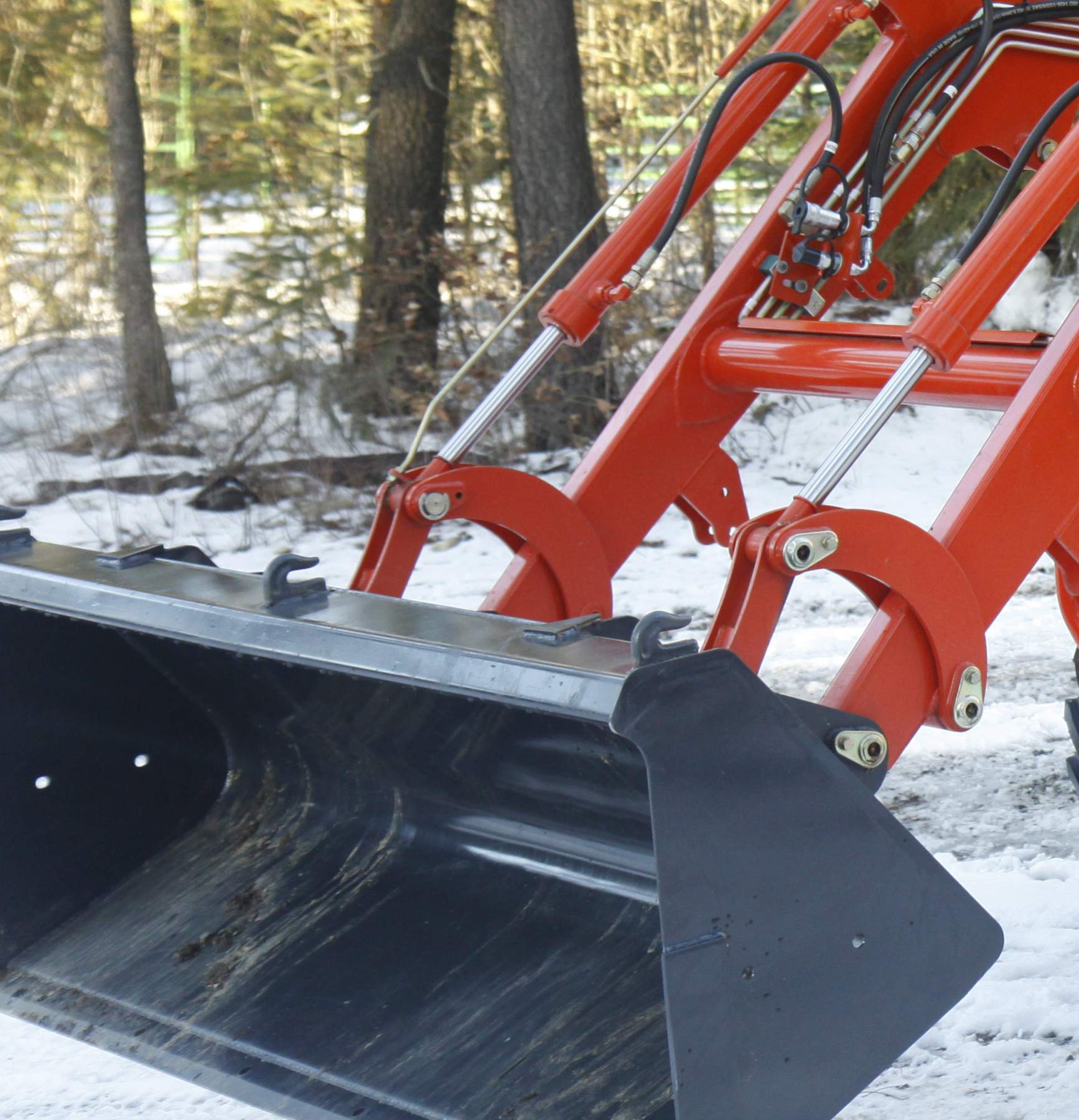

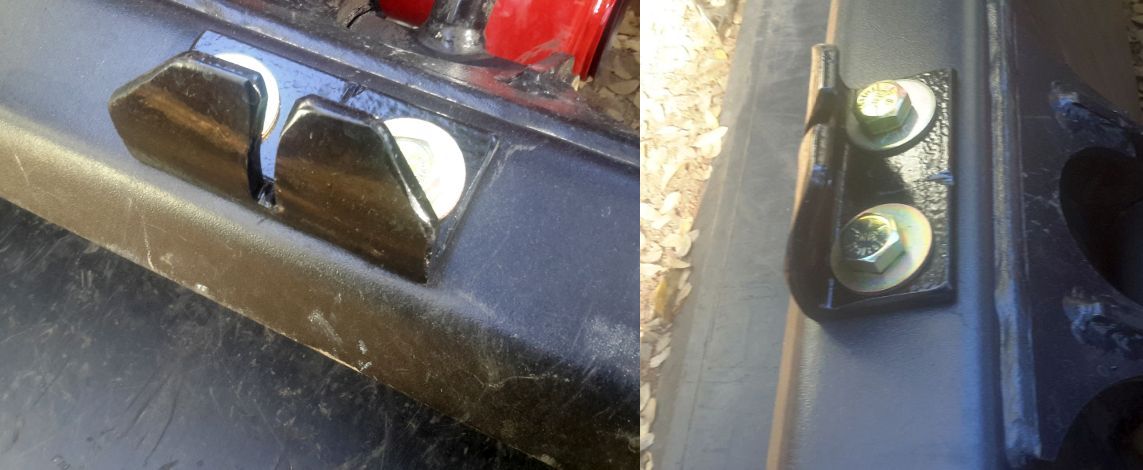

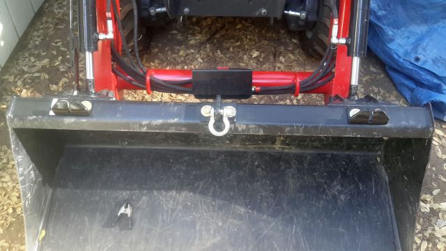

I've put two at the outer ends of my bucket with one in the center. All three are on 3/8" steel 6' wide reinforcement plates.

Why drill? Much easier to weld if you have the machine. Bolt on's are fine for someone without a welder or welding ability. --------------------.

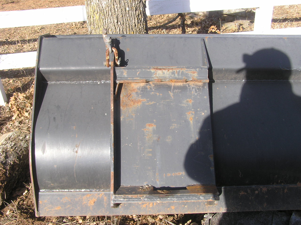

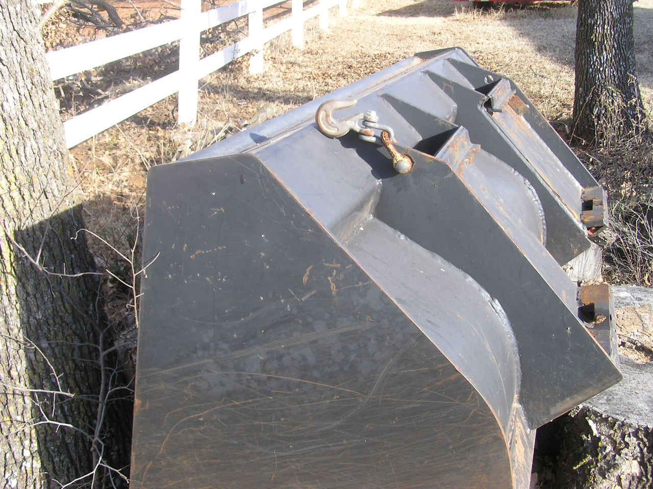

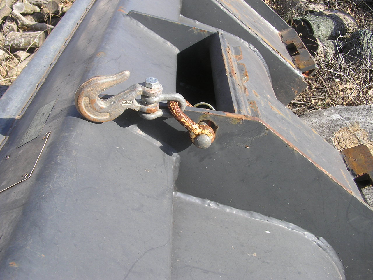

Did not have to drill. Hole was there. Can run the chain forward or down the back:

i added a top reinforcing plate on my Kioti bucket so i could add a 2-5/16" batt to move my horse trailer, and support the hooks. ive used this for 10 years now without any damage to bucket. I did not worry about the outer 2 hooks as they were so close to the supporting edge. not the slightest hint of a bend. bucket hooks.jpg 0327111410.jpg
If i had this bucket, i would not need hooks. those were my dogs. 0208 adj.jpg

Why drill? Much easier to weld if you have the machine. Bolt on's are fine for someone without a welder or welding ability. I like to weld a reinforcing plate on the bucket first then weld on the hook. Cant do that with bolt on hooks.
Because I have doubts about my little HH 140 welder and it operator to create a bond that will be reliable.... And I learned about bolts and nuts in the 38 years in a industry where you could not weld in side customers building....
Besides I think two 150,000 PSI grade 8 bolts has more holding power the a 70,000 PSI weld....
