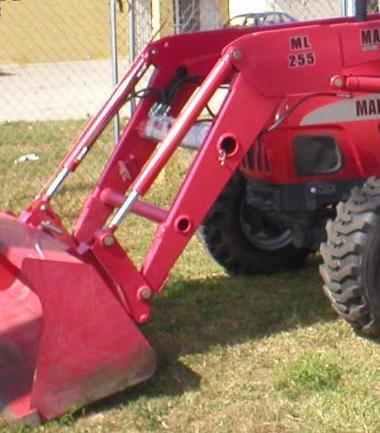

OK, as a sweeping generality I dislike the idea of "single point of improvement" modifications.
They typically open opportunities for dangerous stress elsewhere or instability.
That said, FELs are long fairly flexible parallelograms and I have often thought that some diagonal bracing would make them less flexible for very little cost or weight penalty.
When a FEL frame flexes the load shifts (Yeah, obvious) and those little wobbles could add up to a tip over, which is what I think the O/P has been telling us.
Looking at my tractor with the loader down I think a couple of straps could be added in the form of a cross that would just about center over the hood.
Then a similar cross on the front arms centered in front of the grille.
Maybe 2 inches wide, 1/4 or 3/8 think ?
I don't think this would obstruct visibility significantly, add much weight, or cost a lot.
I think I would only weld the ends, at least initially.

I will agree that diagonal cross bracing could make the boom very stiff and stronger, but I'm not willing to make permanent modifications that are that far out of the norm and potentially obstructing visibility for the sake of this temporary heavy pallet work. I think the plan is set and repairs will be as described above. Now we've just got to figure out when we can give up the tractor for a few days.

Deflection of one arm more than the other causes a torsional force. The best cross brace between arms is a large diameter round tube.
larry
It did not escape our notice that the larger Mahindra loaders have two round tube cross braces instead of one. But this approach would be difficult to do as a backfit. Our one cross brace is halfway between the two shown here and loader plumbing is above and attached to it.
