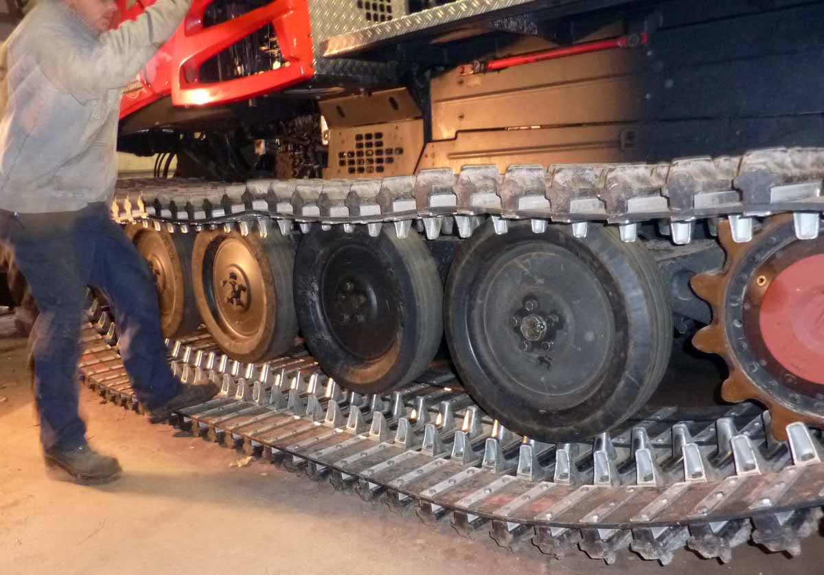

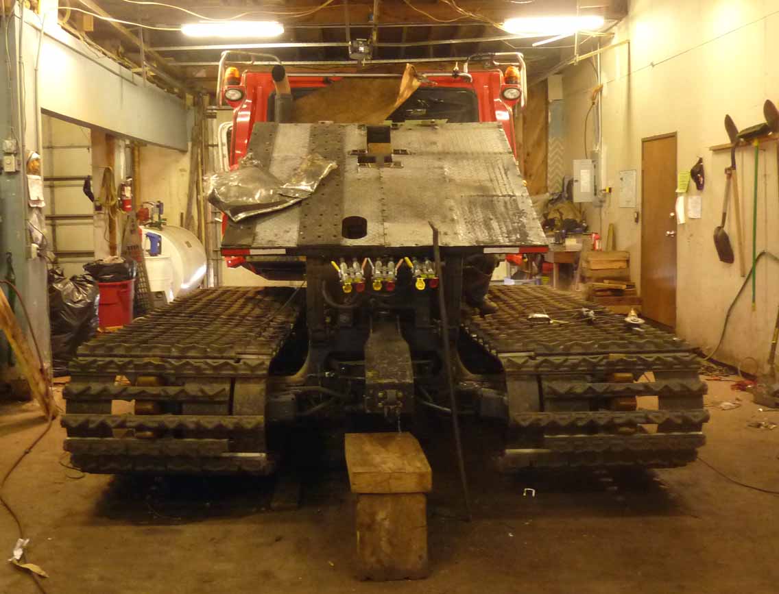

The tracks on the 2nd PB-400 were dropped today so as to service the hubs and replace one torsion spring and its idler arm.. In the 1st photo you can see its up on blocks and the tracks are lose. The operator has used this machine for two years and this was the 1st suspension grief he'd had. As stated earlier, this machine has over 8000 hours on it. First thing was to replace the gear oil in the planetary drives. These are two speed type drives.
I'm kind of surprise in the interest of these machines here. The PB-400 are considered "mid" in size built by Kässbohrer.

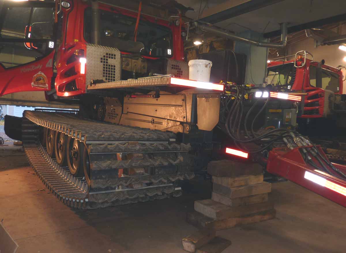

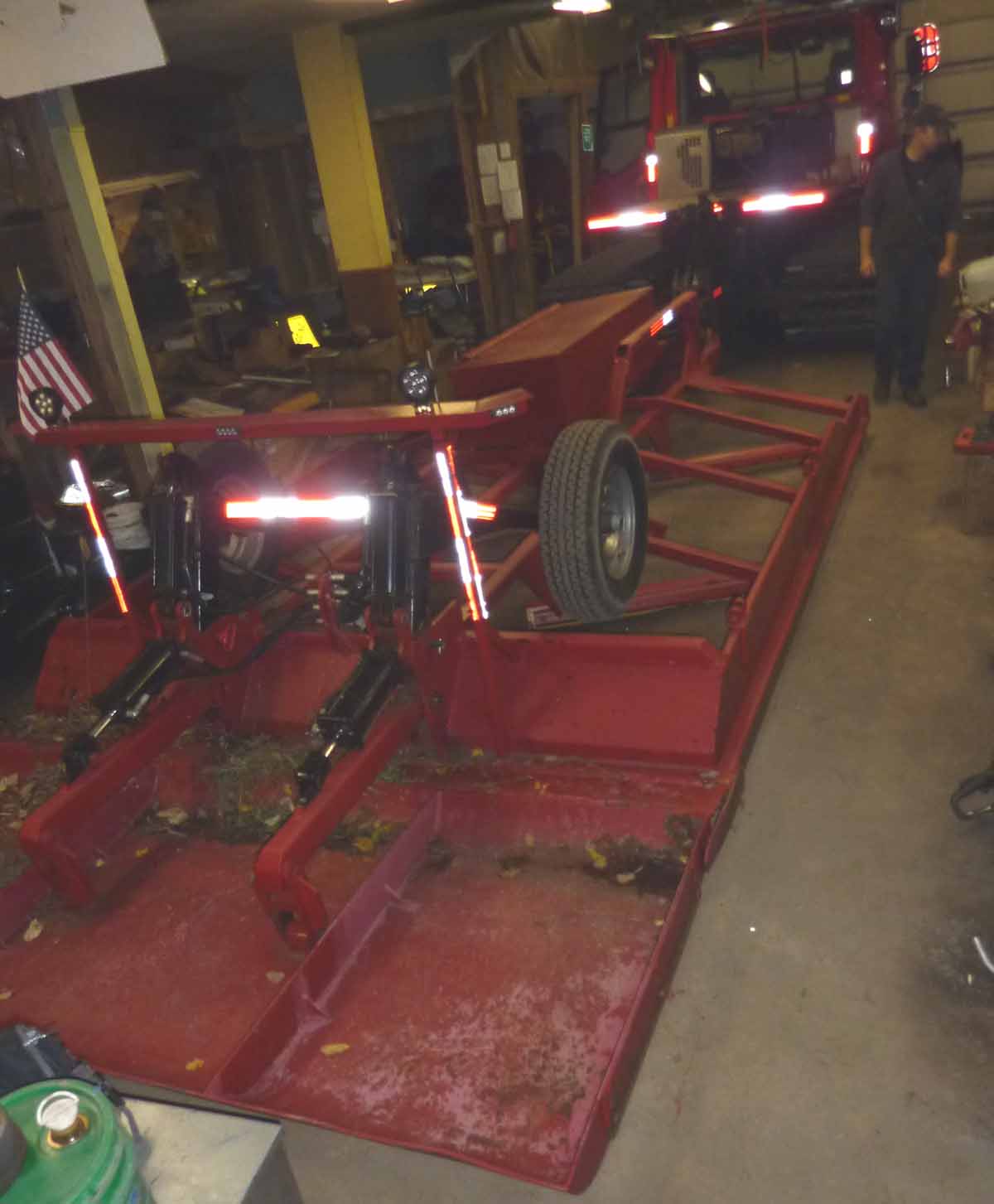

Any pics of what the machine is dragging behind it with all those hydro lines?
   / Pisten Bully 400 service and operations
#53
Here is two. If I miss a question someone asks, just PM me to remind me..

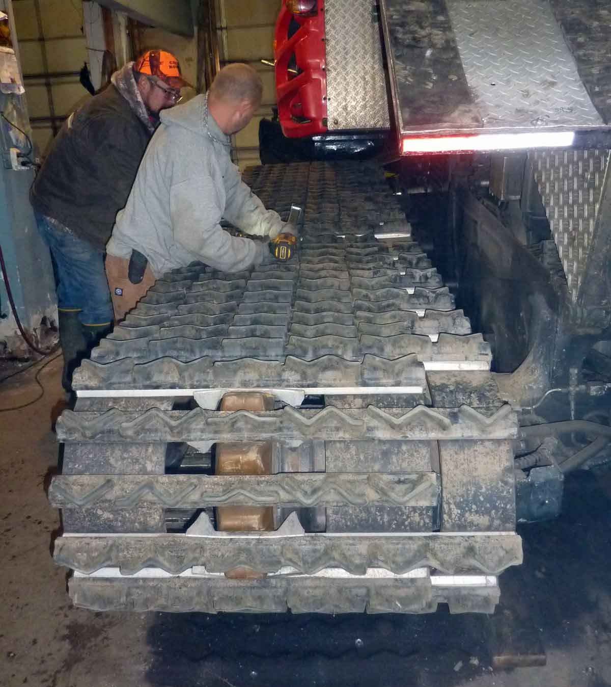

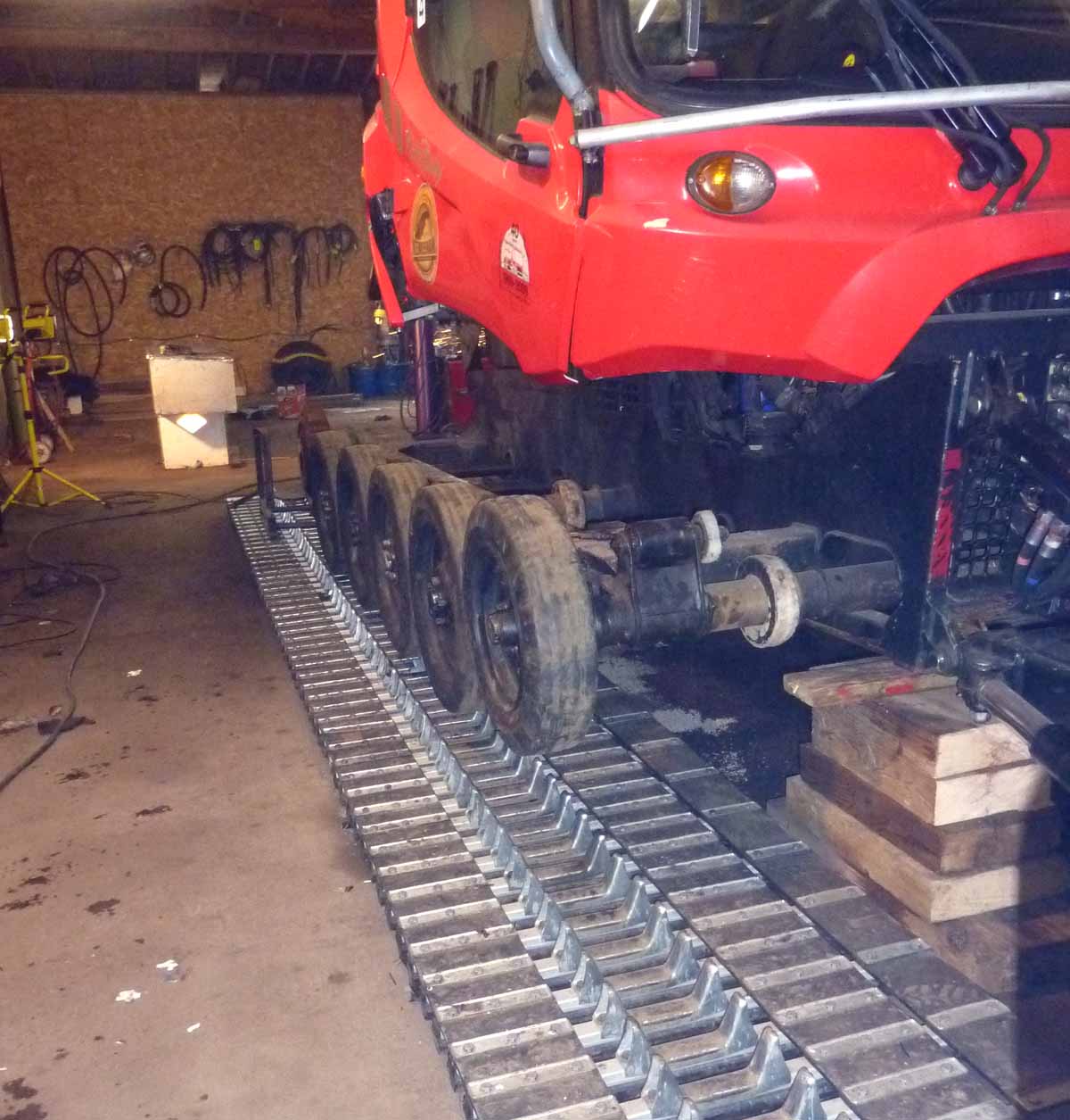

Tracks went back on one machine while the other is having its hubs rebuilt and planetary hub regreased.
All that while a nice snow fell outside. :)
