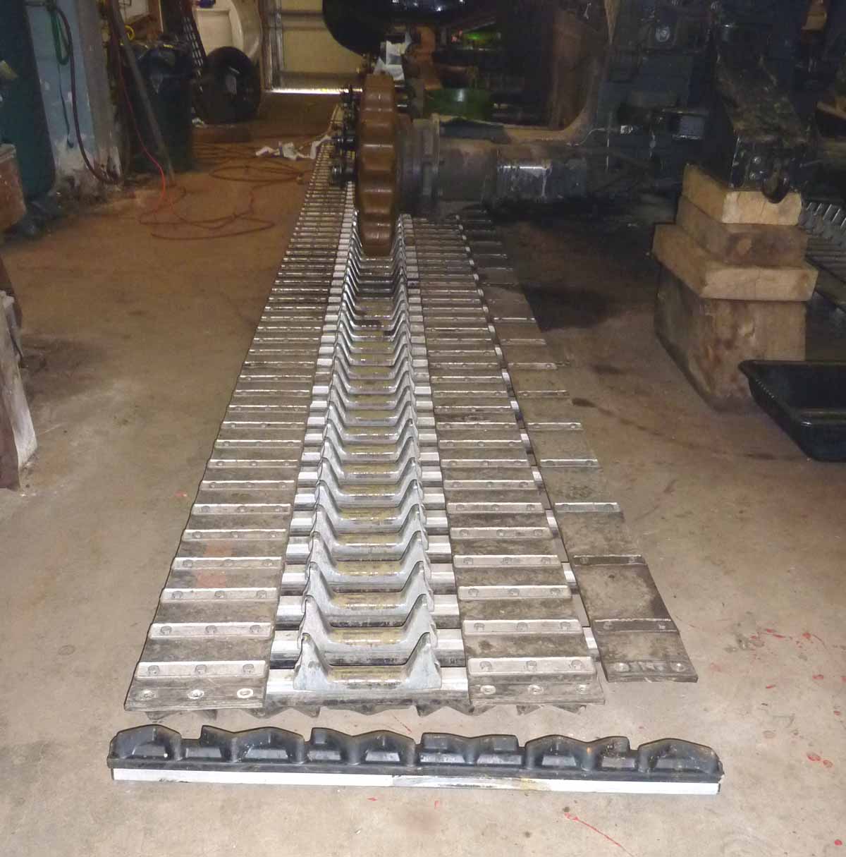

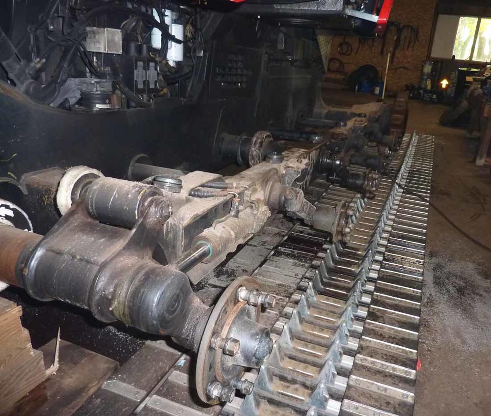

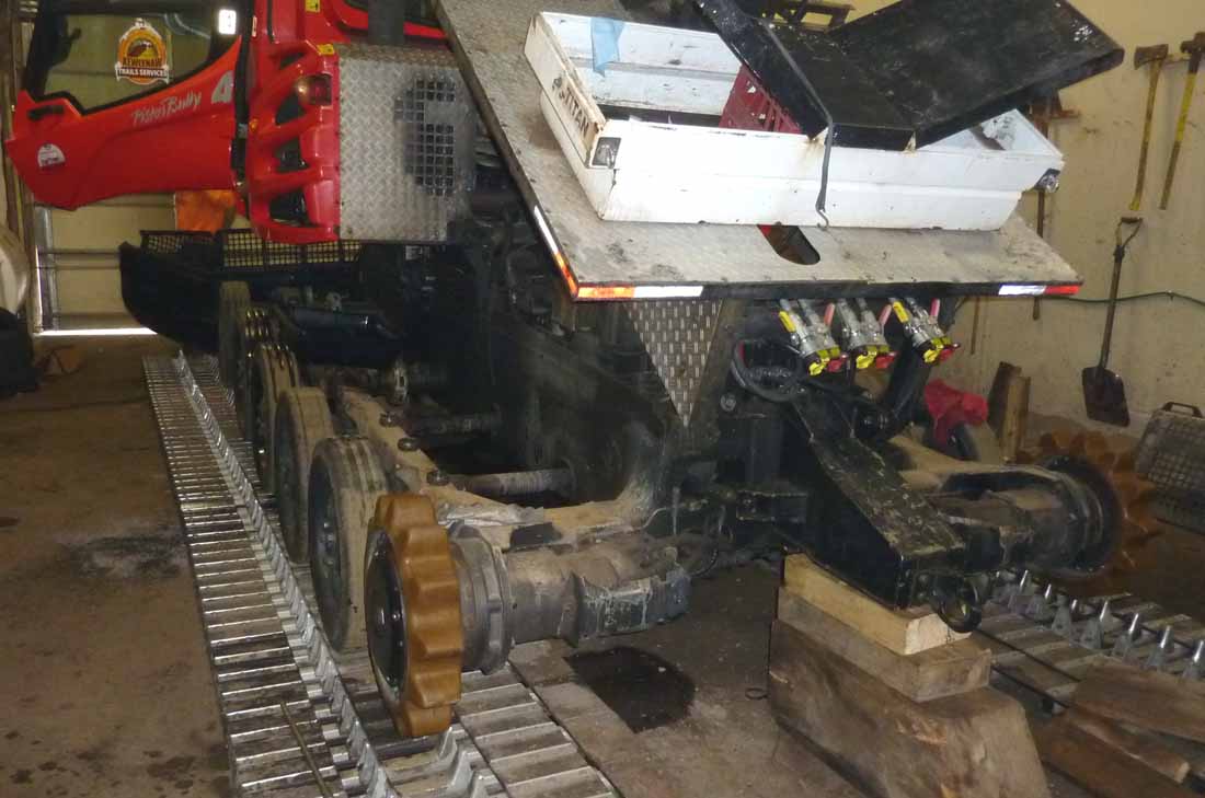

#21

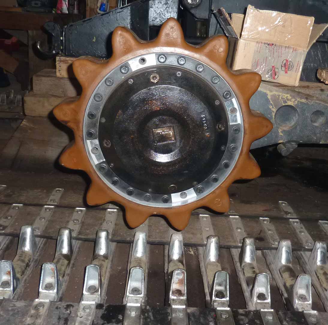

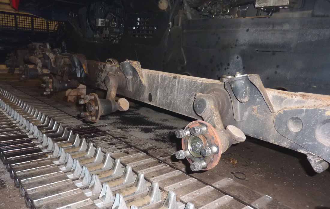

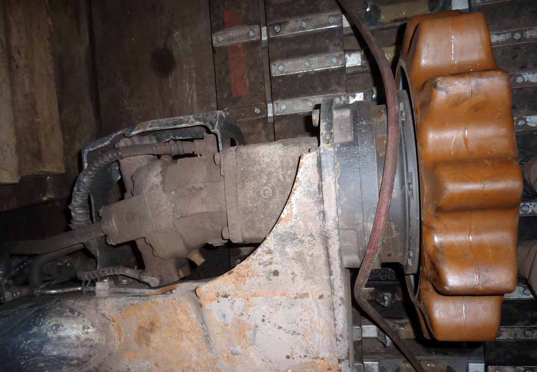

The tracks were pulled to service the torsion bars, hubs bearings and the tracks themselves. These are not the wide at 30+" something. (I forget there actual width) In the second photo is the cylinder that keeps them tensioned which is adjustable via the operator.

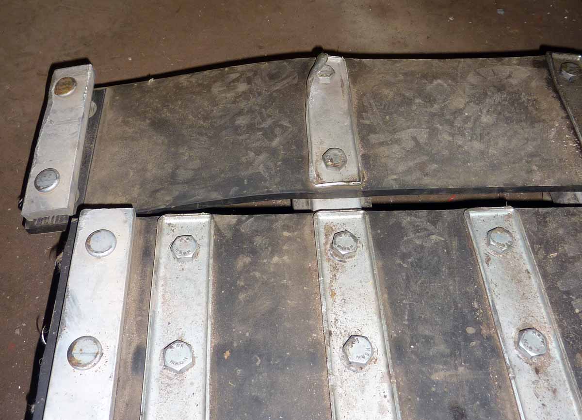

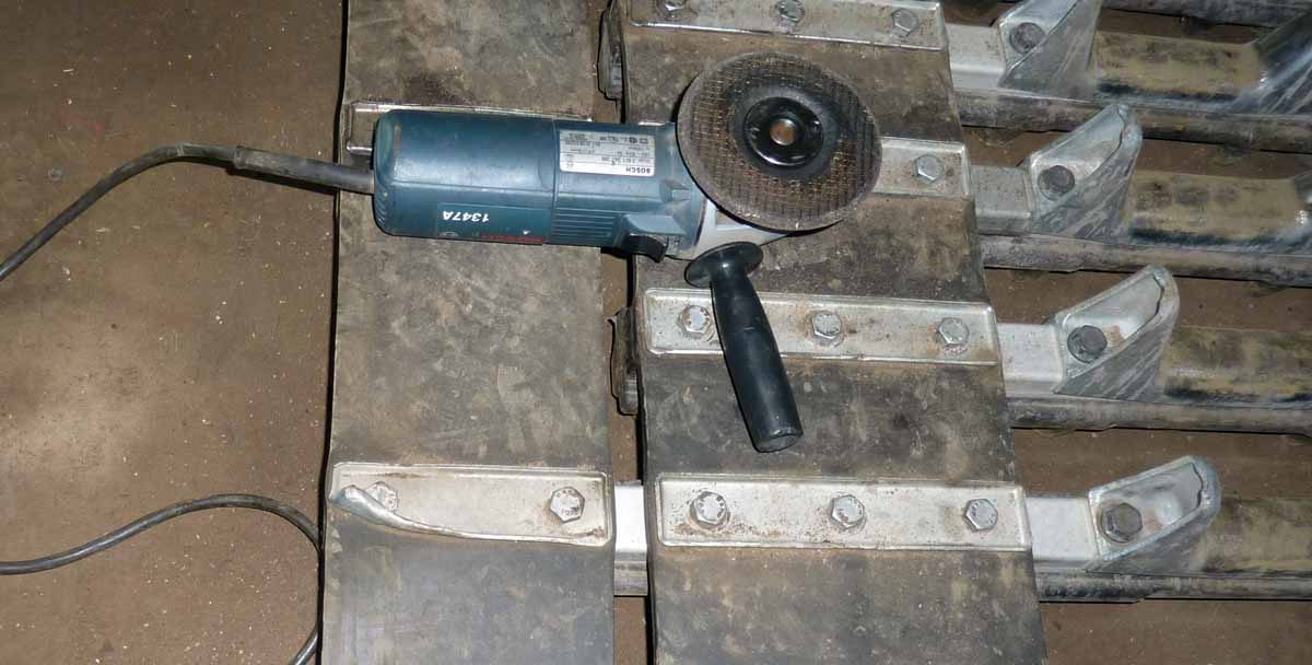

#22

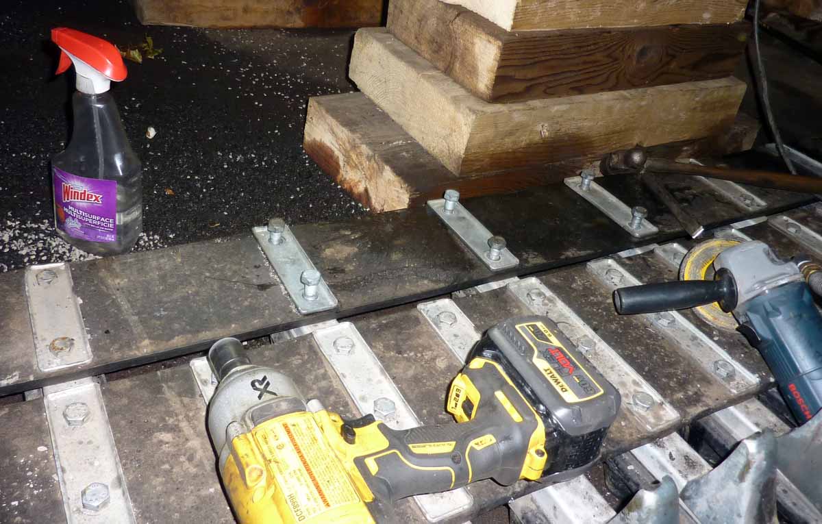

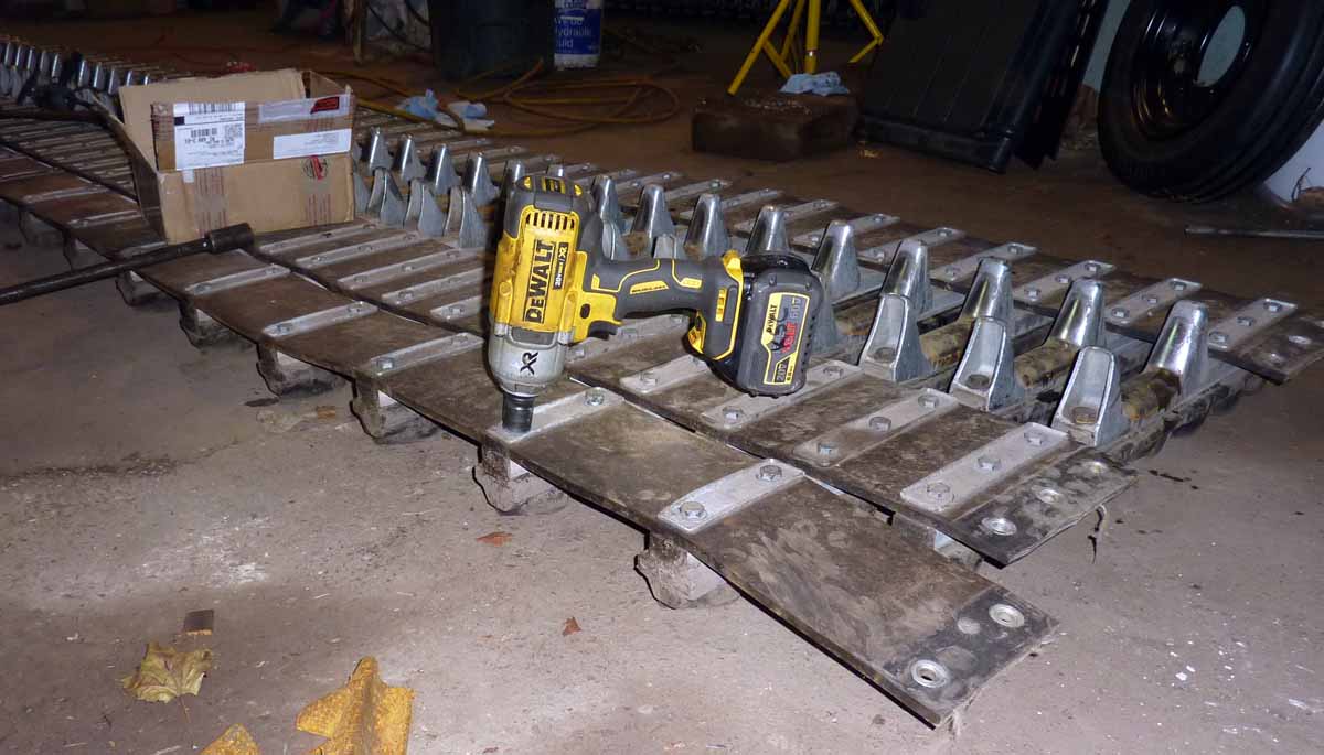

While the tracks were off, I replaced all the bent tack mount brackets as seen in the 1st 2 photos. The water bottle was to cool the plates as they were ground down. I also had replaced a complete cleat and guide since a bolt was broken within the unit but no photos were taken. :(

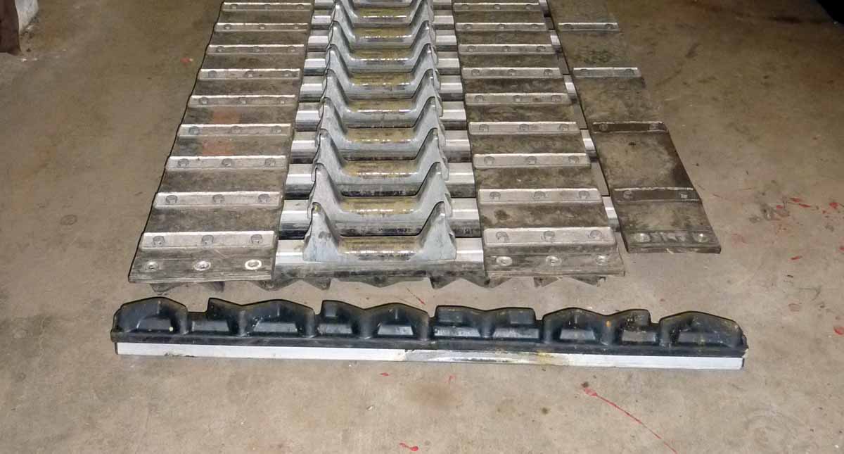

You can purchase whatever cleat style and width, to fit your particular needs. Ours are on the narrow side at 38" due to the medium moisture content snow we receive here and our trails narrow width. Those cleats make the Bully very close to the same width as the drags we use. We use rubber cleats for road crossings. Cleats also come in steel or aluminum construction and up to 6ft wide for the 400. They are different from construction machine tracks.

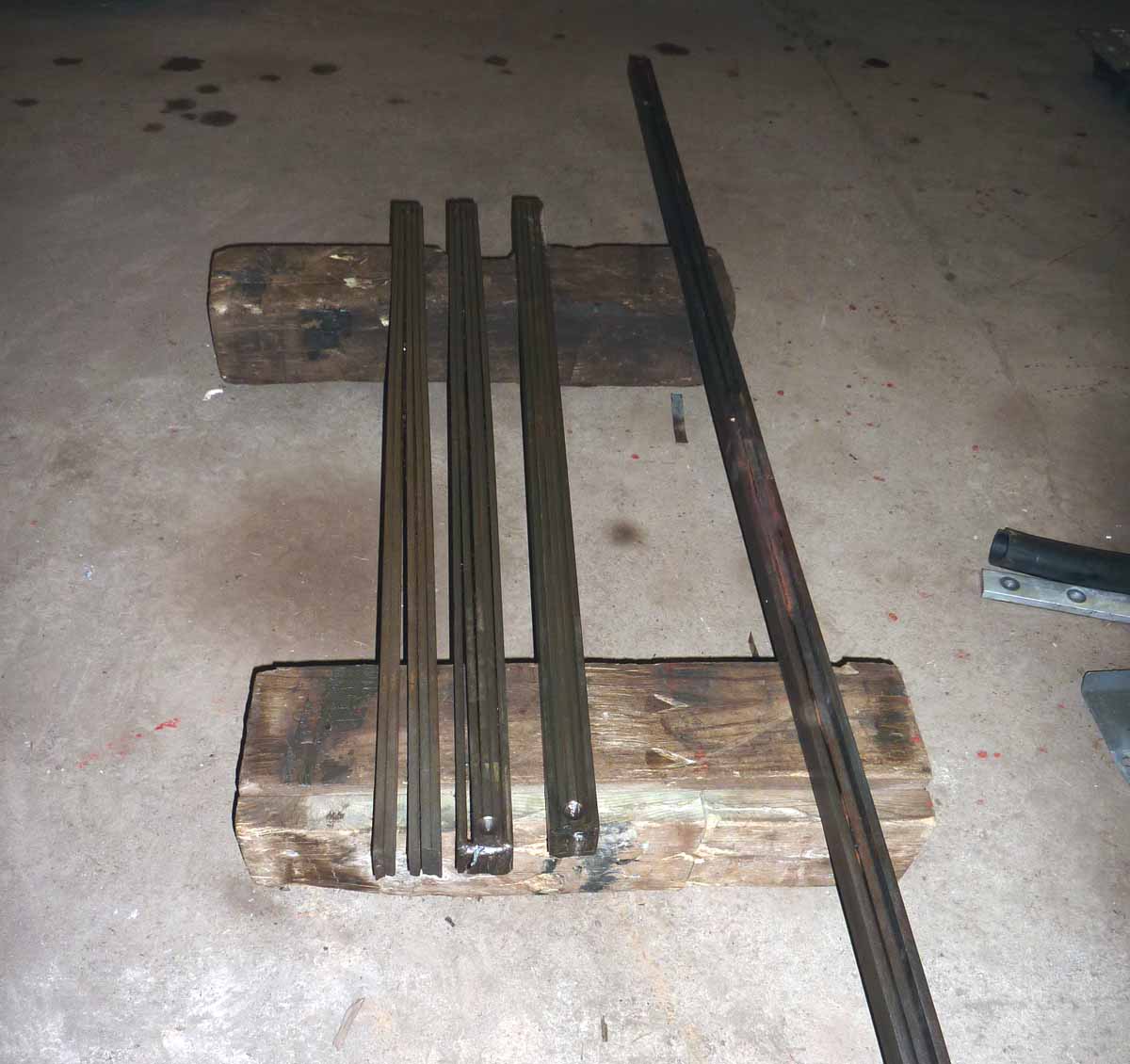

#30

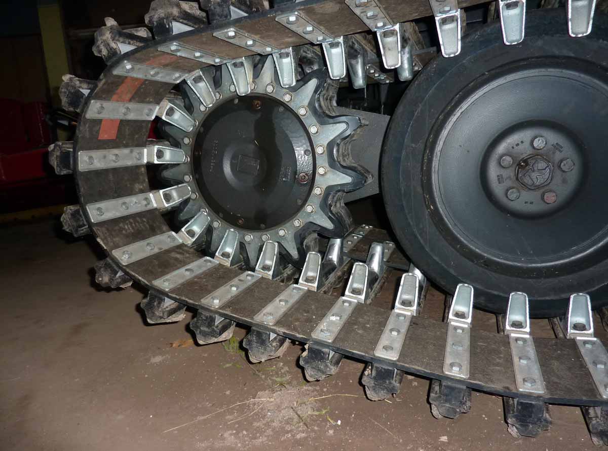

Here are photos of some of the suspension components. The 1st one is some of the torsion bars used in each machine. Do note, 2 of them go all the way across so they are longer. Next are 2 sets of driver cogs on machines that are in the shop today. Yes they are different. Then 2 idler arms and yes, they do break. :eek: Last one is a welder working on suspension breaks. Clear as mud??? :eek:
