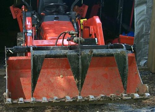

A while back I saw this one. I think it was made by a company called American Solutions, but I do not think they are around anymore. It looked like good setup.

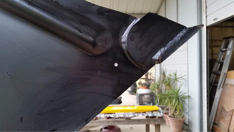

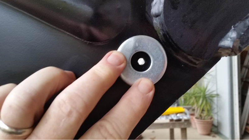

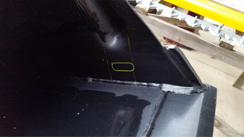

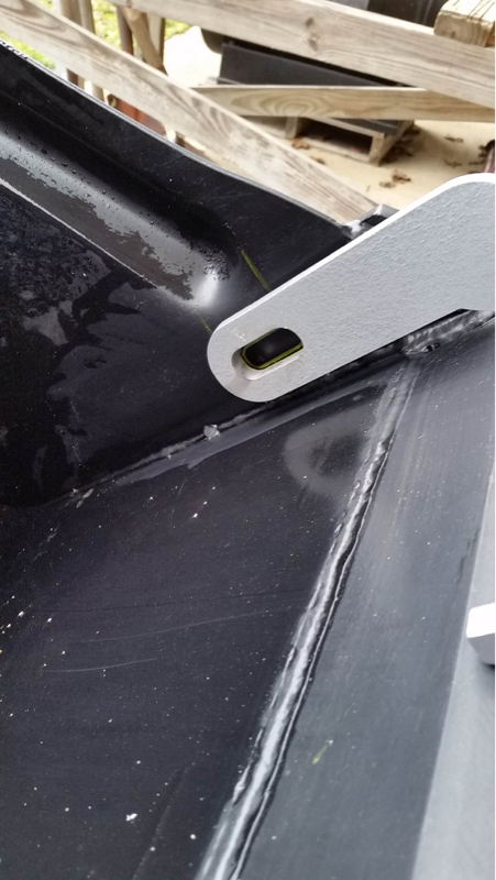

Started installation of my PTB today. Put the PTB in place on bucket, clamped, and marked location for holes for bolts;
Drilled the 3/16" pilot hole;
Check for clearance issues". None ..... Woo Hoo!
Ordered a new set of step drill bits, for the final 3/4" holes, which will arrive Tuesday. Will finish this next weekend and post results.
That looks doable. Two bolts on each side and a 2" square tube to hang it from. Some fab work cutting the parts out but its doable.

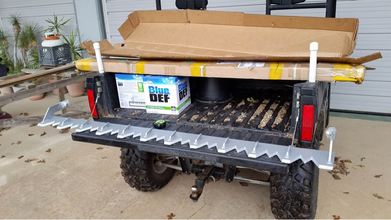

Mine came in today.
