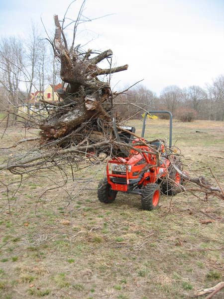

I agree with Dougster, you should try to center loads-- Not only because it is less likely to damage the FEL, but also because it is dangerous to drive with a heavy off center load. Things get "tippy" real fast with a heavy off centered load in the grapple.
That doesn't mean you cannot put one edge of the grapple under a tree root to pop it out but you should probably not do that with something that doesn't "give" pretty readily. I can see the FEL twist sometimes when one side of the grapple is stuck on a root and it doesn't do any more damage than doing the same thing with a toothbar on a bucket but it is not what the FEL is engineered for so it's best to minimize that sort of asymmetric loading.
With a big root ball sometimes you need to center the heavy part and just let the rest hang out the front of the grapple.
