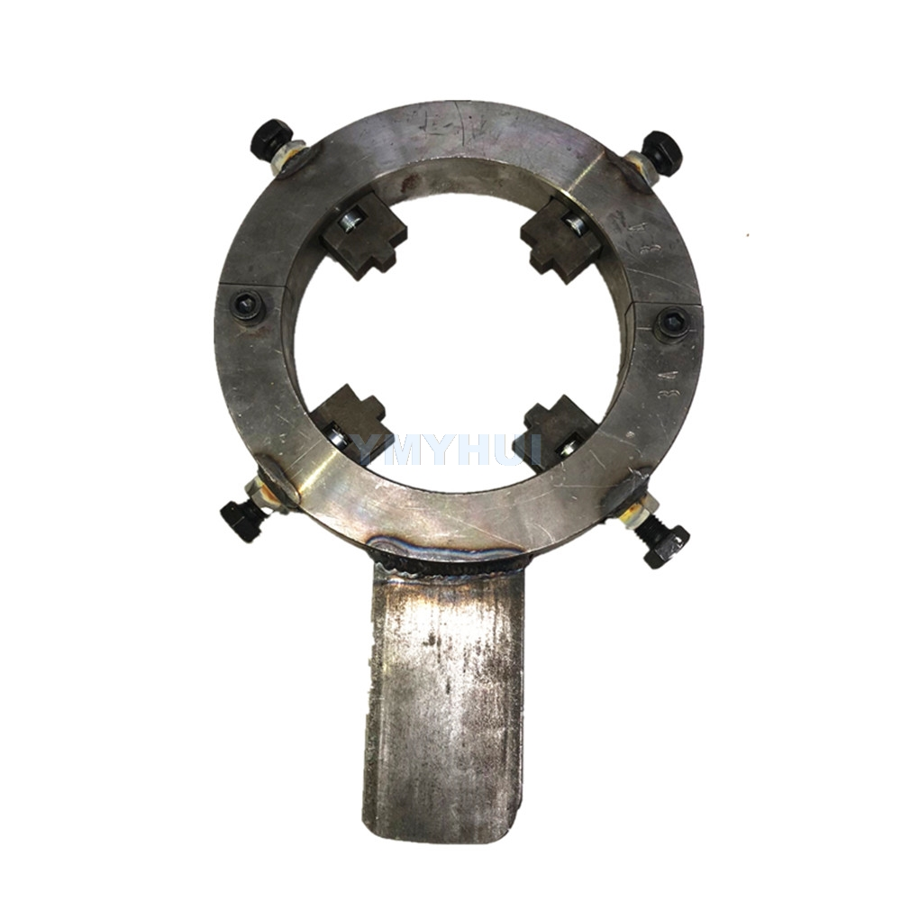

I have never had a powertrac so not sure what your cyl. caps look like but I use a cyl head wrench that my local hydro shop rents out basically just for deposit as I buy parts from them. I think they charged me a depost of $200 and gave it all back as I told them I would buy my parts from them and pizzas for the shop. They told me the Volvo cap. wrench is worth something like $300 new.
