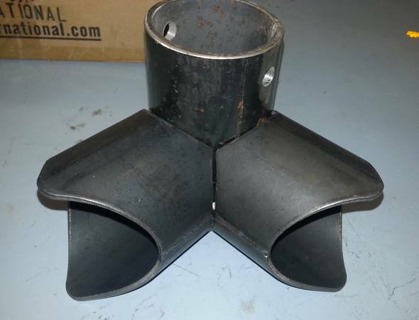

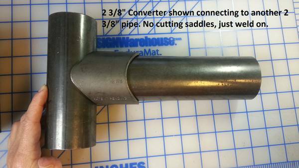

Pipe fence product
/ Pipe fence product
I'm sure they are not for everyone as some guys are really fast at cutting thier own saddles.
/ Pipe fence product #4
$5.50 EACH........Dont seem like a good price to me, but I'm not a fence builder either. And it doubles the amount of welding you have to do, and wont leave as clean of a look.

It certainly would save time cutting saddles, but it sure wouldn't look at nice. And at $5.50 each that's adding a LOT of cost to a fence.
/ Pipe fence product #7
Freehand cutting saddles takes a lot of practice to do it right. Buying a $20 jig at the welding shop makes it easy though. We welded up a whole semi load of pipe fence at my place and cutting the saddles was no problem. I would not buy these things they are not needed and for the price of four of them you could buy a jig and cut all you want. The extra time in cutting wouldn't be any worse than the double welding you would have to do and it would look nicer when finished.

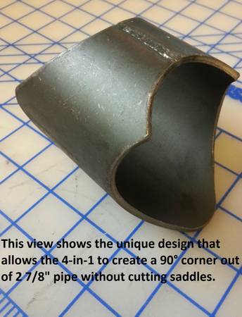

I would assume these are geared toward people that don’t understand how to cut saddles properly. Of course most folks building pipe fences should know, so the market for these has to be miniscule.

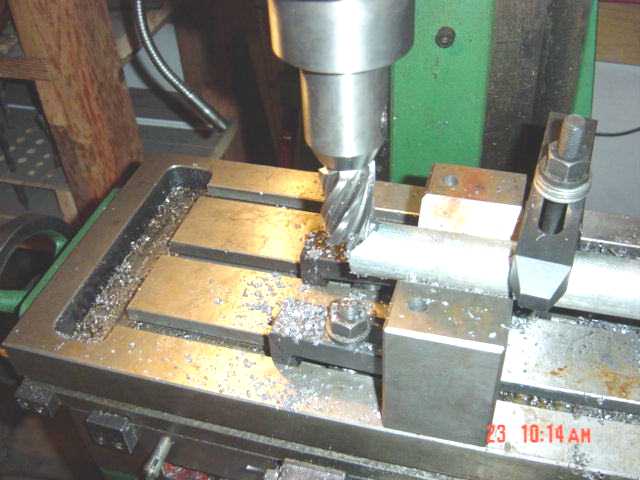

For the small stuff, I use a hole saw, or roto broach. For the big stuff, I use a wrap around, and torch.

I think they would look alot better and cleaner if the pieces were designed to fit INSIDE the pipe.
Basically weld the "stub" to the vertical post, the slip the horizontal piece OVER it, hiding most of it. Then weld that around.

That would run into a lot of money if one had a lot of multi-rail fencing to do. The fixtures that use a hole saw and drill press are good for dragsters or Super Cub fuselages where you need exact fitup of compound angles, but are time consuming. If you're hammering out miles of fence in a week you need something like this, we had a standalone air operated notcher. That is a spendy bit of kit for the non-professional, if you can't snag a bargain on craigslist or somewhere.
