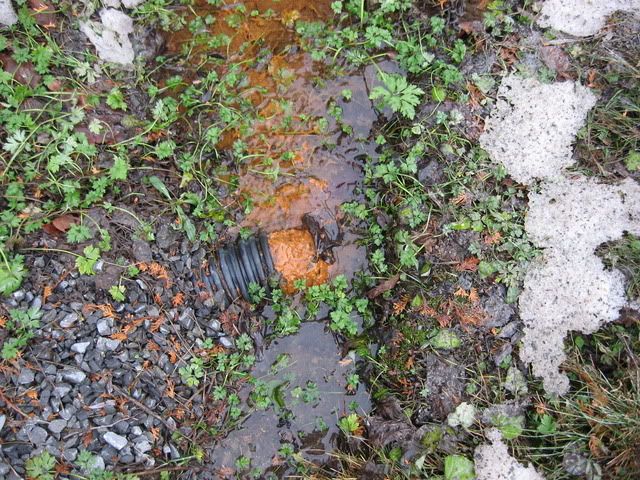

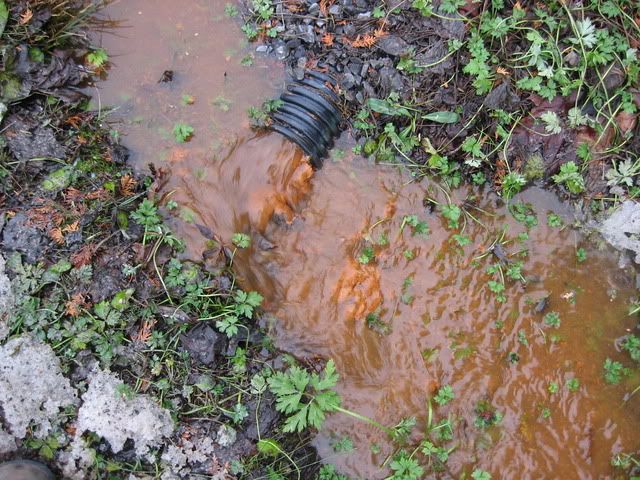

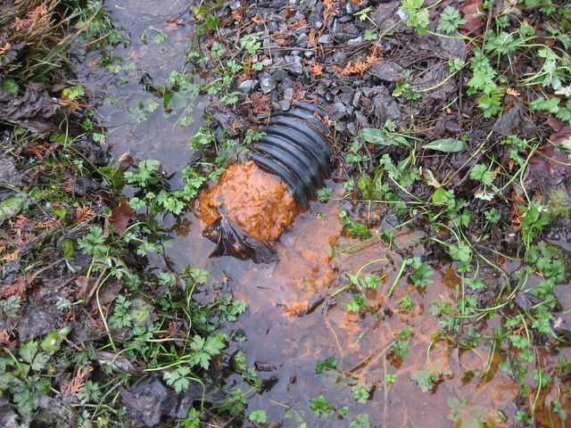

happened to look in the ditch by the road today, and I
see this gunk at the end of a drainage pipe that I
layed in last summer. I have noticed a bit of
the same colored stuff around that ditch, coming from wherever,
but this was the first time I ever saw it accumulate in
1 place. I took a small stick, and poked it around, it
had the consistency of thin peanut butter, and once
I moved enough of it, the tile started draining off,
as it had backed up a ways I'm sure.
any thoughts? is it an iron product coming from the ground??
oh, and a couple little frogs enjoyed the ride out of the
pipe with the water!
:confused:

/ Pipe buildup
this is an outlet for some drain tile that runs
about 125' up the property. Last summer I only replaced the
last 25' due to it being crushed and plugged
with tree roots. it runs pretty much all year,although
most of the time it's not running much.
i would say this occured in the past month , maybe 6 weeks,
as during mowing season I am more apt to look at the
pipe during trimming etc.
i'm sure it's coming out of the ground, as I have seen other
areas close by with the same coloration. but odd that
it accumulated at this point to the extend that it filled
that pipe for a ways.
my thoughts is it's an Iron concentration, or some other
form of decomposing organic material..... meow

/ Pipe buildup #14
That's funny but I think it is a big growth of fungus.
That's close,
I'm pretty sure I got this one. It's actually a bacteria called iron ochre and it wreaks havoc on drainage systems, and other ground water systems. I've read about it a couple years ago when trying to educate myself, we just thought it was like a silt, odd to find out "IT's ALIVE".
Guys who drill wells would know about it as they have to be careful there equipment is not contaminated with it going from one job to another.
We come across it in the basement drainage work we do, only a tiny percentage of jobs but we do see it occasionally. it will choke off a pumps discharge line to complete closure, and make footing drain pipes look just like the OP's pics. Don't think it poses a health risk but it is a big nuisance to say the least, has to be mechanically removed, I think bleach helps to prevent it.
We don't even bother trying to clean pipes with it if they can be easily replaced. once in under ground/slab pipes it's pretty much a permanent problem and requires frequent cleaning.
Not trying to scare OP as it sounds like it was just at the end of the pipe, if it was that thick all the way in then you'd have trouble, if it's just landscape drainage then not a big deal.
CIR671/AE026: Iron Ochre And Related Sludge Deposits In Subsurface Drain Lines
Google Image Result for http://www.basementsystems.com/images/iron-ochre.jpg

/ Pipe buildup
#16
that makes sense, as the area very close to where
this pipe terminates has had signs of the same stuff.
my bigger concern, is when this tile was crushed/closed
the driveway was always wet in that area, but up above, maybe
50', this same drain tile is only 10' or so away from my well.
this drain tile crosses above the ditch where the water line goes
from the well to the house, and i noticed the well was overflowing
with water for a while, which has stopped now that i replaced that
section of tile. while investigating some other water well issues, i
have dropped a nut on a string down the well only to find i had to use
a brass nut because a steel one would attract to the side of the well casing
like a magnet. the brass one would drop down to the bottom, about 45'
down. and, the well casing has this same coloration on the sides. we have hard water, and a new softener as of 2005, but this property has a lot of water running thru it, and this drain tile collects water at the base of a steep
grade going up to the higher neighbors property. rarely do we get standing water, but at the base of that hill, it's always soft ground. that entire pipe
is slated for replacement someday, along with a lateral along the base of
the slope.
so it's hard to say whether this iron is in my well, i have heard of
iron bacteria causing interior plumbing problems. or whether it's just
going to be more evident in the lower half of the property.
nothing inside the house shows that color, so i don't think it's a big
interior plumbing problem. the new hot water heater in 2007 started
smelling (rotten egg/sulfer) until my softener and tank supplier told me to remove the sacrificial
magnesium rod since i was softening the water reducing minerals in the water.
is this all somehow connected?????
:confused::confused::confused::confused::confused:
