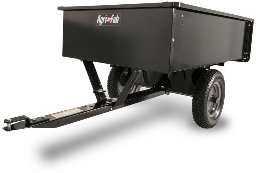

I think that pin/clevis hitch is what was intended, its not feasible to convert a garden cart to a ball hitch and with one of those adapters they can tow either.
Aaron Z

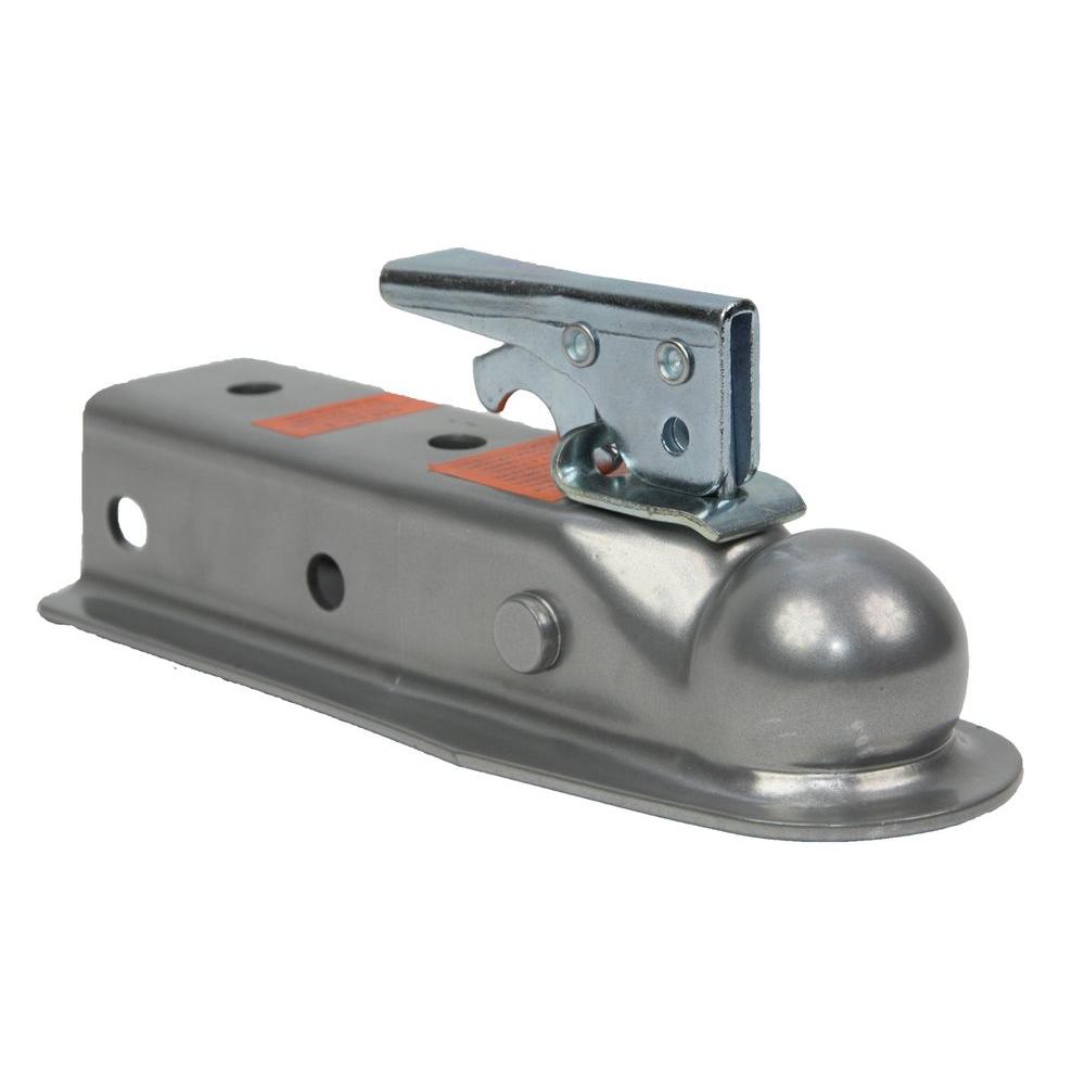

I've just unbolted the "pin hitch brackets" that come with garden trailers (and leaf sweeps, etc..) (like in photo) and bolted on a 2" ball coupler in its place. Sometimes the bolt holes align on the trailer tongue, other times I've had to drill one new hole.

Good point. Turned out, I didn't have any 2" square tubing on hand, so I went ahead and ordered the ATV Hitch Adapter.
The ball hitch feature fits my needs best since I have 5 trailers with ball hitches, and none with a pin hitch. ...not that I plan to pull any heavy duty trailer with my garden tractor, but it does allow me to use a couple of small trailers/carts.
