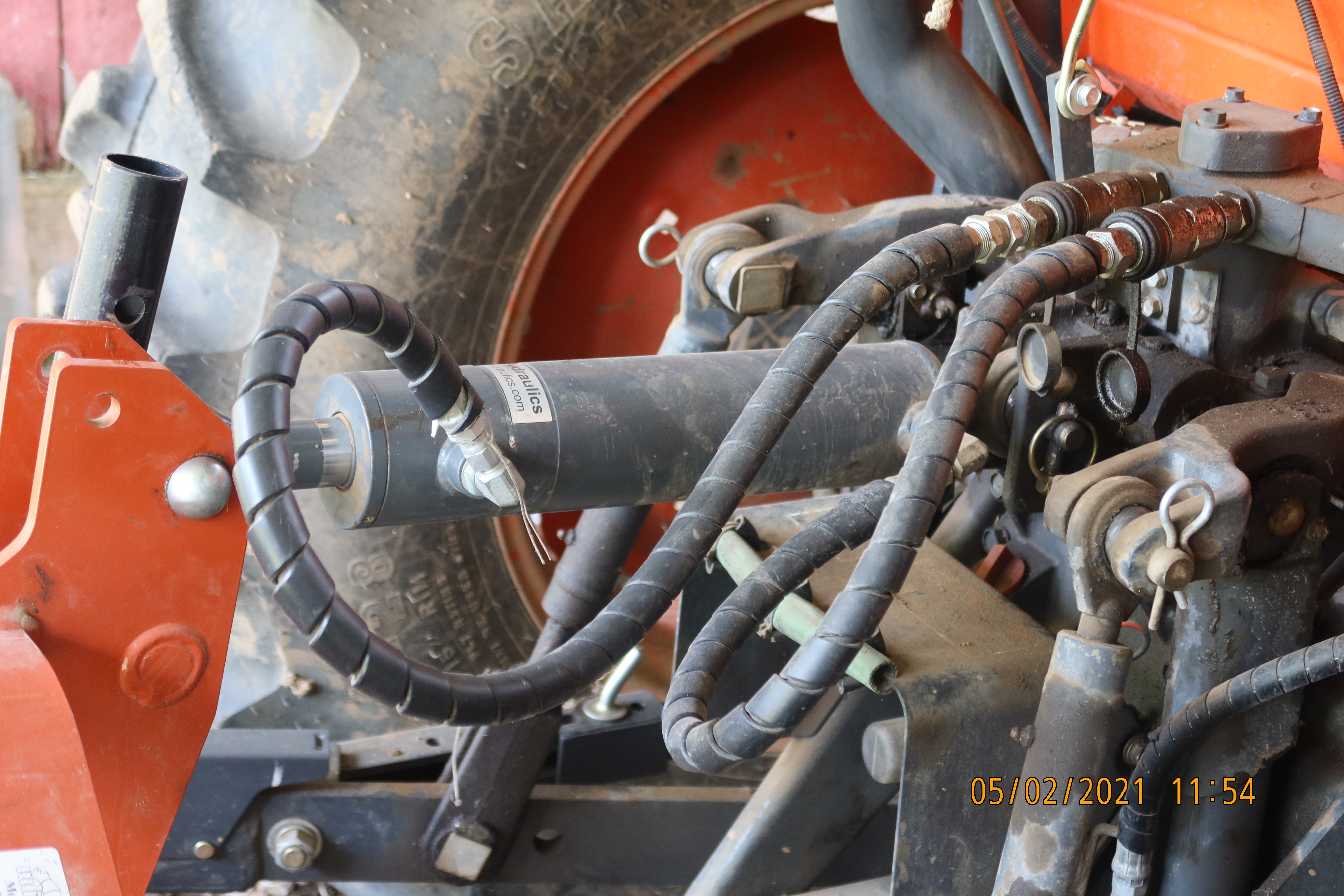

This is how I protect all my hydraulic hoses. On the 3-point and FEL. It's a heavy duty spiral wound nylon cover. It's a real bugger to get started but then it goes on pretty easy.
   / Pinhole leak in hydraulic line on backhoe. There a clamp or sleeve fix? #36
How do you plan to protect the inner liner from heat damage?
   / Pinhole leak in hydraulic line on backhoe. There a clamp or sleeve fix? #37
