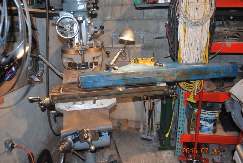

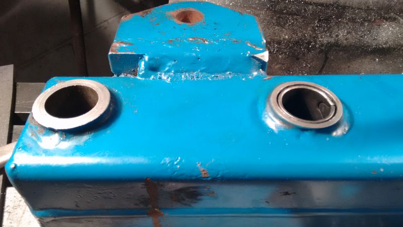

Some pics of the bushing holes being bored and the spring bushings installed. Holes were bored to 1.253 ... and true to the specs on the spring bushings, every thou over 1.250 leads to a thou extra clearance in the 1.00 ID. First one is fine, next one I'll try 1.251 to tighten it up a hair. Had to turn some of the square shank off the boring bar to reach in the hole far enough. It's only in the head about 60% as far as it should be, and it's reaching an 1" farther than it should, but seems to work well enough. No excessive chatter or anything.
Just compared the spring bushing from McMaster to the Woods part .... exactly the same, except newer, and cheaper from McMaster. Biggest pain about the job is getting the boom clamped straight on the mill.

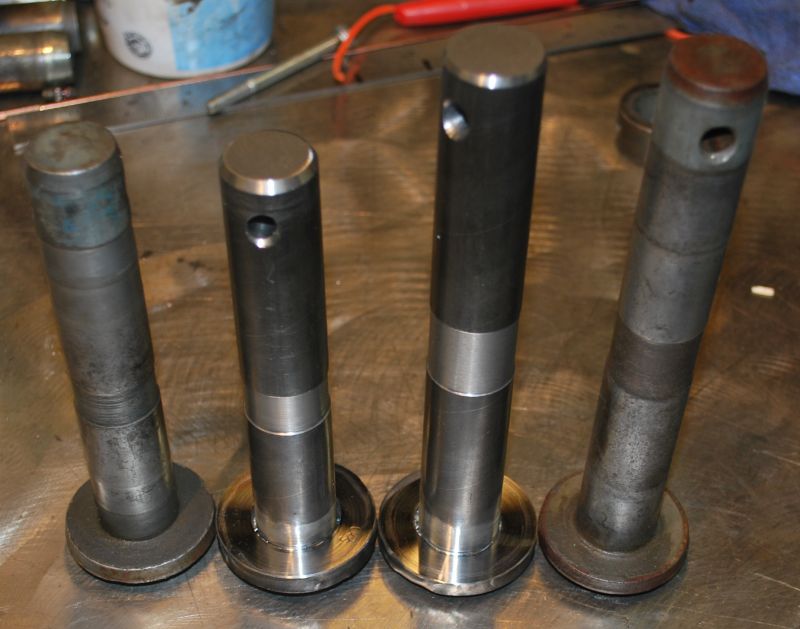

Some of the new pins made next to the old ones.
Main boom in the milling machine. Project is actually progressing with no major disasters yet (knock wood).

Job is now complete ... all in all, two new swivel (spherical bushings)s in the main boom, new pins on all pivot points, all pivots, including bucket, bored and new spring bushings installed. Made six of the pins, bought two, bought about a dozen bushings, the two spherical bushings and some small hardware .... total cost excluding the new boring bar I had to buy ... was about $300. Labor 10-12 hours, much of it was spent fixturing the booms in the mill, and doing the boring. I would suggest a 4" boring head and the largest boring bar that will fit in the hole because some of the holes are 5+ inches deep. Although a 3" head and a carbide insert with a small (sharp) radius seems to work too.
After assembly there is pretty much zero slop in the boom when full extended ... maybe 1/8" inch if you are very precise watching boom/tractor movement. Previously it was about 4" at the end of the boom. Overall it turned out better than I thought, and was slightly less of a PITA than I thought it would be. Broke one fitting during hose removal, $3 for a new one, found one missing swivel fitting $3. Replaced all the fluid and filter (don't use the Fram P1654A equivalent of a WIX 51553 as the Fram tries to bottom out on the filter housing ... it will work, but needs to be tightened too far).

As per usual I found the sweet spot for rpm, down feed and bar/insert right about the time I finished the job. Carbide can be strange ... sometimes when you get chatter seems the way to solve it is to go faster and higher feed rather than the reverse if using high speed steel. Unfortunately machining is just a small part of the work I do in the shop, so I haven't really accumulated the knowledge I should have to solve problems. Big issue on this job was a large radius corner insert would chatter, but the tip wouldn't break, the tight radius corner inserts would chatter way less, but they would chip, specially when boring past the zerk holes. And of course it was difficult to get a boom fixutred on the table as rigidly as it should be. Luckily the bushing holes didn't need a perfect finish, just an accurate size.
