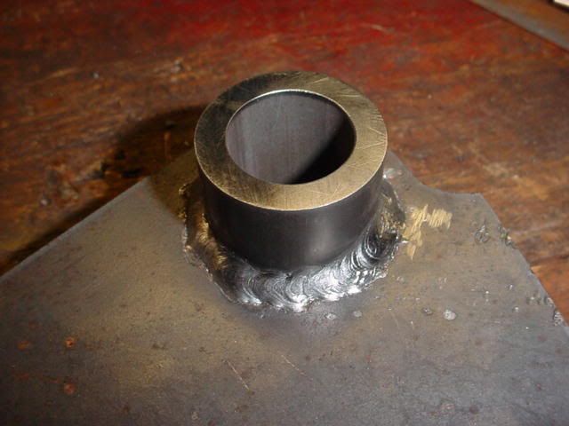

What I did for the many pivots on my CADDigger was buy the
1" ID DOM tubing and cut bushings. I welded them into the holes
in the steel plates then used a 1.000" hand reamer to
get each bushing pair into alignment for the 63/64" pins. There
would always be some tiny mis-alignment due to heat distortion
of the steel. The hand reamer was about $30 and
had 6" flutes. Heat management in these kinds of welds is very
important!
For the pivots in the rectangular tubing, one chunk of DOM tubing
went all the way thru, so it was much easier. No reaming necessary
here as the clearance with a 63/64" rod was about perfect. If you
use 1" pins and 1" ID DOM, you would need a 1 1/64" reamer, or
sand it out as described. Or you could sand your pins down. If the
1" bolts are a little less than 1" OD, that would work, too.

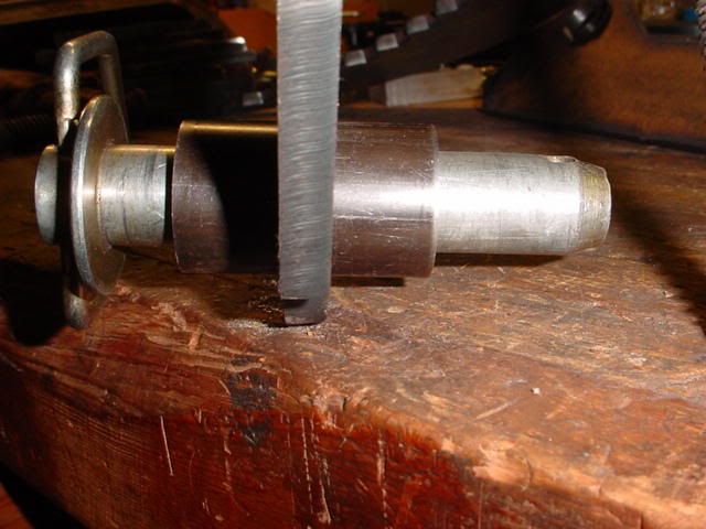

DOM = Drawn Over Mandrel (Seamless Tubing) I hope you don't mind that I posted some pictures for you to take a look at. It's not cheap, of course nowadays what is? DOM is what I used on my grapple jaw bushings. 1" ID x 1/4" wall I used 1" hitch pins (0.997") OD the pins fit no problem, If you can't get the pins to slip into the DOM you can use a 99 cent H/F break cylinder hone on the ID of the DOM to get a nice slip fit.
DOM:.......................... 1" Pin FITS.................Welded in Place........... Jaw Brackets:

Great pix and clarification of DOM tubing, Larry. I have not used 1" hitch
pins before, and the fact that they are undersized makes them an
excellent choice here.
I see in your last photo that you have some 1/2" plate with a pivot. You
may have already thought of this, but even 1/2" plate will bend easily
if not braced every 4-5 inches or so in grapple or thumb applications. You
don't want your grapple to twist.
