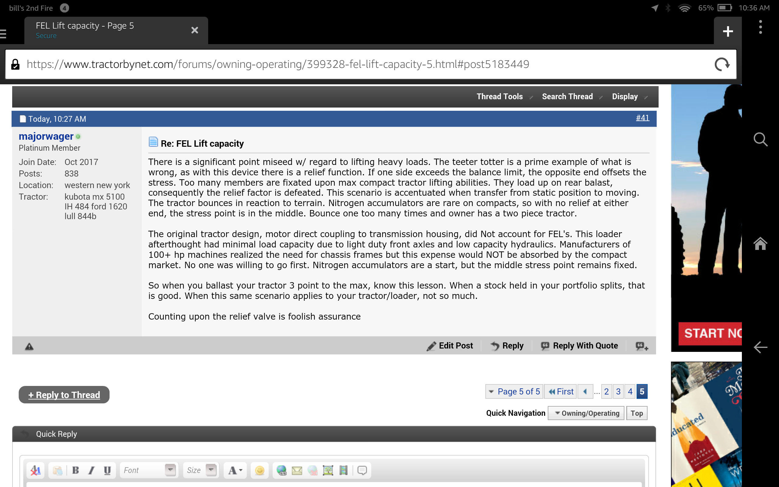

Please see screenshot below................................................................................
Michael, you could Not see it because it was not visible, Sorry, this posting became a two step process.
As for another question, not everyone advertises stupidity. By this I mean if an operator damages their tractor by overloading capacity, Not likely to boast the fact on a tractor forum. That isn't a typical "how do I fix this" question., answer is usually rather evident. Wonderful point about choice, is freedom to ignore thread/post.

Likely a clarification necessary. Point attempted, is thus. With tractor in motion, and loader capacity at full or approacing full, the counterbalance of rear ballast places the stress point at the loader bracket location
The underlying suggestion is that travel at full capacity of loader does not provide any means for relief of those stress forces. Also quite aptly suggested is the choice to ignore the post. However, by not over ballesting the rear, that gives an indication when too much stress is exerted and modification of the load is advised. Two safe trips are more advisable than one w/ questionable stability.
The remark that front axle damage occurs, reinforces that sole faith in relief valve is foolish.
And simply because someone has over ballested the rear capacity, it is No Guarantee that the teeter totter effect could occur in travelling over general terrain. At that point, hastily dropping the loader load may not occur quickly enough to aviod an issue.
