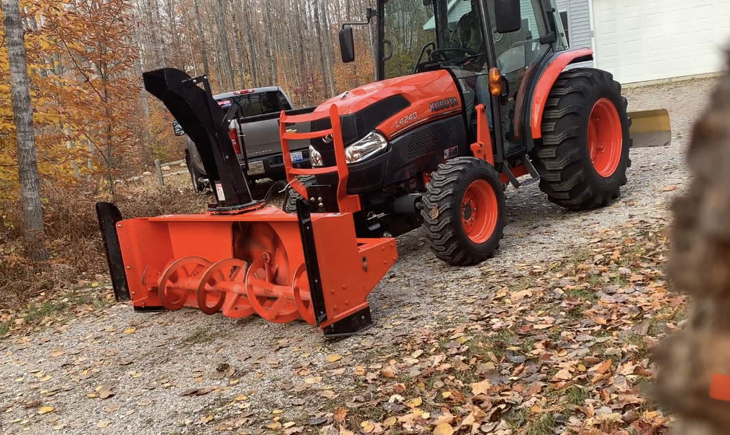

Found a used front blower for my L4240HST-3. Installed the mid pto and went through the blower. Ended up rebuilding the lift cylinder, changed gearboxes X 2 fluids, greased adjusted and tested. Waiting for my first snow!
That is a sweet set up, you will clearing the snow with comfort and ease. Call me jealous.
   / Pictures of your snow weapons #5,592
I'd love to have a front blower!! Unfortunately, my tractor doesn't have a mid-PTO and I don't think one can be retro-fitted at the local dealer.
Very nice job getting that front blower set up!!!
   / Pictures of your snow weapons #5,593
Will you share how much? L2195?
I paid $2750 and had to drive from MI to CO.
This I will share, I priced a new with mid pto and it was $7800 plus tax. Minus mid pto $400 equals $7400 Plus tax. He was asking $4200 and I believe 1/2 price of new was fair. I paid less than half but more than you but he was 2 hours south of me with the exact same tractor model and tires. He had to pay a mobile mechanic to remove the 5th hose for chute motor (some models dont use the 5th hose) as he wasnt mechanically inclined.
Did you disconnect your lift cylinder before hauling? If it wasnt connected to your tractor the pressure from bouncing up and down at pivot may have caused hydraulic shock and affected the seals. I had to rebuild mine because of the shock and manual states to disconnect pins for transportation. (Read after I got it home)
On orangetractortalks I posted a thread on rebuilding and the tool I made to disassemble. The original hydraulic seal was an oring but replacement was a lip seal.
Messicks has kit for rebuild $35.
Regards
I suppose the same (travel bouncing) can be said for any cylinder. I did not rebuild mine. It does drift down, over the course of a day or two. Certainly not worth rebuilding to me...... I hauled it on a trailer, and the lift "tongue" (part that goes up and down, looks like a huge tongue) was on the deck of the trailer. Don't see how that could have been an issue. It's interesting though...
I too, had to get a mid-pto for $400-ish. I quoted a new one at like $8200 (but that would have been with the PTO). Pretty spendy. I kept track of what the trip cost me (gas was huge, hotels, food) and it was $1200, almost exactly. So, really, we're not even that far off. Mine was..........I dunno, 5 years ago. Dunno if that helps or hurts.
5th hose? I have 4.
My seller was not mechanical either. He bought it new, and literally never used it. he let me take the brackets off his tractor. The way that went down, I had to leave too-long bolts in his tractor (showing/telling him, so his dealer could come out and fix them) and then I had to buy longer bolts than my tractor had. I forget which brackets that was for (thinking the middle ones), but it was a little extra pain. If I'd have known, I could have pulled my bolts to give to him and kept his bolts. aah well.
All things considered, it's amazing it worked out. we built a trust with each other. To the point that I drove 13+ hours from home and that he let me "wrench" on his tractor. Heck, he wasn't even home when we (I brought a buddy with) started. Cool guy. Everyone was happy.
The tongue pivot point is where the cylinder raises and lowers the snowblower. So when trailering if you leave the cylinder pins in every time you hit a bump it pivots causing the cylinder ram to move and the hydraulic fluid has nowhere to go causing hydraulic shock. If it is not leaking fluid I wouldnt worry about it.
5th hose? I have 4. Some hydraulic chute motors have relief built in but they cost more others use a 5th hose (5 hydraulic hoses) for a relief which connects to the HST drain plug.
Sounds like a great time and a good deal considering it wasnt used hardly at all. There was one on ebay but it was installed but never used and it was $8400. I called the guy and he was a broker dealer selling for the owner. I made an offer but he refused. It was kinda funny as he was selling more than the cost for brand new..
