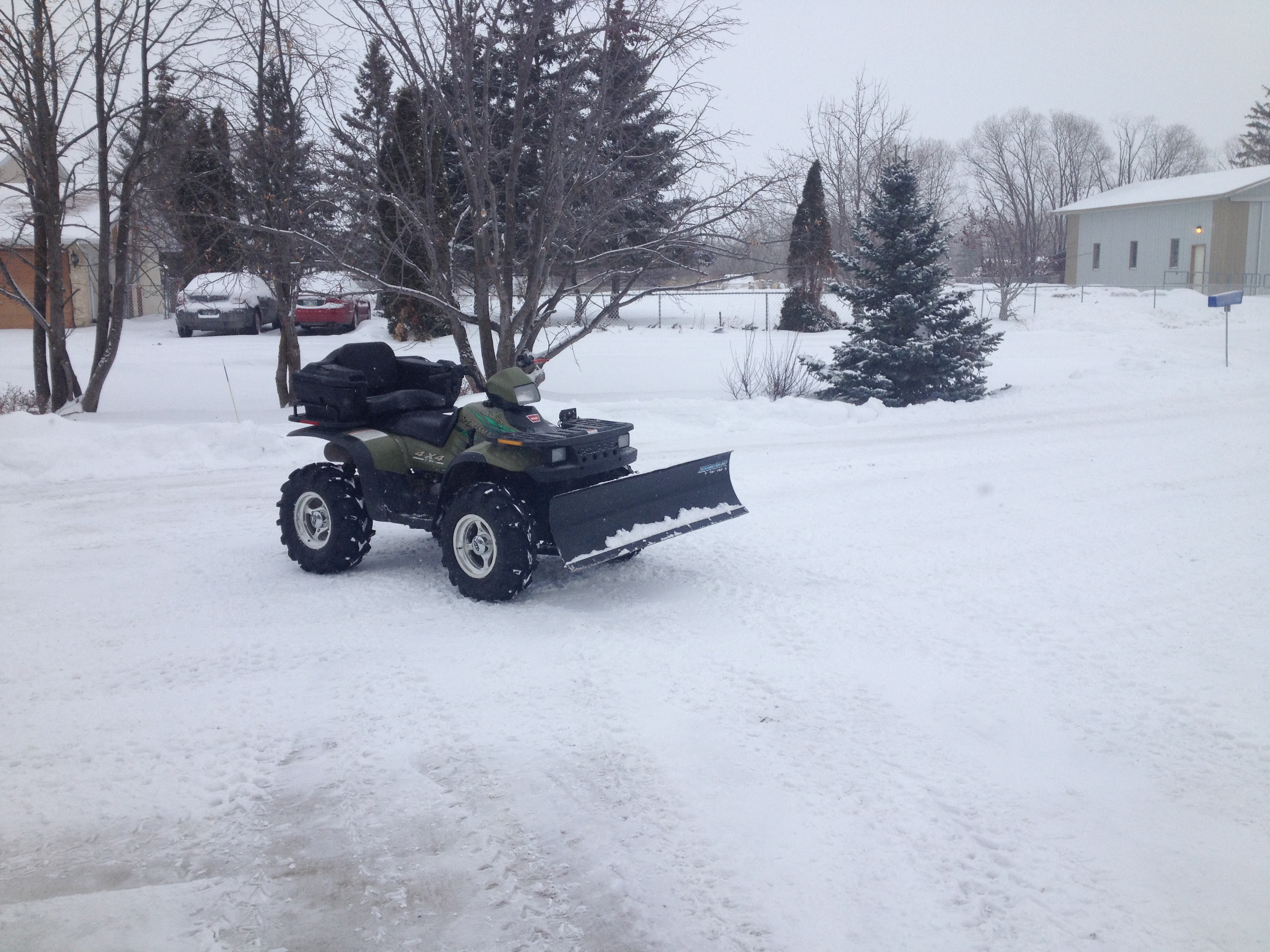

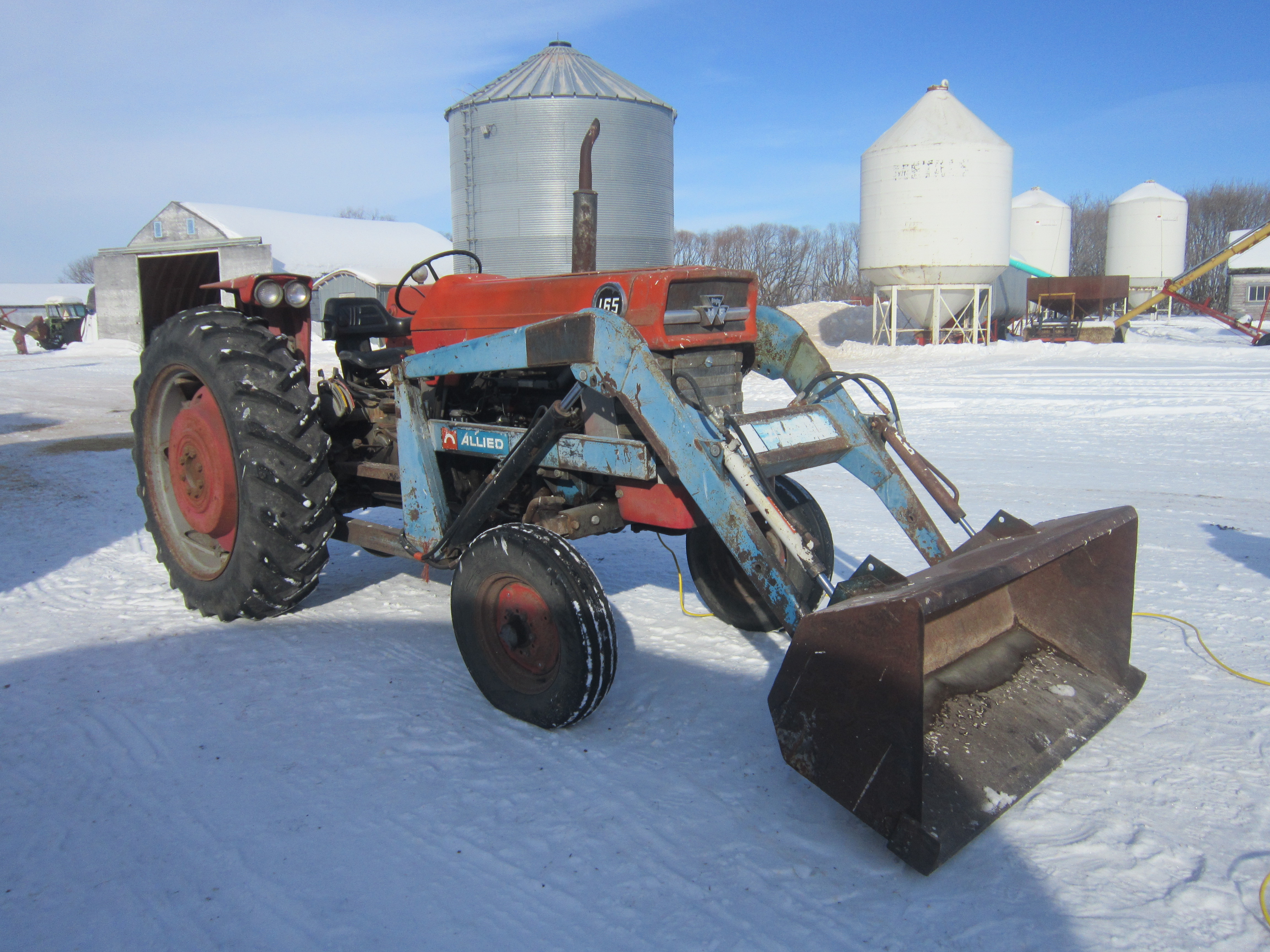

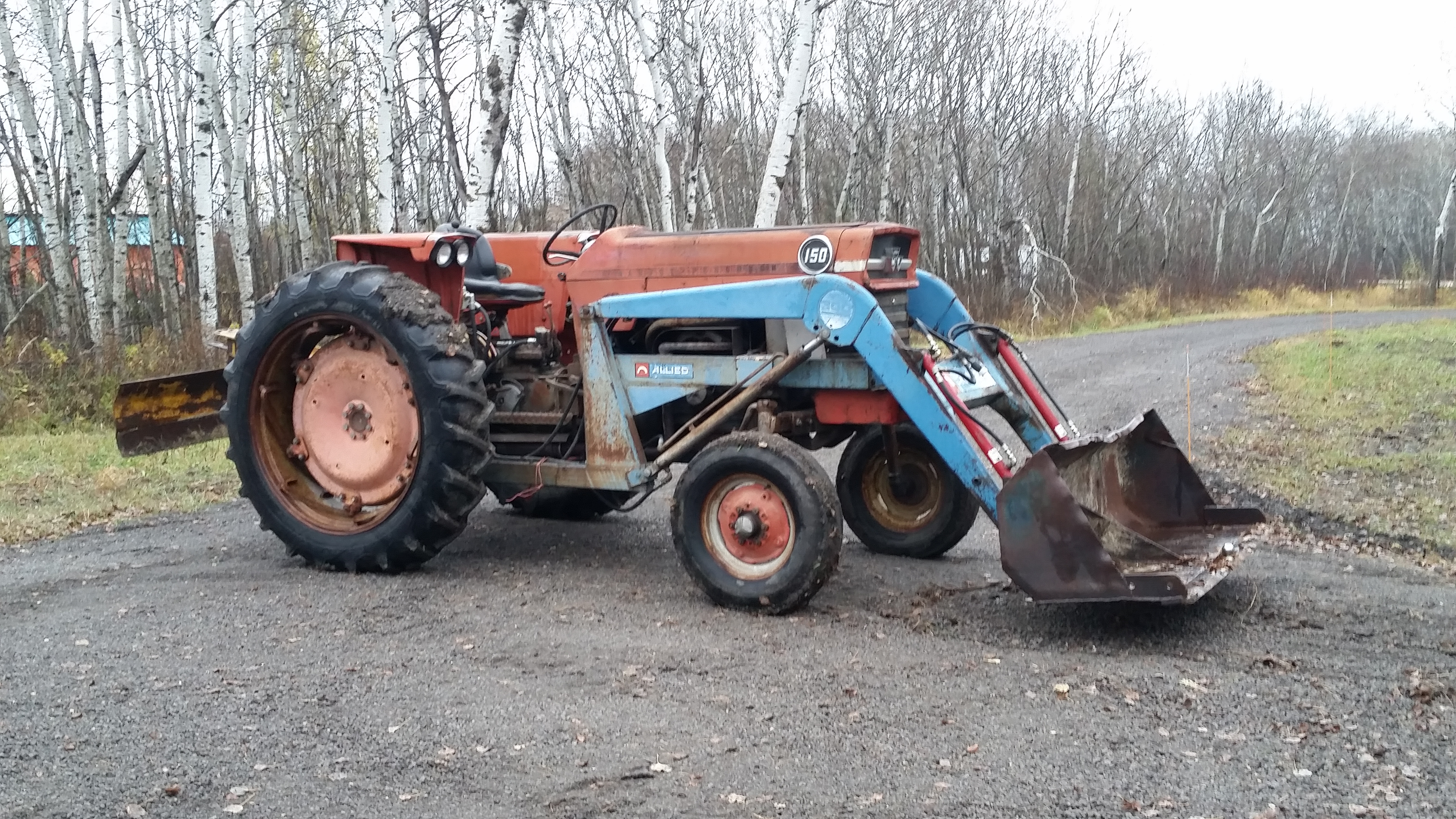

My primary is the quad. 1996 sportsman with 60" plow. Handles 90 percent of the snowfalls. If it gets too deep or if banks need to be pushed I use my 1964 Massey Ferguson 150 with snow bucket and 6 ft rear blade.

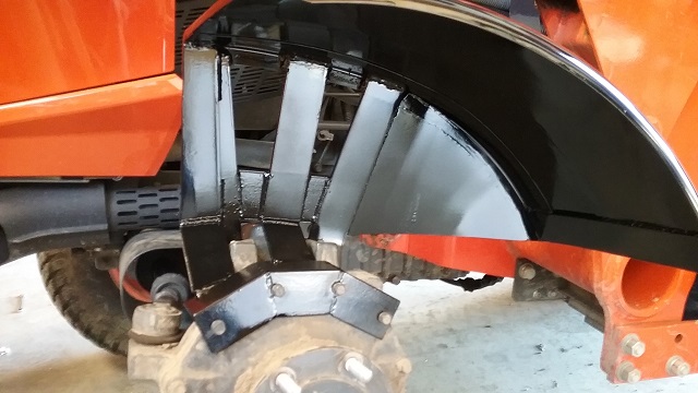

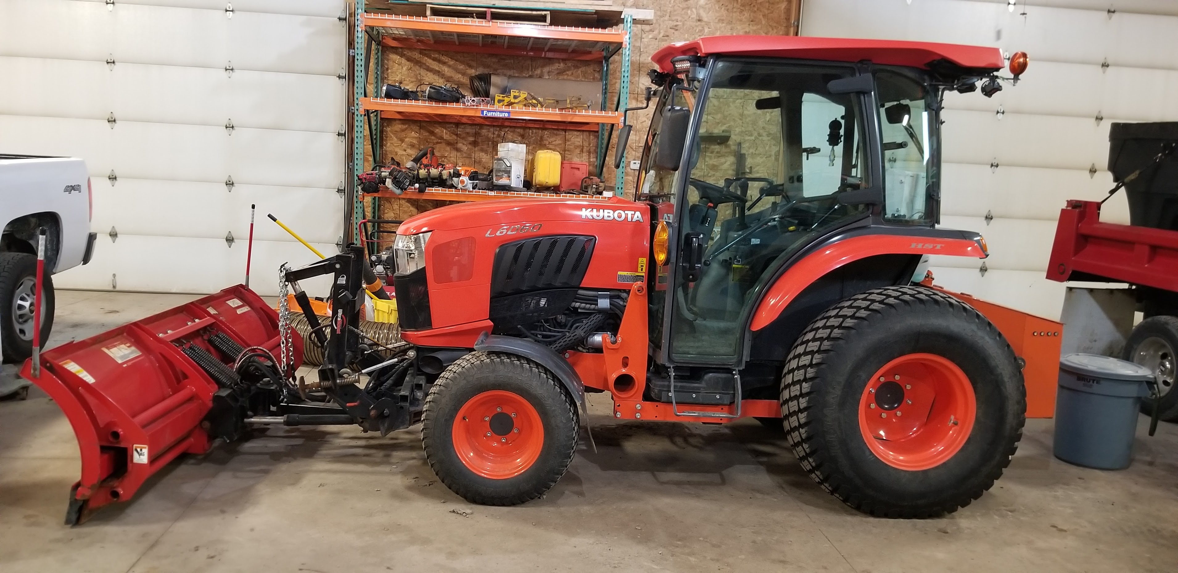

I have read as much as I could about how everyone has mounted plows on tractors. I took from that what I could and decided to do a frame mount Fisher MM1 plow on my Kubota L3200. I found a plow for $400.00. I have $400.00 dollars in steel and related materials. I have $150.00 in hydraulic hoses and quick connectors. So for just under $1000.00 and about 12 hours labor I came up with what you see in the pictures. The plow is 7.5 foot. Up/Down Left/Right run off the tractor joy stick. Unfortunately the up/down is on the curl / dump and the left/right is on the up/down due to the Regen feature of Kubota. Thanks to the members who helped me figure out the hydraulics. Now I just need to sand blast and paint, getting a little late may not happen till spring.
