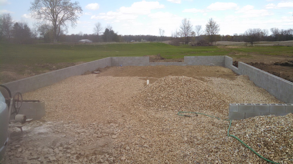

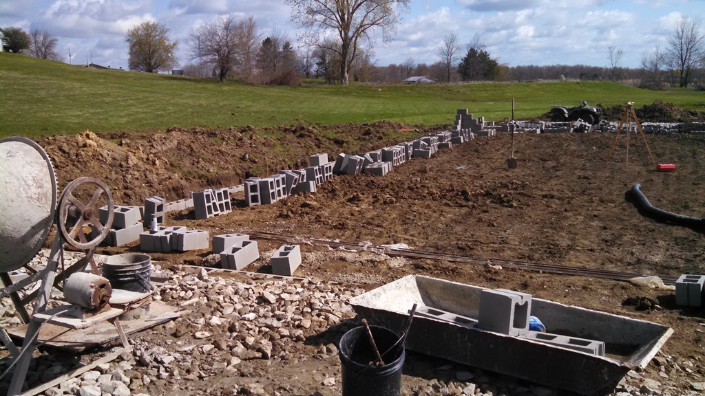

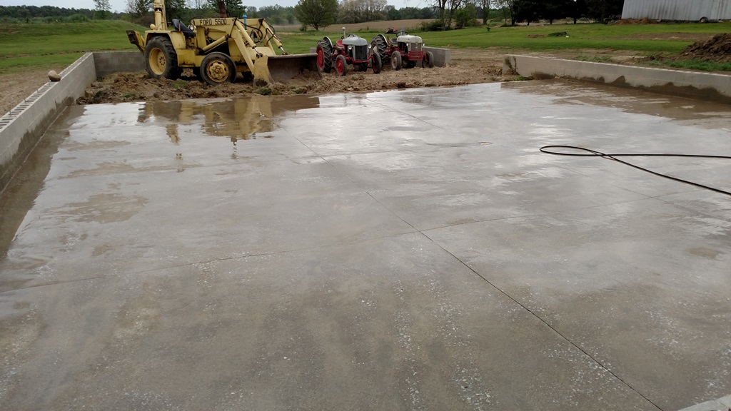

Here is the foundation:
And The concrete for the first 40'. Dodnt turn out great as there was unexpected downpours while trying to finish. Had to rent a grinder :mur: but turned out okay in the end

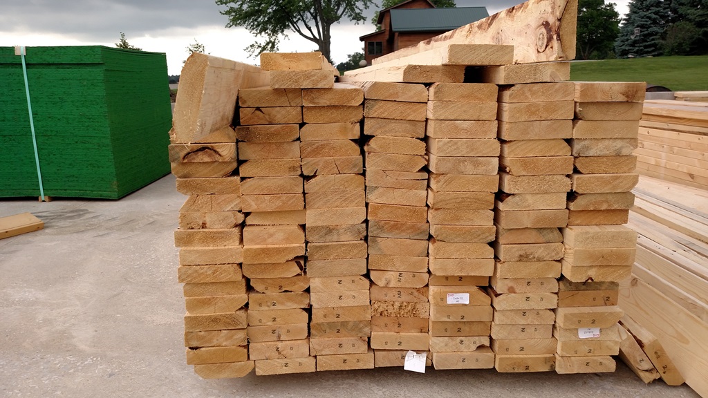

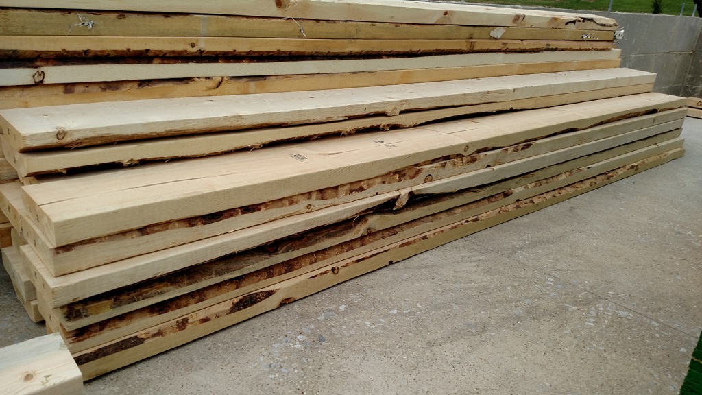

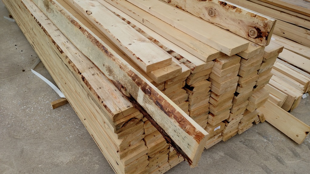

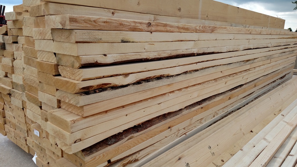

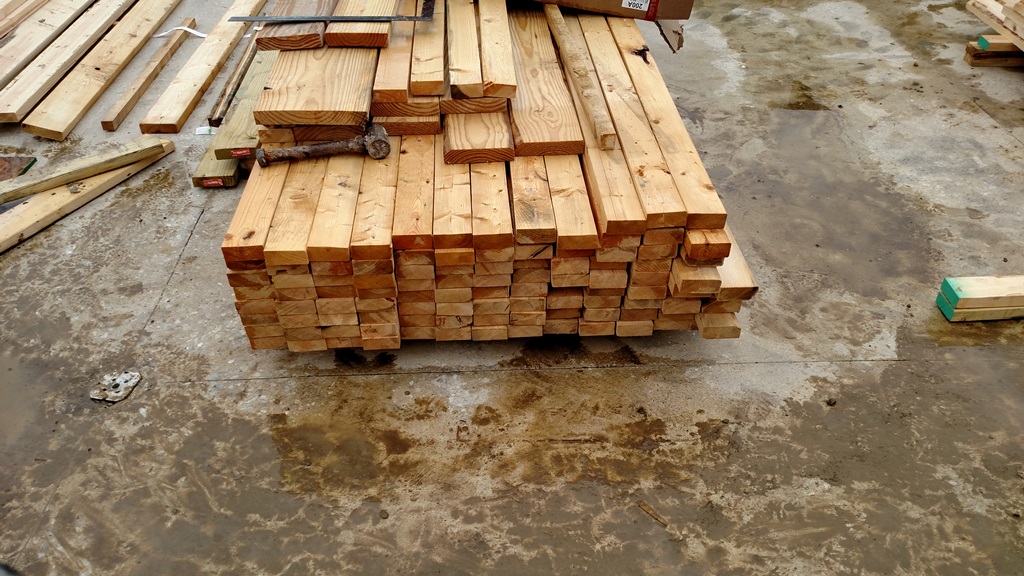

Lumber delivery. This is the crap 84 lumber thinks you can build with :mur:
IMG_20150530_095410897.jpgIMG_20150530_095432783.jpgIMG_20150530_095510496.jpgIMG_20150530_095709370.jpgIMG_20150601_162326466.jpg
So I made them take quite a bit back. Was anxious to get started, as it was a wet spring and I was already further behind than I wanted. So I sorted through and used the better boards so I didnt get set back another week or two. Otherwise I would have made them take back ALL of it.
Stopped by carter lumber on my way home from work to get what I rejected

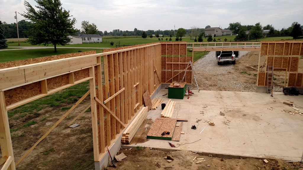

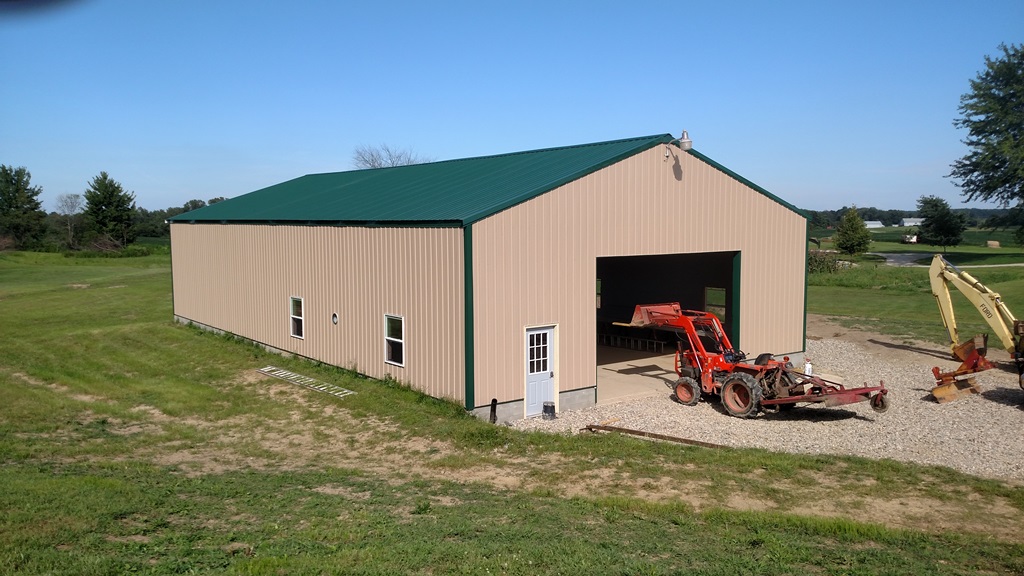

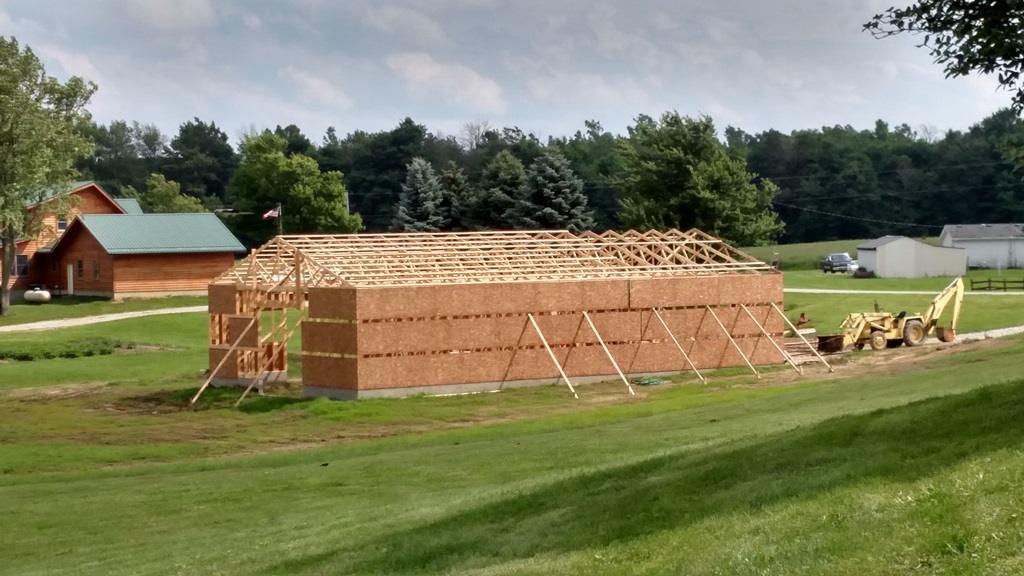

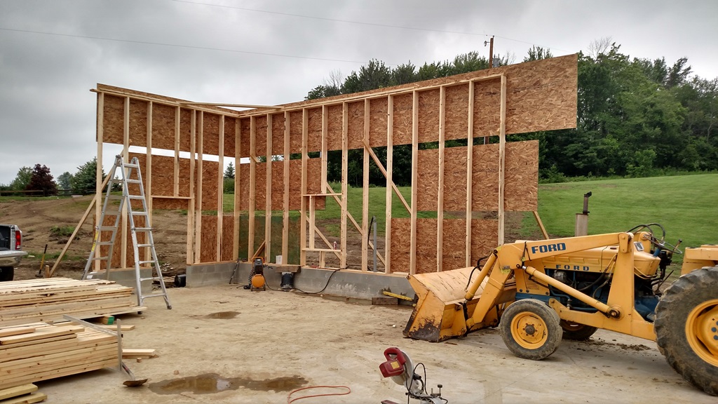

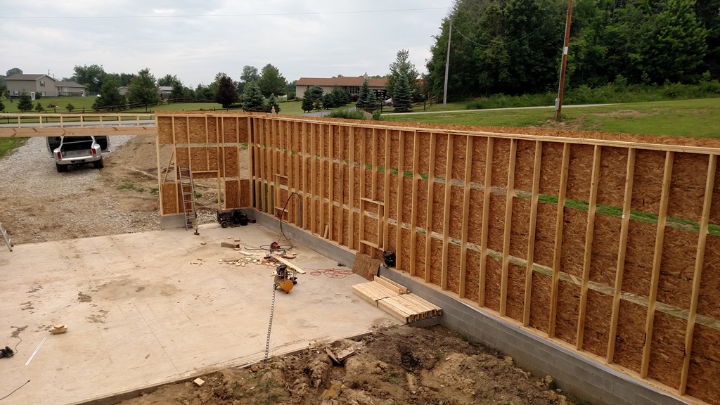

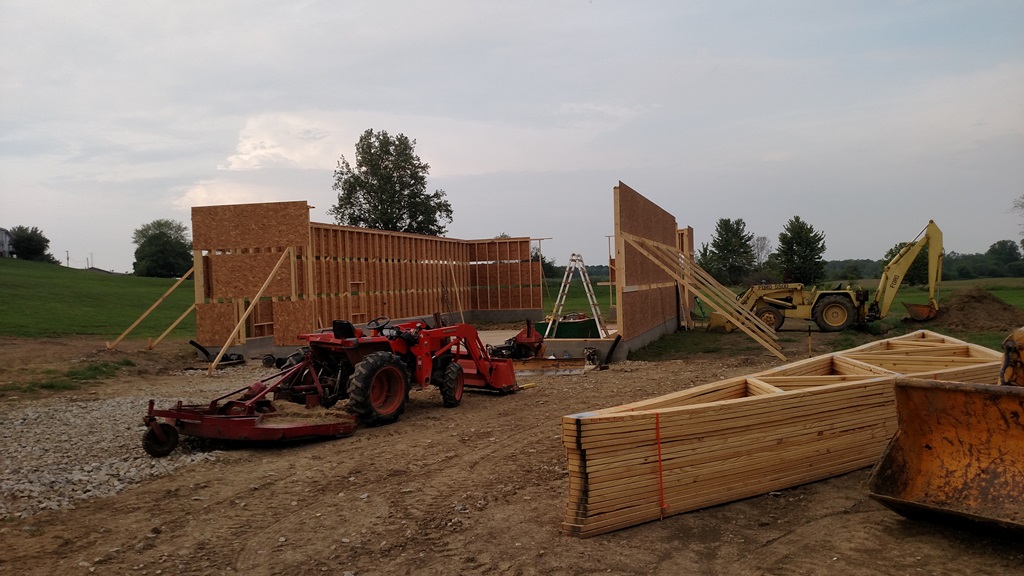

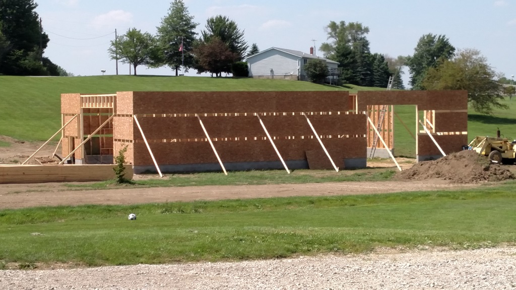

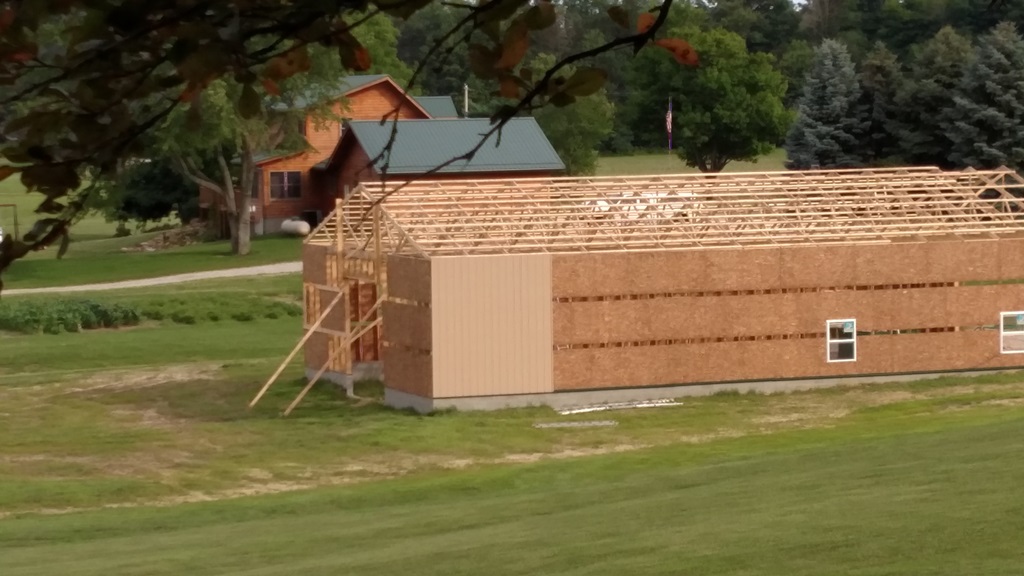

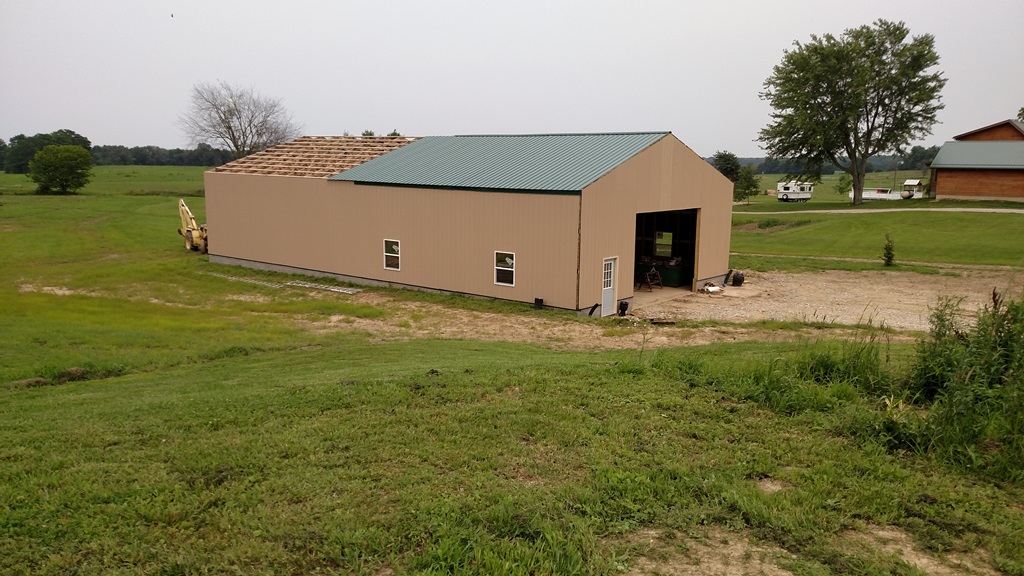

Built the walls on the concrete, then set them with the tractor. That was one of the reasons I wanted the floor poured first. Second reason was a 40x40 slab with a 12' high door......I wasnt pulling concrete to the back.
Truss delivery. Yep, Im behind...
   / Pictures of my Garage Build

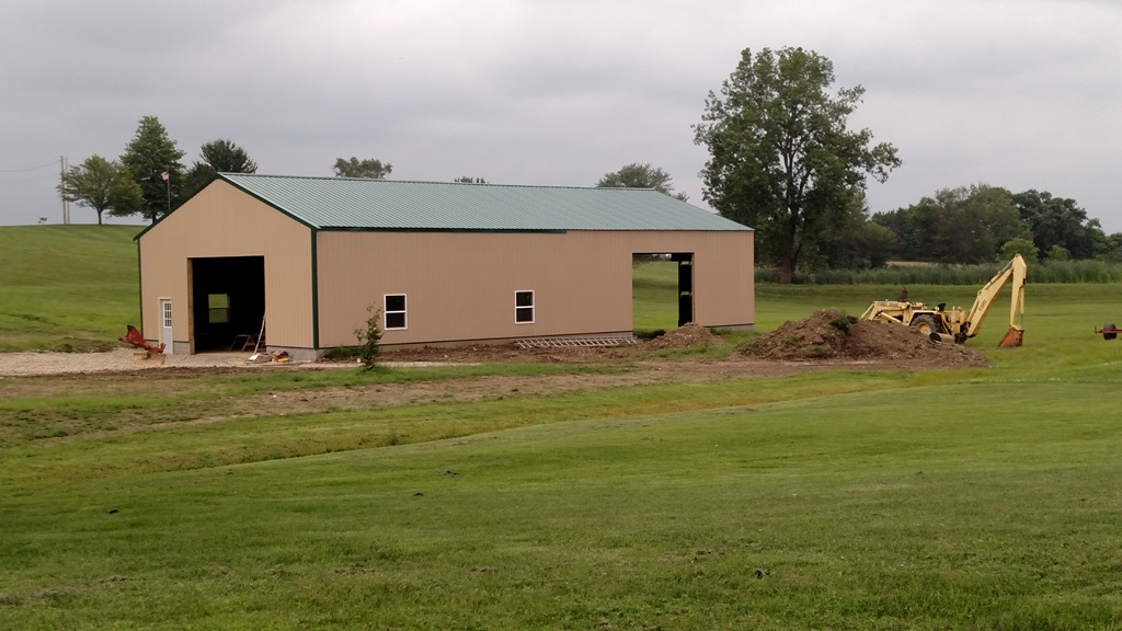

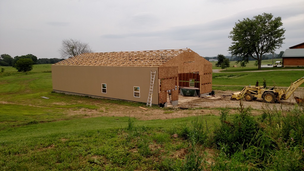

Walls done:thumbsup:

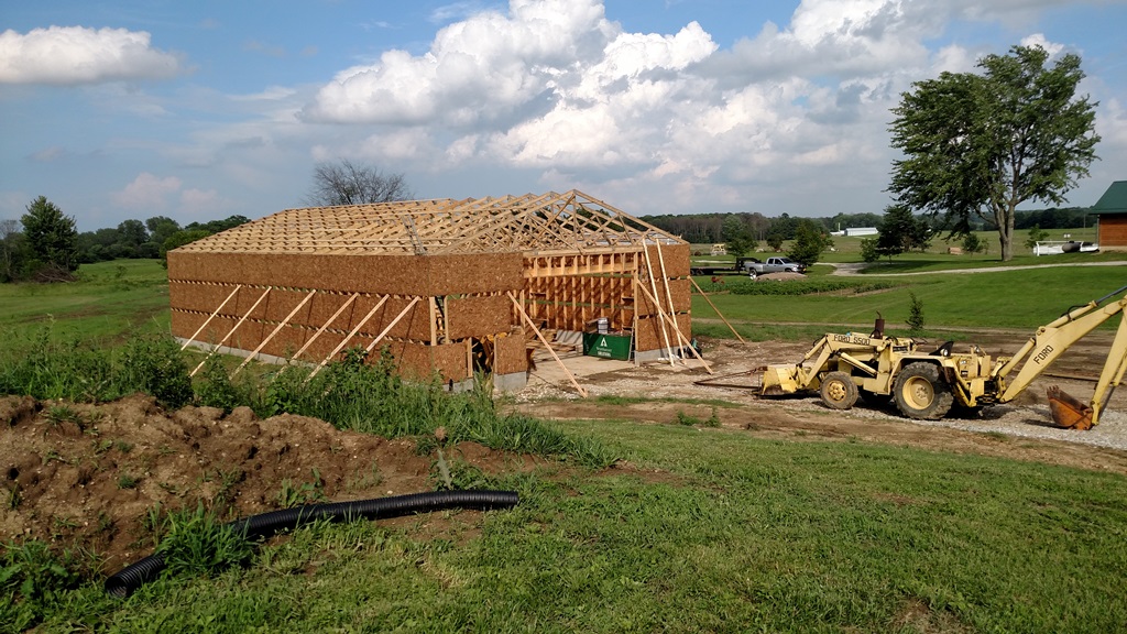

trusses are always fun

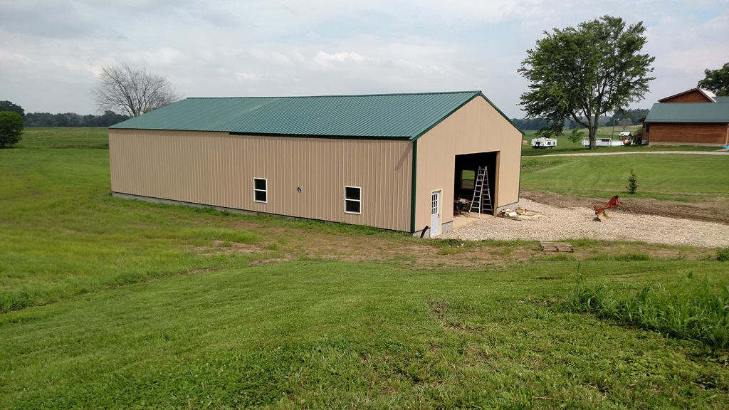

So is metal siding
And roofing is even funner.....wow that must actually be a word as the red squiggly didnt show up under it:laughing:

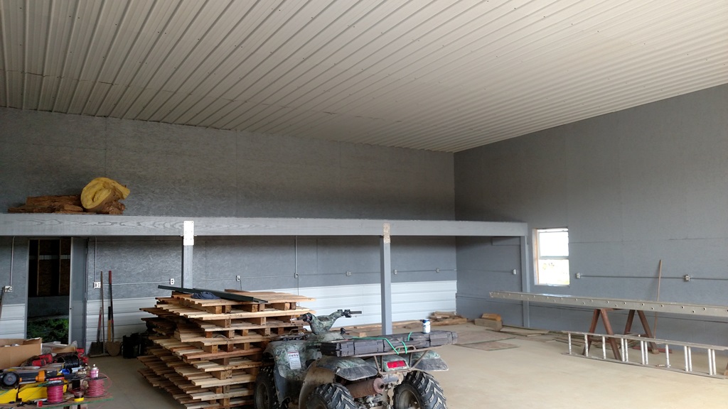

Now we start in the interior:

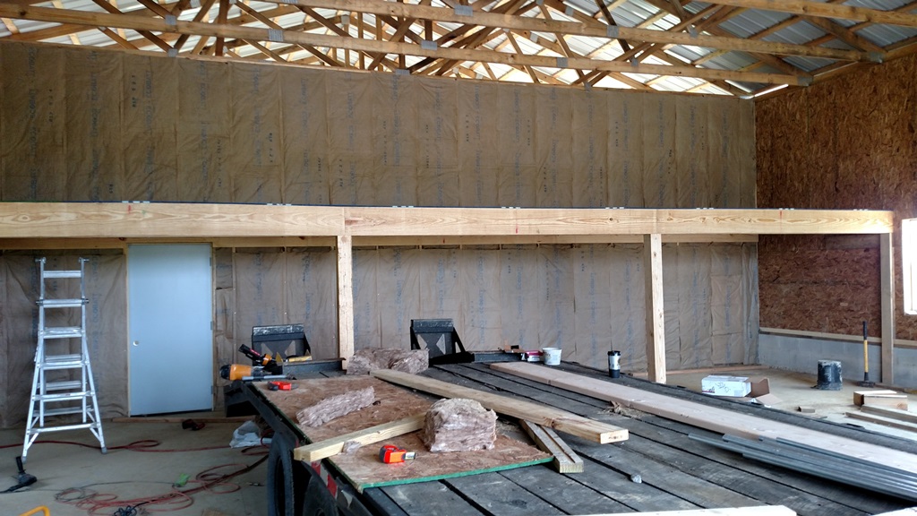

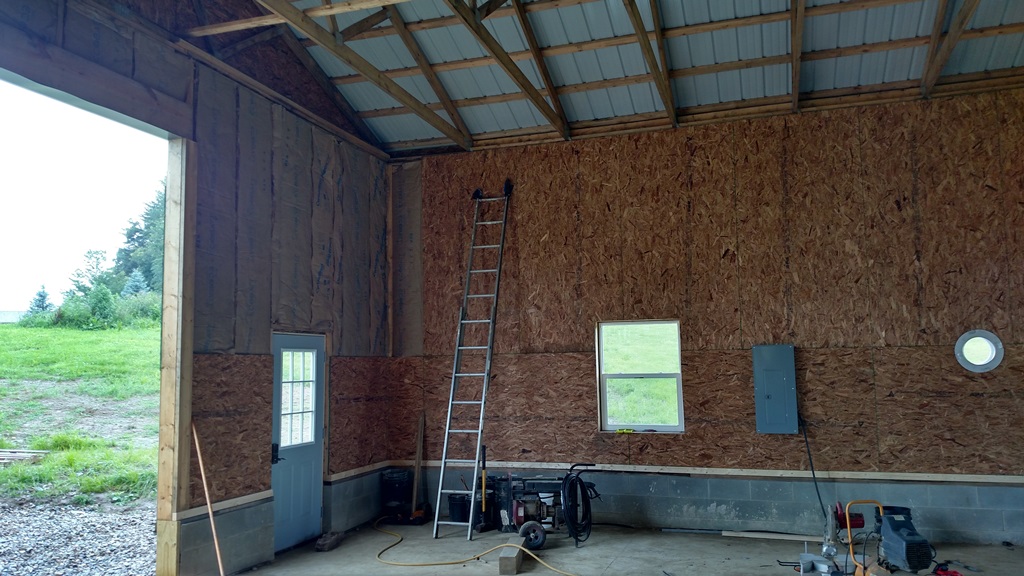

R19 in the walls with OSB

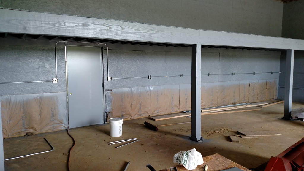

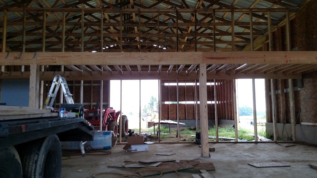

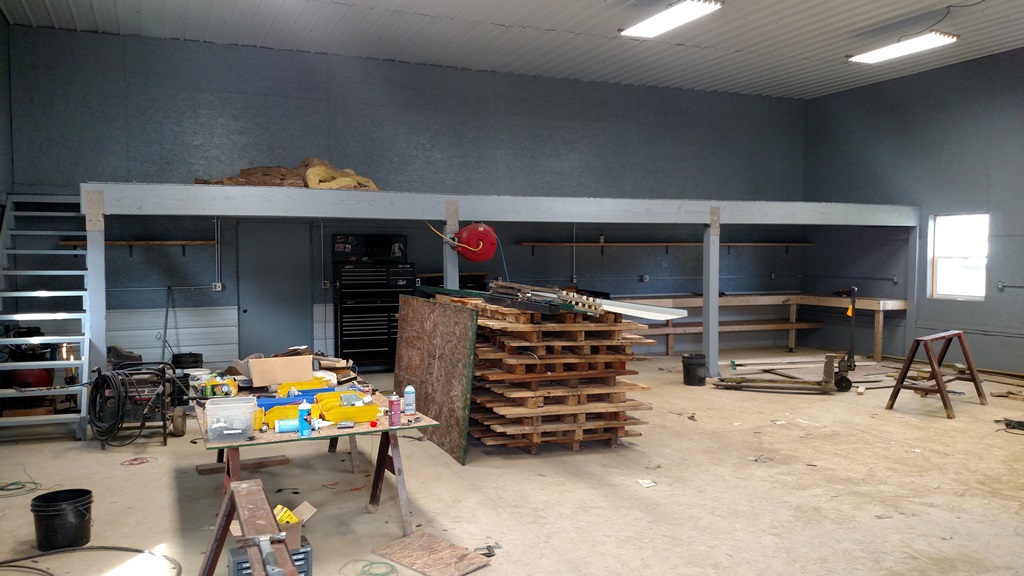

The dividing wall between the "shop" side and the "cold storage" side. As well as my "storage" mezzanine. Built for 100psf loading:thumbsup:

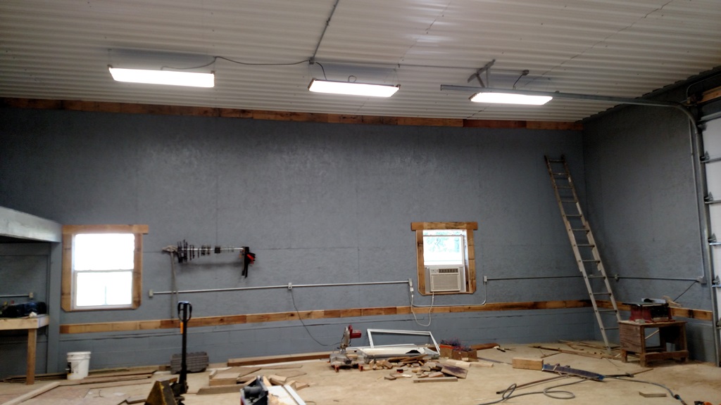

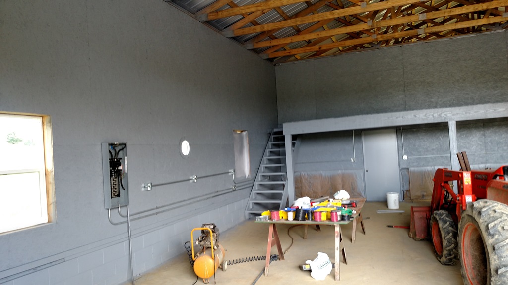

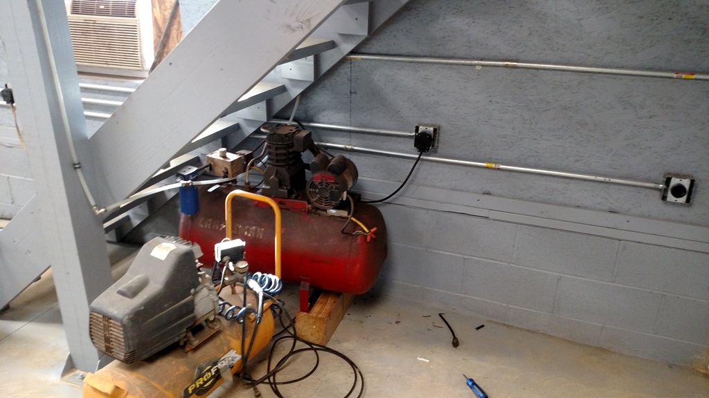

Now the paint. (and some electrical, as I didnt take pictures before I started running conduit)
Painting took about an hour to prep, about 45 minutes to set up the sprayer and walk planks etc, then about 30 minutes for the graco sprayer to drink 8 gallons of paint. I dont think I'll ever roll or brush paint again:D

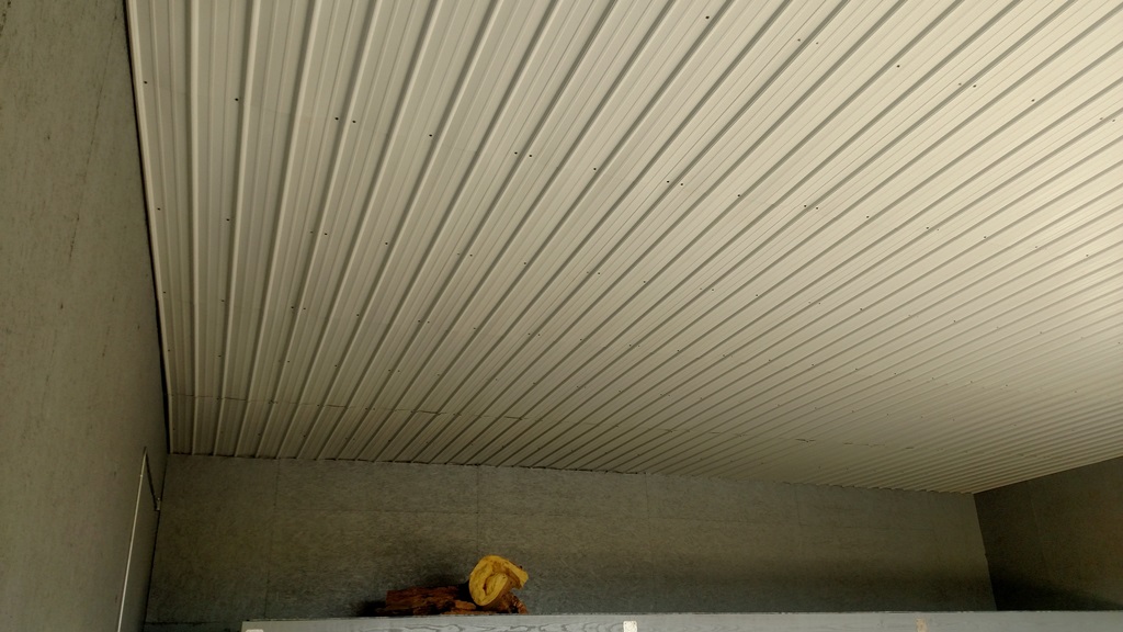

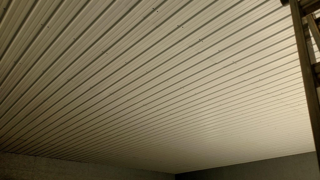

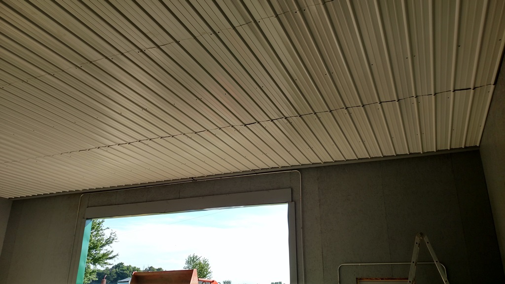

Ceiling liner. Boy that was fun finding someone who didnt get weak in the knees walking out on the walk plank to hold the sheet while I screw it in.
No pictures of the messy part, but there is ~12" of blown cellulose up there too
IMG_20150727_171357274.jpgIMG_20150727_171420183_HDR.jpgIMG_20150727_171426374.jpgIMG_20150727_171436954_HDR.jpgIMG_20150727_172417099.jpg

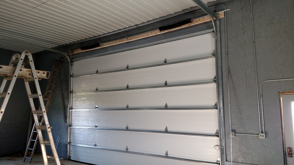

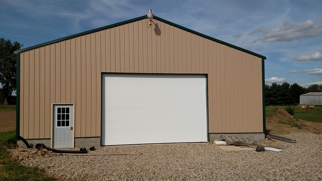

Wiring mostly done, security light up. Waiting on garage doors to arrive, we had some nice weather so I took the time to fix some of the mess left by the heavy equipment out playing in the mud during the wet spring
Garage doors arrived. Had to add a board for some mounting. Im too lazy to climb back up there and paint it grey.

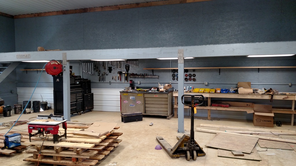

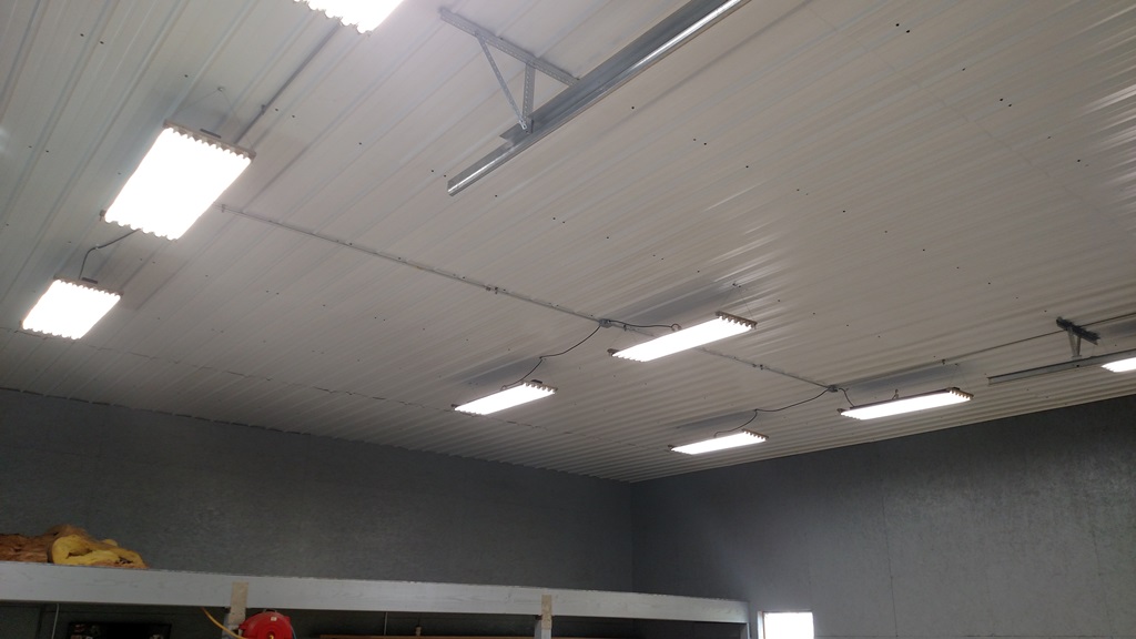

Lets light this baby up:

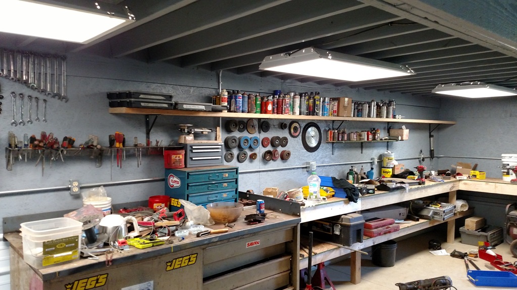

Just some more pics

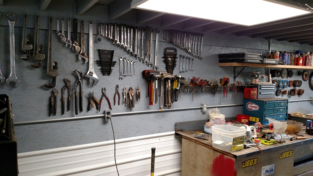

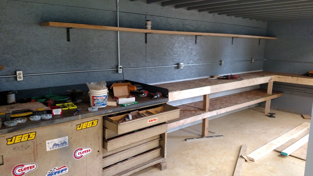

Shelf and workbench
Some custom trim work with recycled hardwood pallet lumber
Moving my junk in. What a mess...I have too much crap and lots of cleaning to do.
