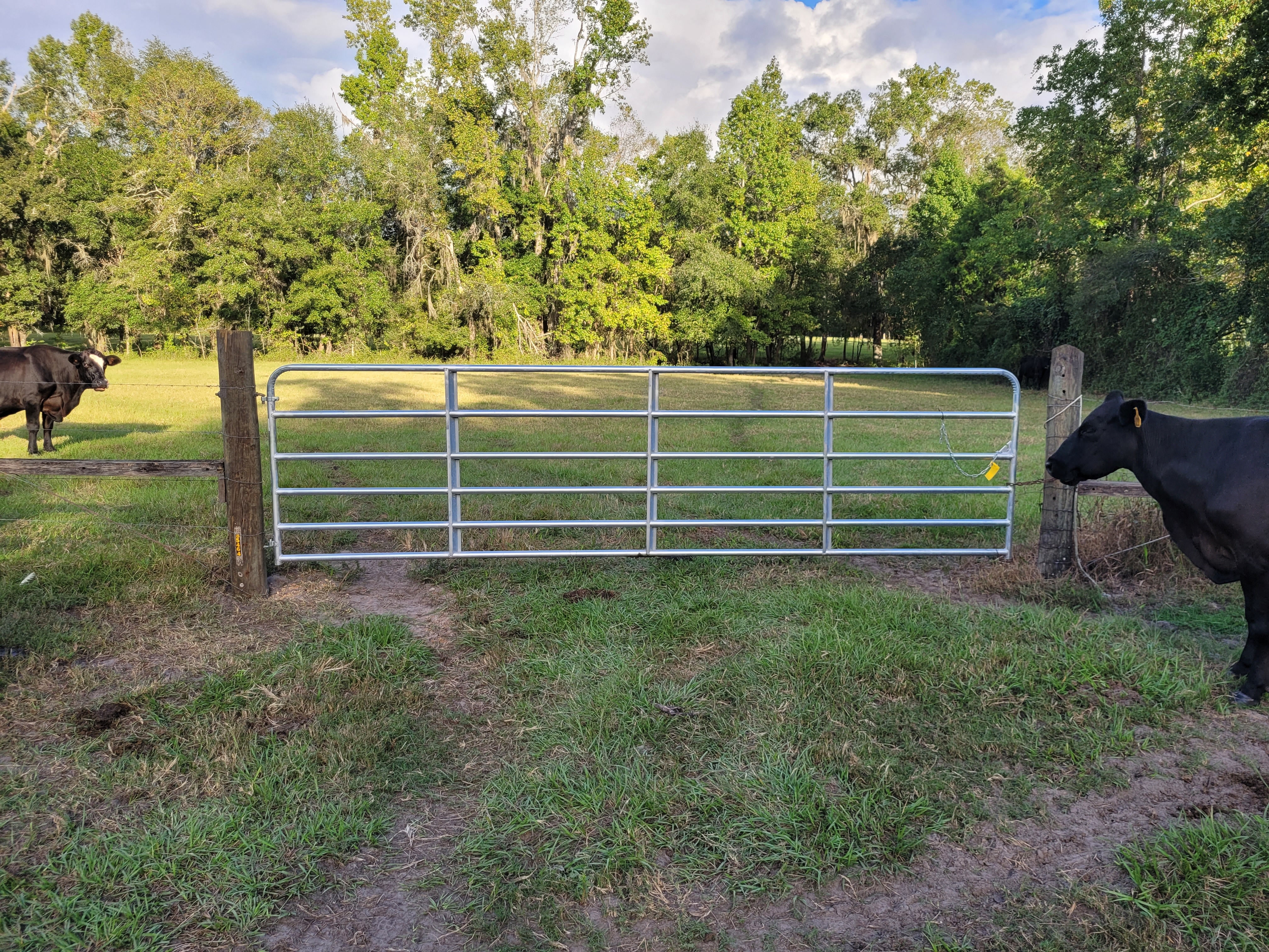

Took a break yesterday from skidsteer jobs to work on some of my own farm projects, I replaced a corner/gate post that me and my dad set about 35 years ago give or take a month or two when he and I cross fenced this field. I suspect that it will be the last time that it gets replaced as I don't know that any of my children will continue on with the farm/cows when I am gone. This little project brought back lots of good memories of me and my dad working on this farm, seems like I blinked my eyes and now I'm old lol, hope everyone has a great week, God bless Charlie. P.S. I decided to hang a new gate while I was at it.View attachment 4146059View attachment 4146060View attachment 4146061View attachment 4146062
"seems like I blinked my eyes and now I'm old lol," yeah isn't that a true statement! I feel exactly the same way! Nice looking cattle and property that you have. Enjoy it as much as possible!!
Thank you, those particular cows and yearlings were the investigators, doesn't seem to matter what I'm doing some of them want to be in the middle of it, lol. We might be old but were still here by the grace of God. Charlie.

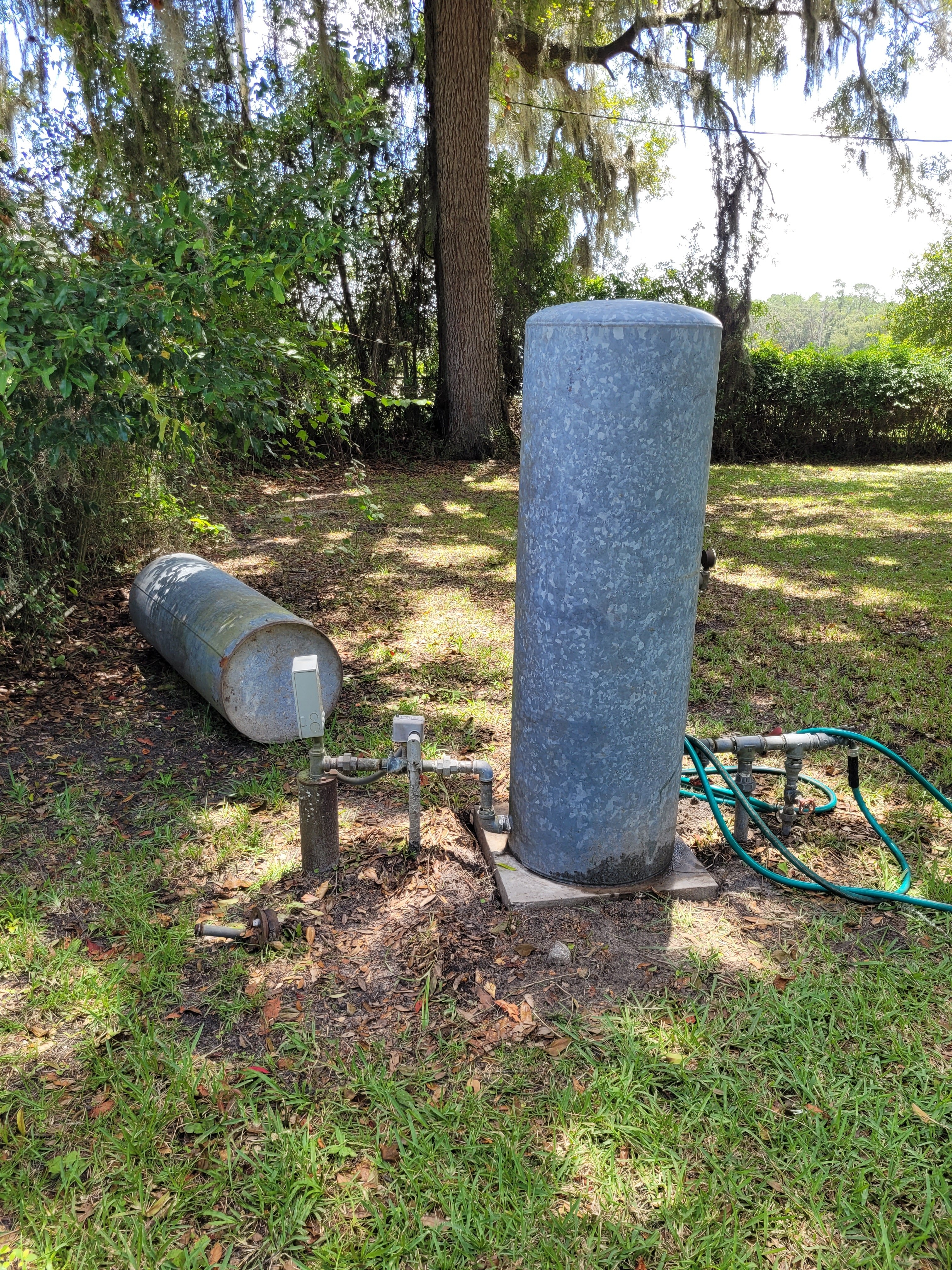

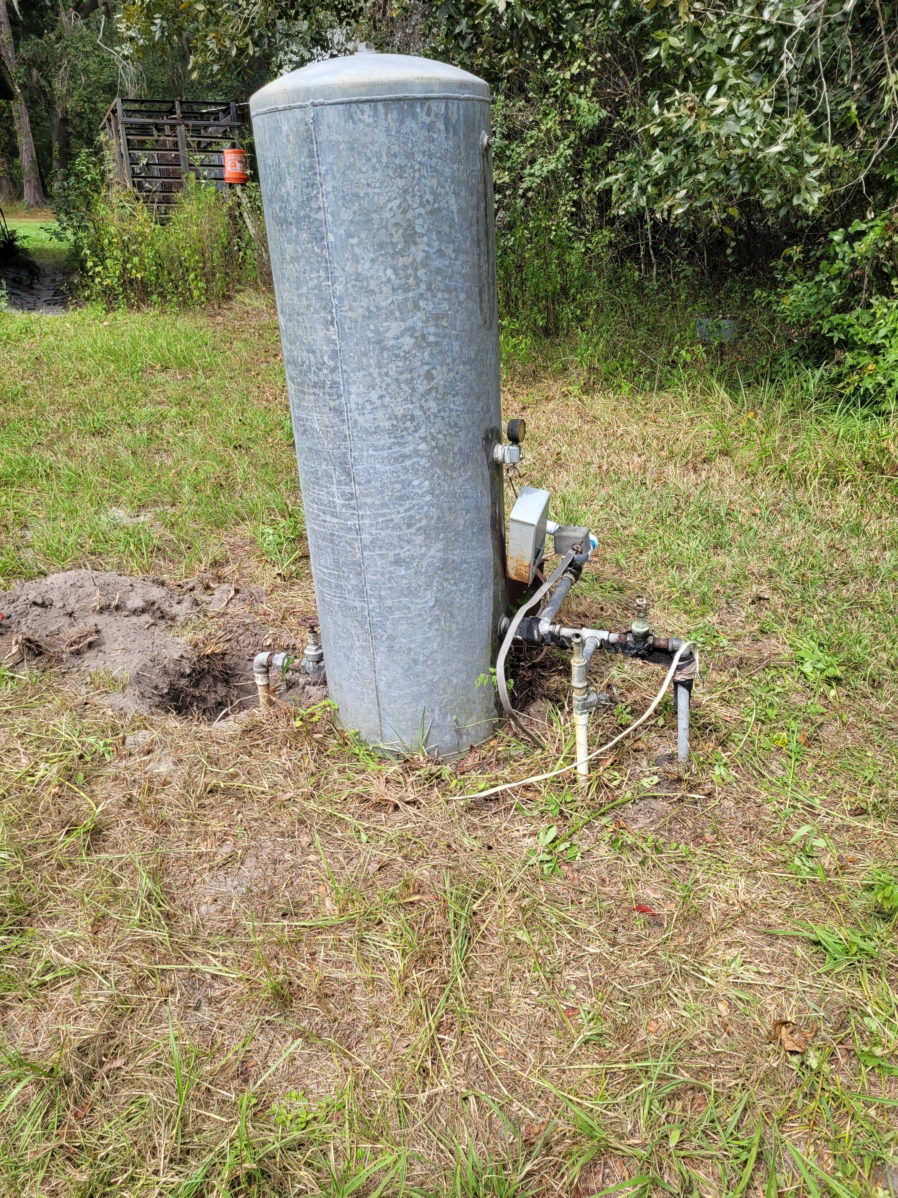

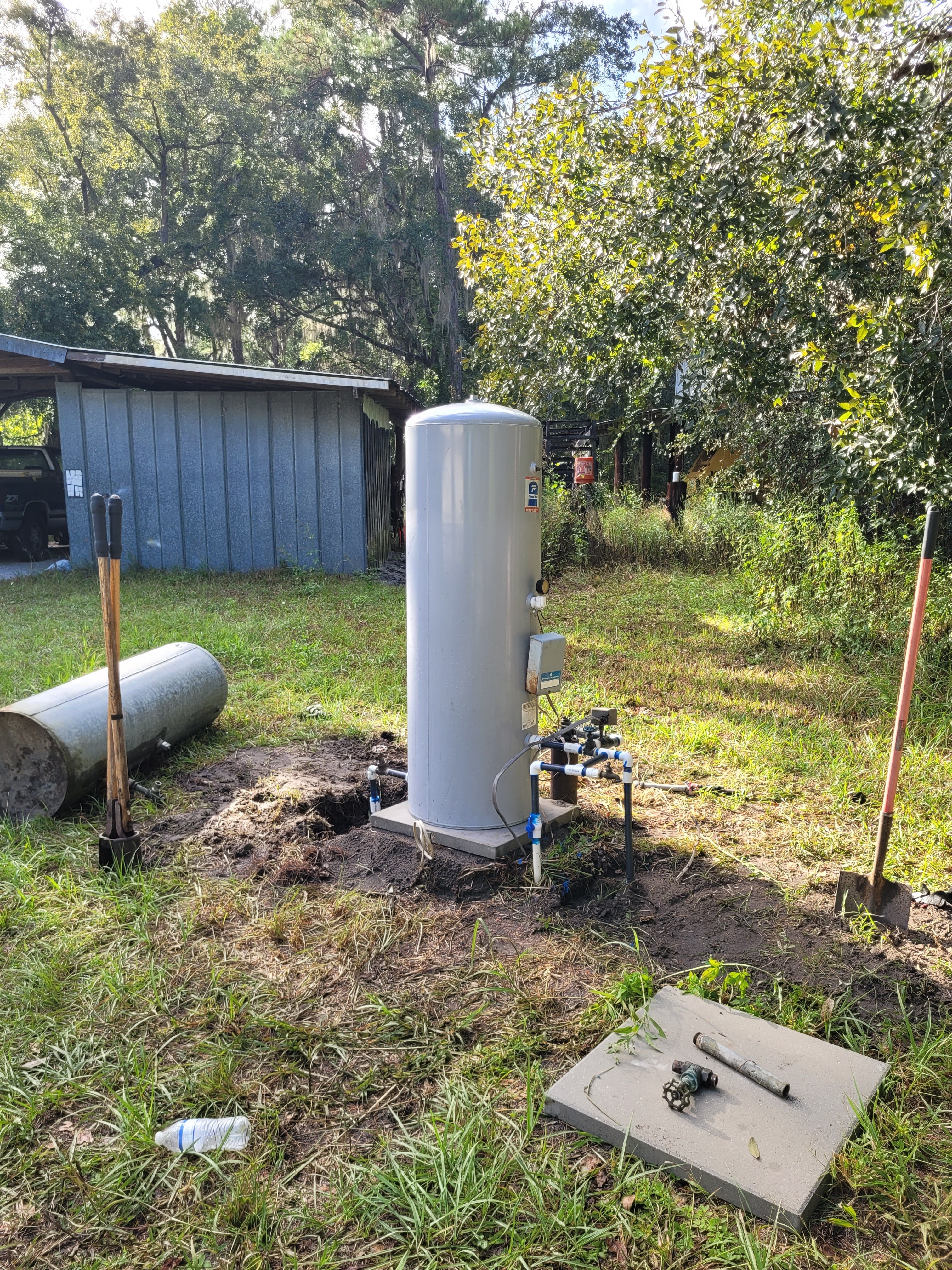

Some of today's work, I changed out the well tank at my dad's old house where one of my sons is living, this particular well was drilled about 1962 by an old well driller named Wallace Burch, it's about 165' deep and was pretty much put together with all galvanized pipe and fittings with no unions so the Sawzall was a blessing. I pretty much went back with schedule 80 pvc and tied it all back in underground to still solid galvanized pipe, at 63 years of service before it sprung a leak this old tank didn't owe me a thing, I hope my people don't have to do this again for a long time, I tried to do a good job with no short cuts, just like old Wallace did the first time, God rest his soul. Hope everyone has a great weekend, God bless. Charlie.

Did it just sit out in the open like that for all those years? no building over it?
Eddie, it has been out in the open weather all of it's life, I changed mine at my house this year as well, it was originally put in to water cattle on our farm and it was installed within a year or two before this one before it sprang a small leak, it was out in the open all of it's life as well, so that tells me that galvanized well tanks from that era if left uncovered had a life expectancy of 60+ years lol. Both tanks rusted through right above ground level at the very bottom of the tank.

Some of today's work, I changed out the well tank at my dad's old house where one of my sons is living, this particular well was drilled about 1962 by an old well driller named Wallace Burch, it's about 165' deep and was pretty much put together with all galvanized pipe and fittings with no unions so the Sawzall was a blessing. I pretty much went back with schedule 80 pvc and tied it all back in underground to still solid galvanized pipe, at 63 years of service before it sprung a leak this old tank didn't owe me a thing, I hope my people don't have to do this again for a long time, I tried to do a good job with no short cuts, just like old Wallace did the first time, God rest his soul. Hope everyone has a great weekend, God bless. Charlie. View attachment 4181971View attachment 4181972
Good job replacing/fixing up the old tank -- but what a chore that must have been! Mine sits out in the open too but it's attached to everything with plastic pipe already. Todays galvanized metal wouldn't be "near" as tough as that old stuff.
