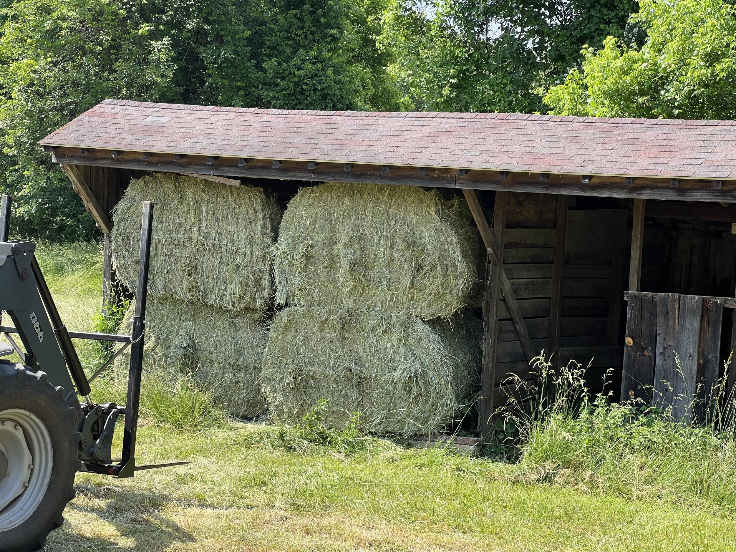

What’s your round bale weight? Mine were 800-900lbs. Ever since I switched to the large square baler, I have been able to start making “cubes” that weigh about the same as my 4x5 round bales (most weigh 850-900lbs with 12-15% moisture).
Then my round baler became useless and I sold it.
I sort of had to switch as most of my larger buyers want big bales. Round bales are still great for my small buyers. Most have been happy with my new “cube” configuration.
With your flat land you have there, round bales are very sensible. On my hilly fields, the large square baler is perfect.
They also double stack nicely in tight barns or run in sheds.
I'm gonna guess about like yours give or take a few pounds one way or the other, I can for sure see from your photos with how steep some of the fields are why the large square bales make sense , down here the money is in the small squares, that large square bale rig you have is sweet, almost as sweet as your front mounted cutter.
