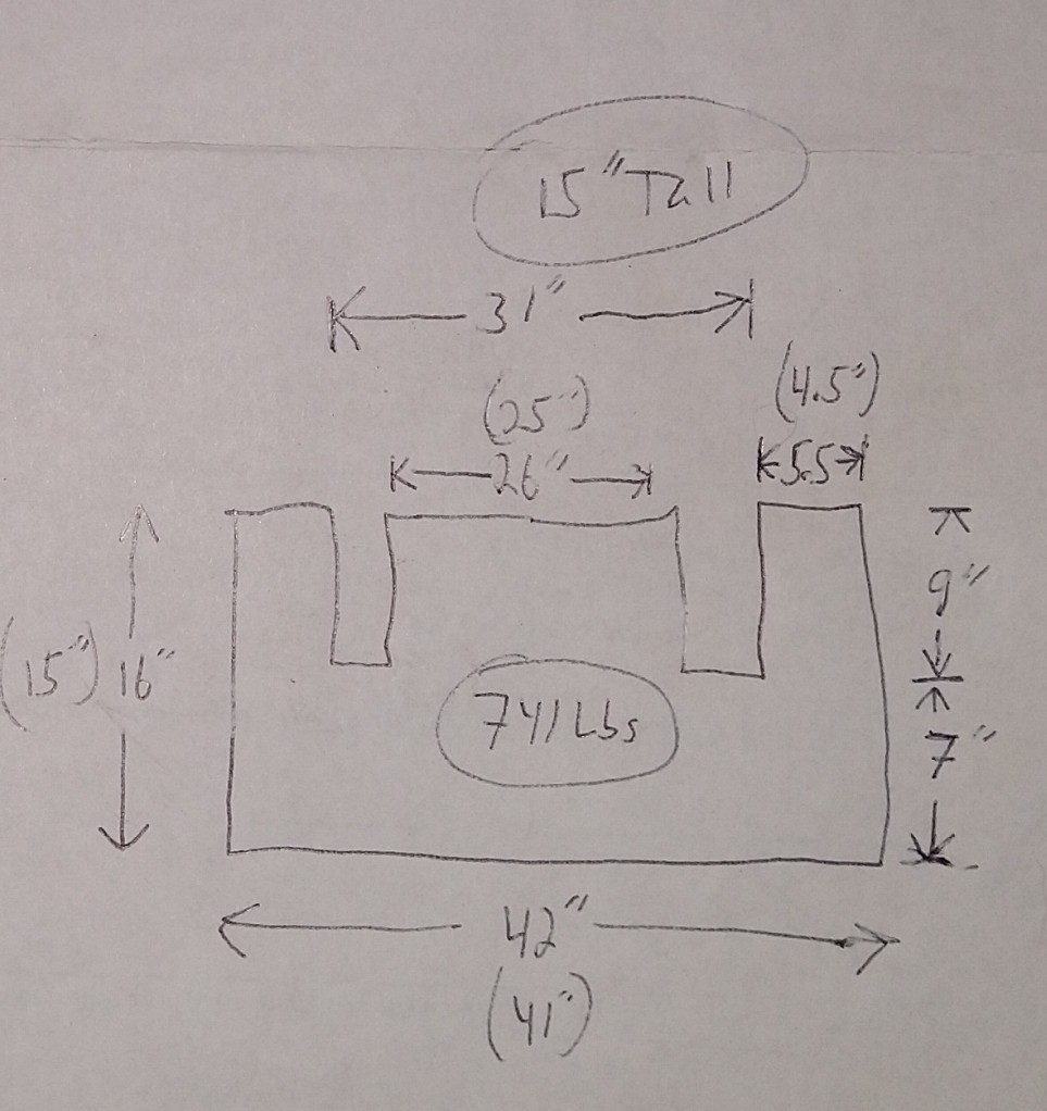

Example... 600 pounds , it's a 2x2x1 foot box filled with concrete (150 pound per square foot)....

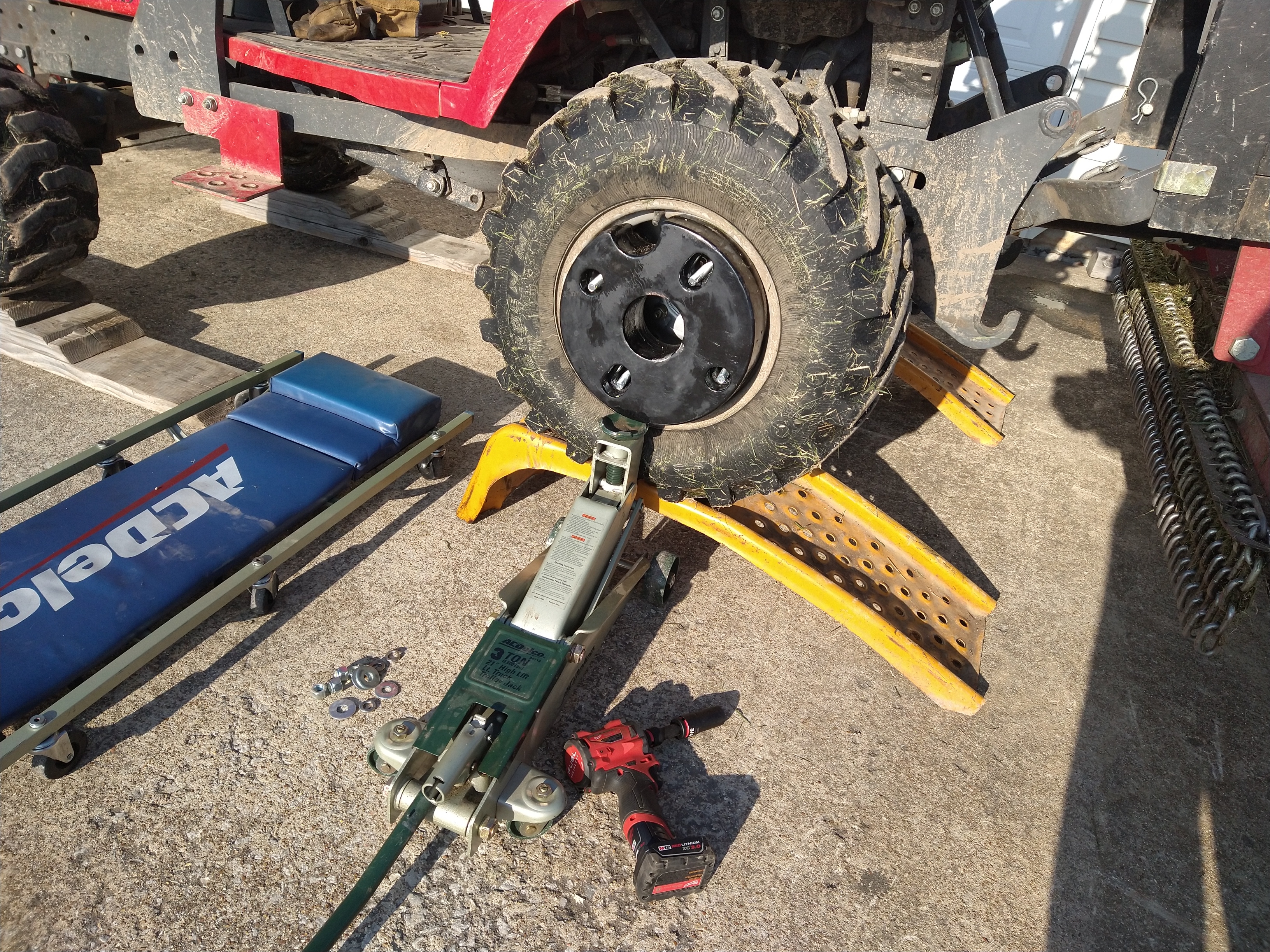

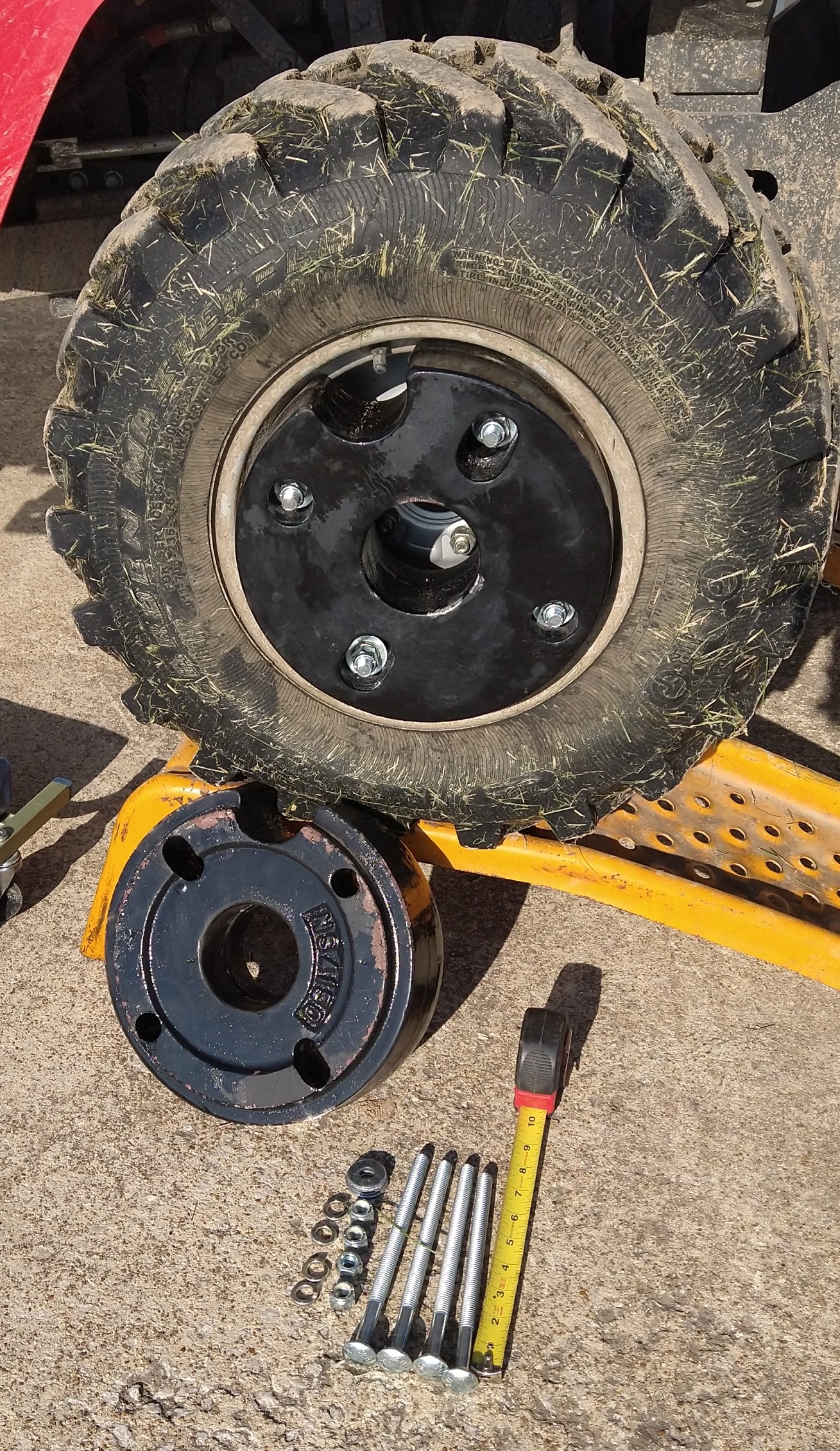

I use the factory 70 Lb wheel weights, they help with rear tire TRACTION, but don't relieve the front axle of any weight ...

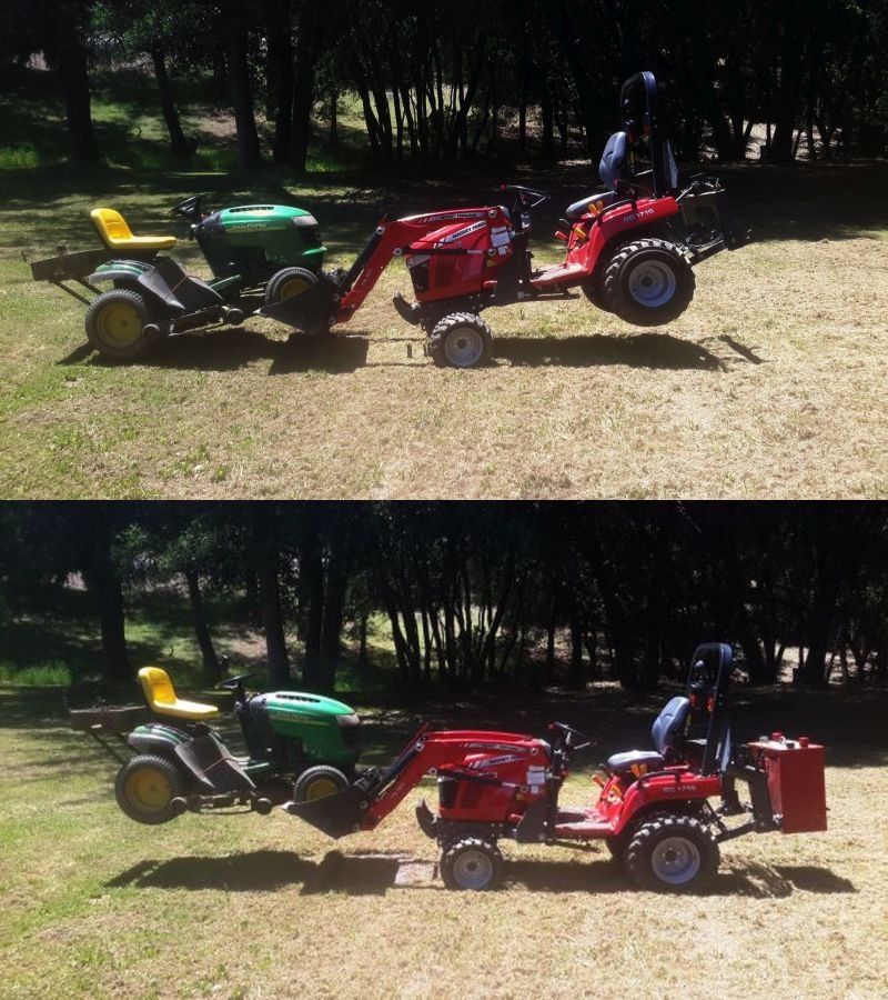

I've also added 275 Lbs via the BH frame, mostly for TRACTION when using an attachment on the ground ...

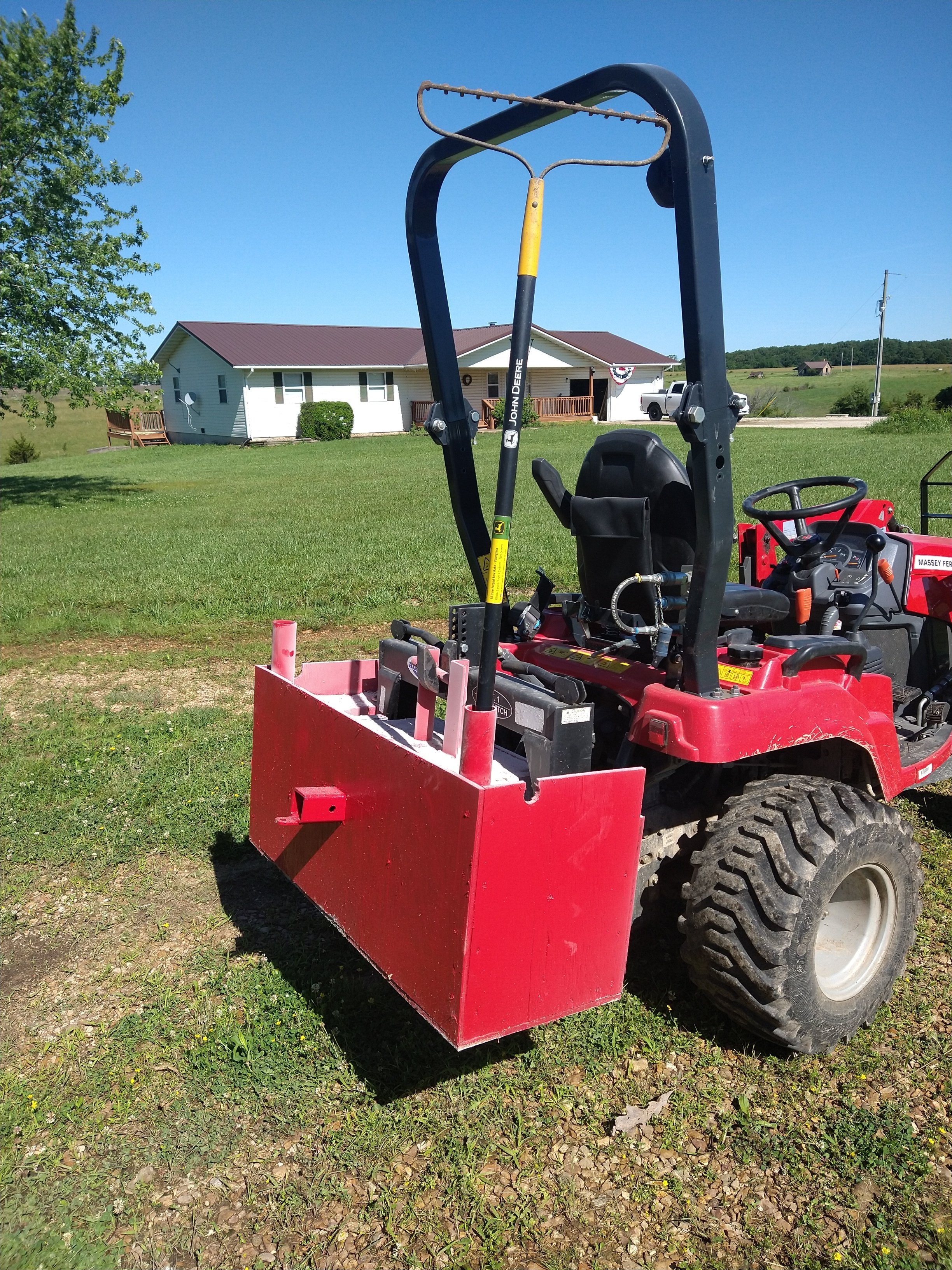

I also designed and built my own rear ballast box to fit my quick hitch to keep the weight forward and tight, for hauling a trailer, but also a tote on the front ...
Actually weighs 707 Lbs
Works good!

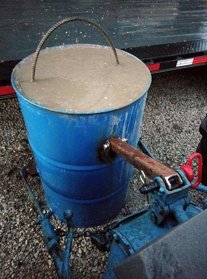

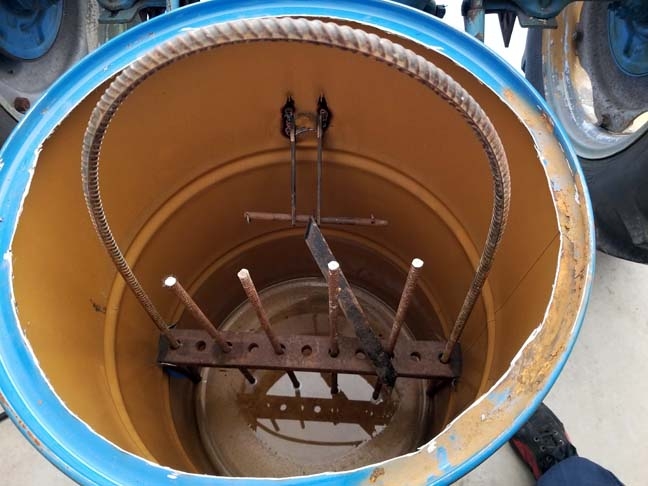

Probably on the 3 point lift
A 55-gallon drum, a cross drawbar, some rebar and concrete can result in this. Put the cross drawbar high enough so you can set it on the ground from the lift - will be easier to hook up.

  • 55 gallon drum on cross drawbar counter-weight - interior view of rebar.jpg

Cast some PVC pipes into it to hold shovels and such. Maybe a flattened piece to hold your chainsaw. .
Perhaps continue the pipe thru to the bottom so water drains out and don't freeze and crack it.
