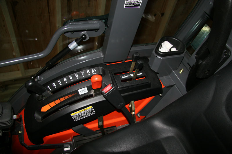

Here is a picture of the inside cab controls for the rear remotes. I have two installed which is the max on the B3030. I don't have pictures of the remotes themselves on the outside but it is a very clean install above the 3 pt hitch.
amigauser,
That's what I wanted to see. They do look like they belong there. The install directions show the valve(s) and hoses well tucked in. It also makes me think that a joystick just wouldn't be feasible. The levers look kind of long. Do they feel pretty sturdy?
KTM300
   / Pics of B2630 or B3030 Factory Remote? #9
THe picture amigauser posted is the exact same on my non-cab. Aside from the cup holder in a vaguely sane location...
Levers are very sturdy. And long indeed - they go through the slots pictured through slots in the deck.
