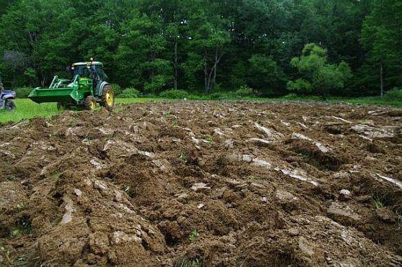

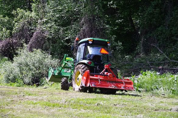

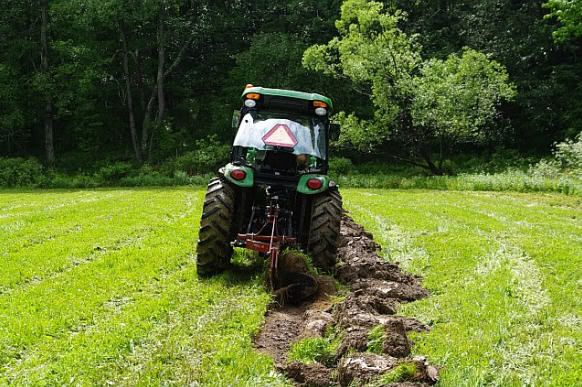

Here are the pics I promised of the food plot I did.....I bush hogged it first, than used a 14" bottom plow to flip the sod over, than used my Kuhn tiller. I tilled it twice and it came out beautiful. The soil was wet but I had no choice but to get it done that weekend. Than I used a seeder to seed it and ran over it with my quad. I will be there next weeked and see if I have any growth :eek:

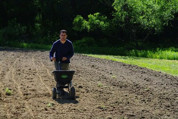

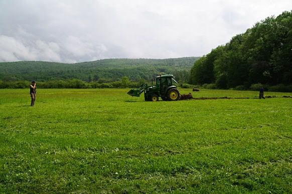

My brother is the guy seeding, my dad is supervising, and I am in the cab in HEAVEN! :D

Beautiful setting. It looks like you could make a living farming that land it's so flat and the soil looks so rich.
I got a laugh out of seeing that really nice tractor with a cab and tiller, which cost a fair amount, and then seeing what you use for spreading the seed. I'm the same way, I'd love to have a fancy seed spreader, but just find other things to spend money on. One day I'll get one, but for now, I use what I have.

How did the tiller do with the root mass in the sod? I'd figure you had go real slow.
   / Pics I promised from my food plot weekend
Not as slow as you think.....About 3-4 MPH, and I did it twice so it came out nice and level........Just had to be careful for any big rocks, but the sod was mulched up good.....Almost zero grass was visible
