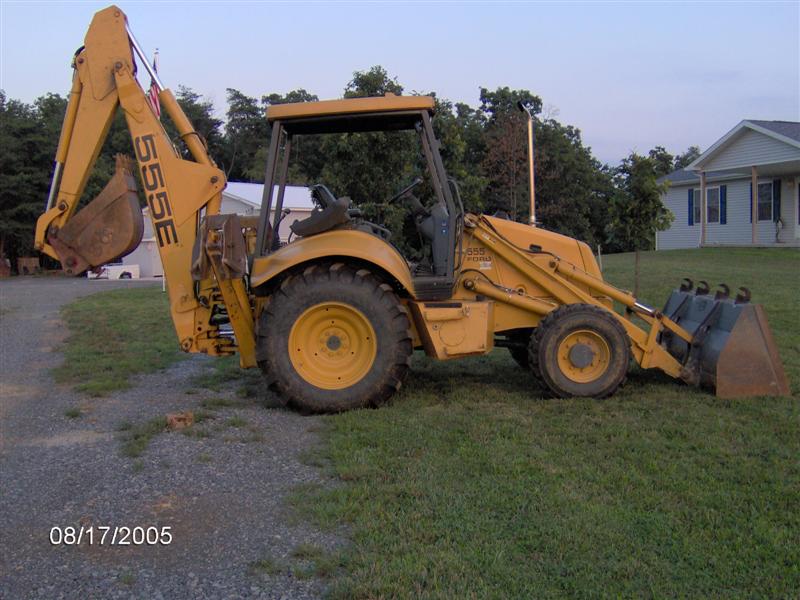

Of course. A 7.5 on 7 cylinders will out pull a good running 5.8:p :D
We hauled a NH555 backhoe 4x4 from NC to WV. Pulled it fine. Getting it to stop....well that was another problem. Attached is the picture of the tractor. Pretty good load.

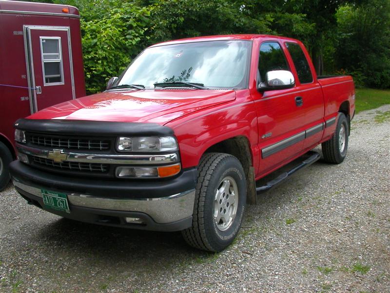

Finally bought a truck. '01 Silverado Z71 / 1/2 ton / LS / 5.3 / 4x4 / Extracab / spray-in bedliner / tow package with electric brakes / 56K miles / $12,500. It appears to be well taken care of (all records) and the miles are relatively low for the year. Tires are good. I'm looking forward to picking it up on monday morning. I looked within 500 miles of VT and PA. It's the nicest rig for the money I could find since my original post.
Oil undercoat which appears to work very well in these parts, although I've never had it done personally. They superheat oil then high pressure spray it inside the door and rocker panels, under the frame, etc. Apparently one has to remember to do it now and again to be effective long term.
Thanks for all the replies. Quality posts all around.

Congrats on the truck, Jim. Looks really nice, keep the rust off!
