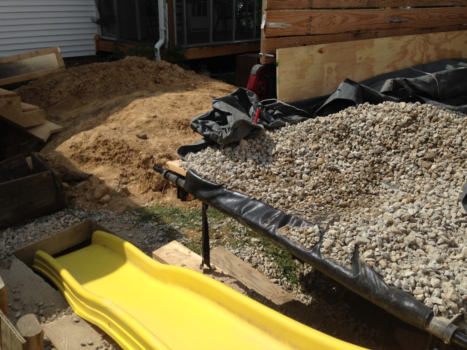

And here's a pic showing how we use a 20+ year old plastic slide as a chute for directing the gravel. This made it SOOO easy. My son would crank the handle, fill the slide, I'd lift up one end of the slide an dump it in the well we were filling. slide1.JPG

Well it took a week but it works GREAT.
After loading I just wrapped the excess tarp over the top of the load paid ($14 for 1,760 lbs) and drove off.
For unloading we folded up the excess tarp hanging off the tailgate, hooked up the loadhandler and my son cranked the load off rather easily in about 5 minutes or less.
If I can find a suitable surface with a real slippy surface it might even handle 1.5 tons.
