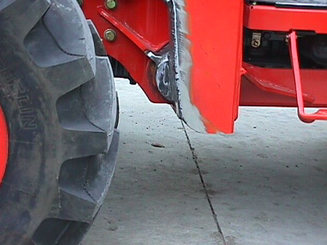

Thanks for contributing Rat, I too suspect the tires will hit but the 4 cyl L30's are a bit longer wb than the L10's including the L4610.
The Michellin's are only 1/4" larger radius than the stock front ag's on the L5030 but it is the wider, squarer profile that is the problem. A rim with less offset would help this too but the front end of the tractor would end up narrower.
The Goodyear DT810, 280/70R16 measures in at 1.3 inches smaller diameter than the stock ag's and may fit perfectly.

We have a pic of an L5030 on R-4's stock. There is about 6" between the loader bracket and tire with the wheels straight.

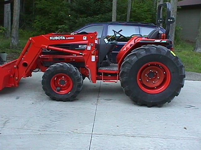

And here we see stock ag's on a L5030, about 3" or so clearance with the wheels straight.

Rat, looking at the pics of the 5030's, would your machine have more or less clearance to the loader?
I know the pics are hard to judge.
I think it is probably ok to mention now but I should have a familiar L5030hstc heading my way in about a months time. Pretty excited to be getting a machine that won't require more time repairing than operating!
   / Picking up Glenn's Work - R1W Tires Grand L's #39
Re: Picking up Glenn\'s Work - R1W Tires Grand L\'s
On page 24 of the Kubota L30 series brochure, it would appear that the LA 853 gives more clearance. BOth tractors on that page have R4's. While it is tough to tell which L30 is in the upper photo, it does have a LA 753 loader. My guess is the L 4330 on up have more tire clearance at the loader tower support.
