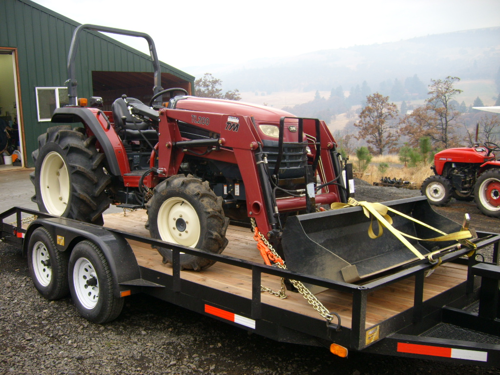

It was no fun to tow a trailer that has a surge brake. Electric brake would have been much better. The tractor had indeed signs of rental unit. Radiator was filled with clear water. Almost no antifreeze! Fortunately, the water was not rusty. Transmission fluid was below low mark. The dirt trap of the cyclone air filter housing was full. I bet they never squeezed the dirt trap.
I have a question. The rubber boot of the left front ball joint was damaged. It does not have a nipple at the top. Top is flat just like a sealed ball joint. But it has a grease nipple on the side and has a rubber boot. Should I replace the ball joint? Please advise.
The filter screen in front of the radiator could not be removed because of the loader. It kind of pulls out half way only on one side. Any suggestion?

The screen on mine (Mahindra/TYM) will not pull out all the way without removing the loader. I've found that a long nozzle blow gun keeps it fairly clean without needing frequent removal.
   / Picked up my tractor yesterday #4
I think if I understand you correctly that you will not have that problem with the TYM tractors now being distributed by TYM-America because they use a pedestal or mid mount loader (same loader was sold with the Century as the C50 and C50HL) that does not have the frames running forward beside the side panels

Here's a picture of a new 330HST Tractor with Loader frame fitted
