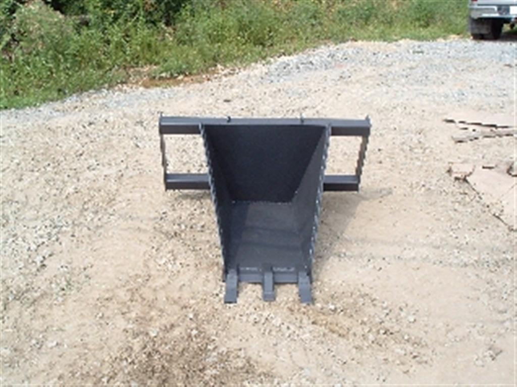

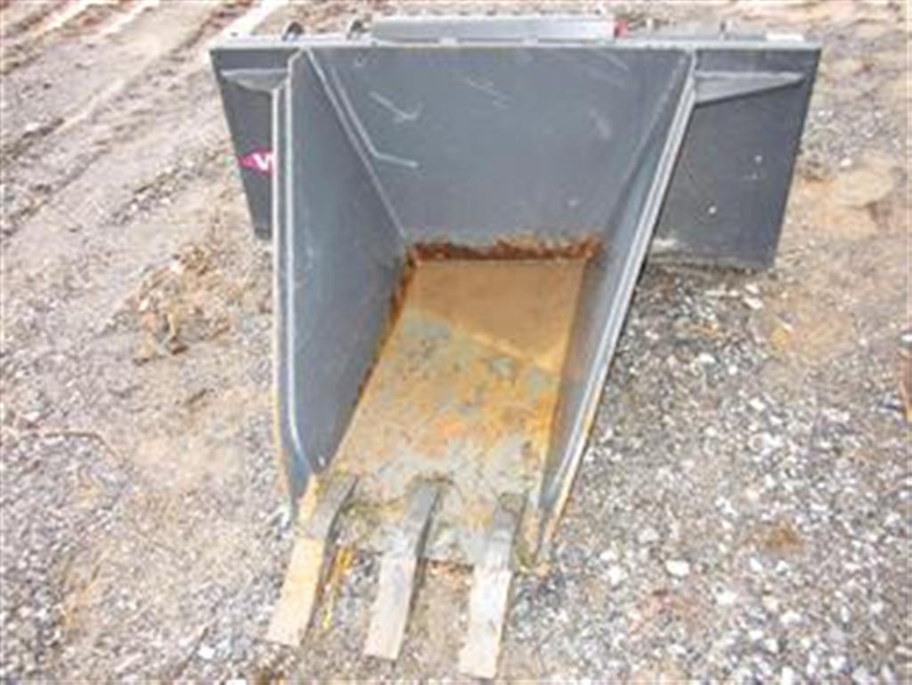

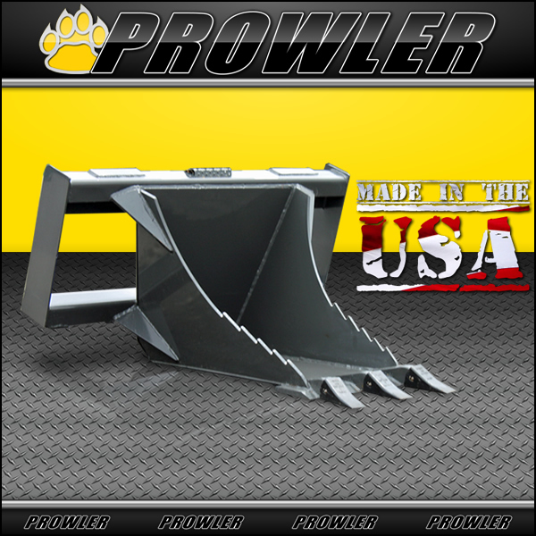

TSO,do you think this narrower shape would work any better on your tractor?

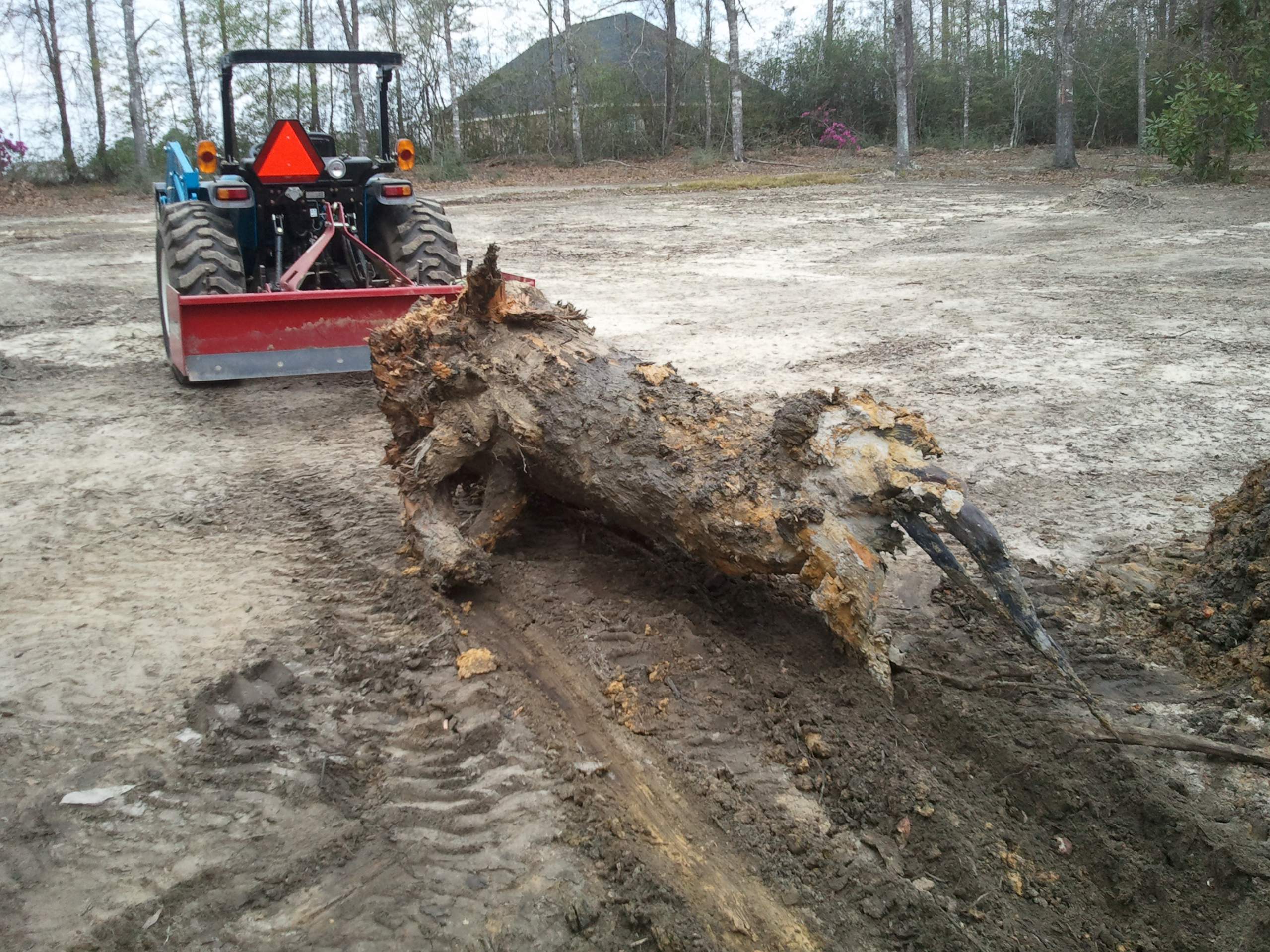

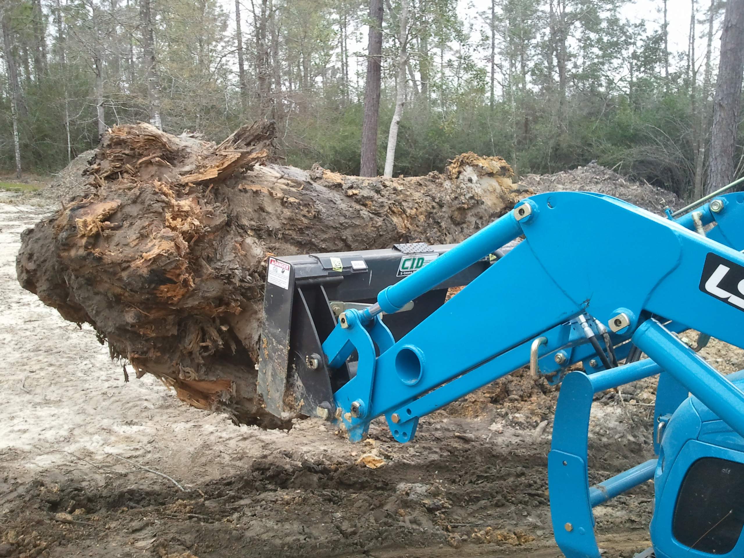

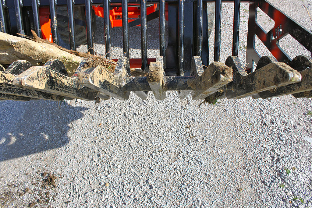

TSO, I've had good sucess with my stump bucket on my R3039H. Mine is a bit different design, though. It has a more narrow taper to the back of the bucket, and has the ripper teeth on the bucket edges. I can easily push my bucket into the ground, lift as I back up, and tear through the roots. I've dug out some really deep pine tree stumps with mine. I can actually dig down 5 1/2' with mine. Of course, I had to pay quite a bit more for mine.

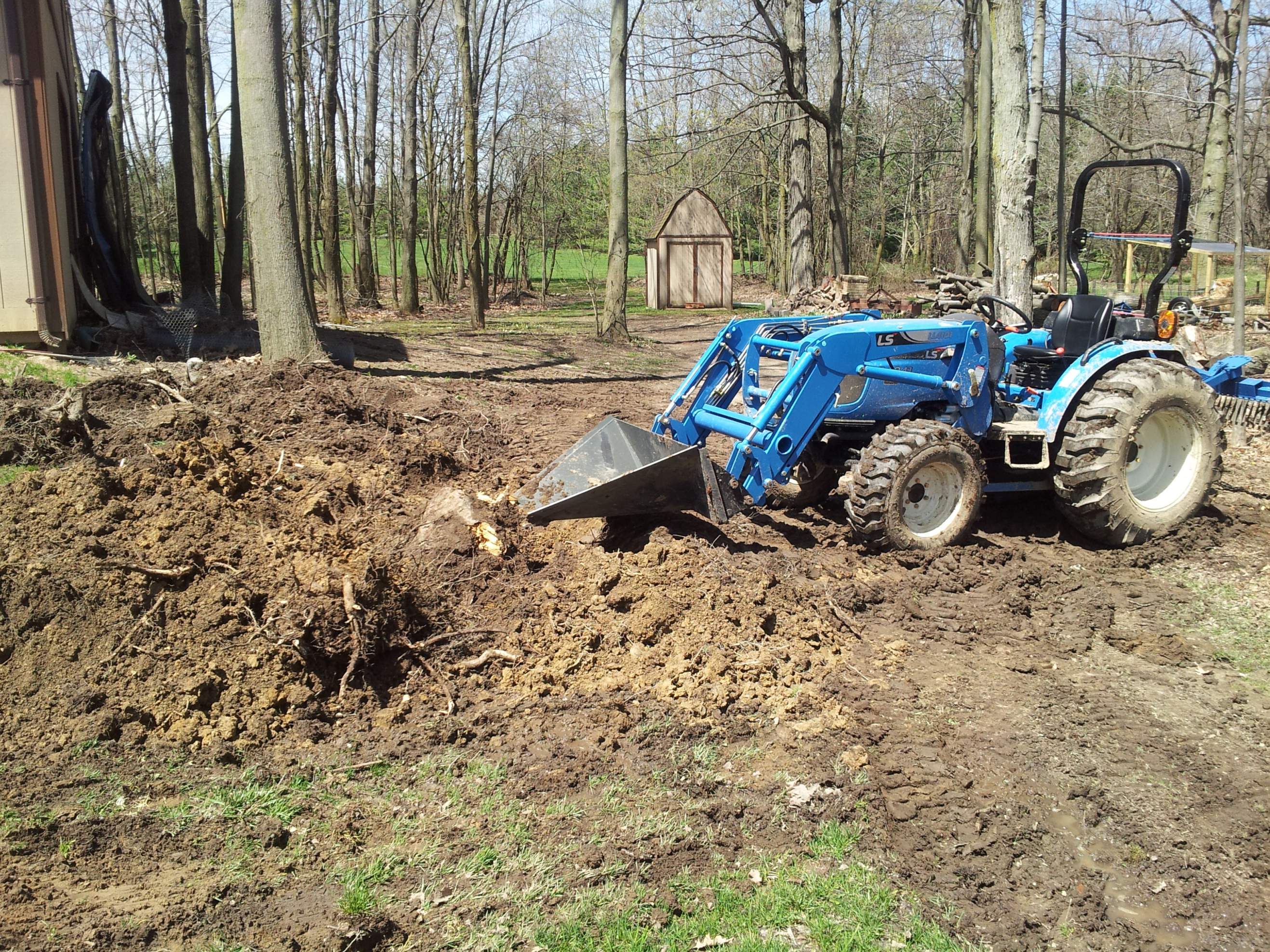

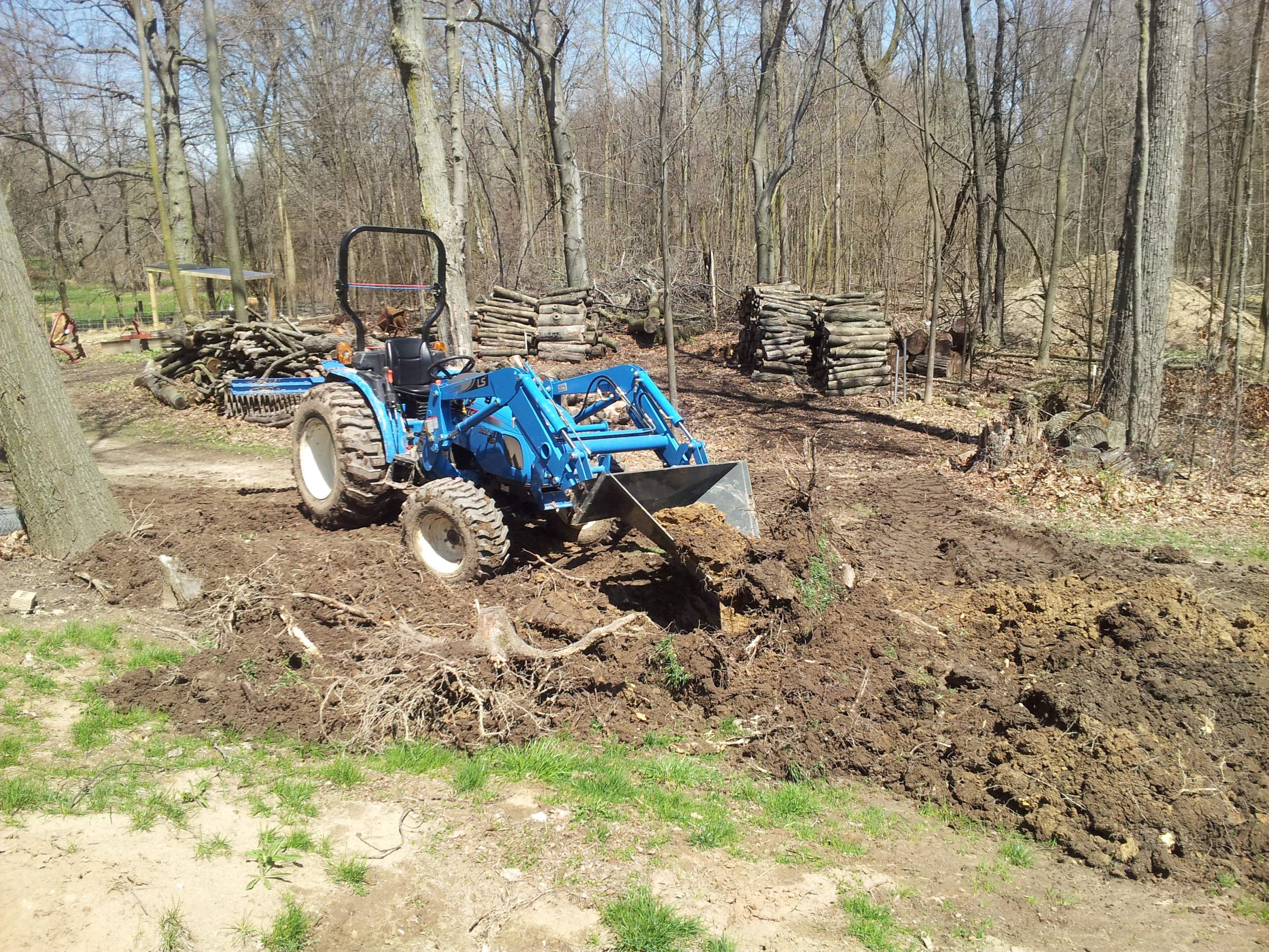

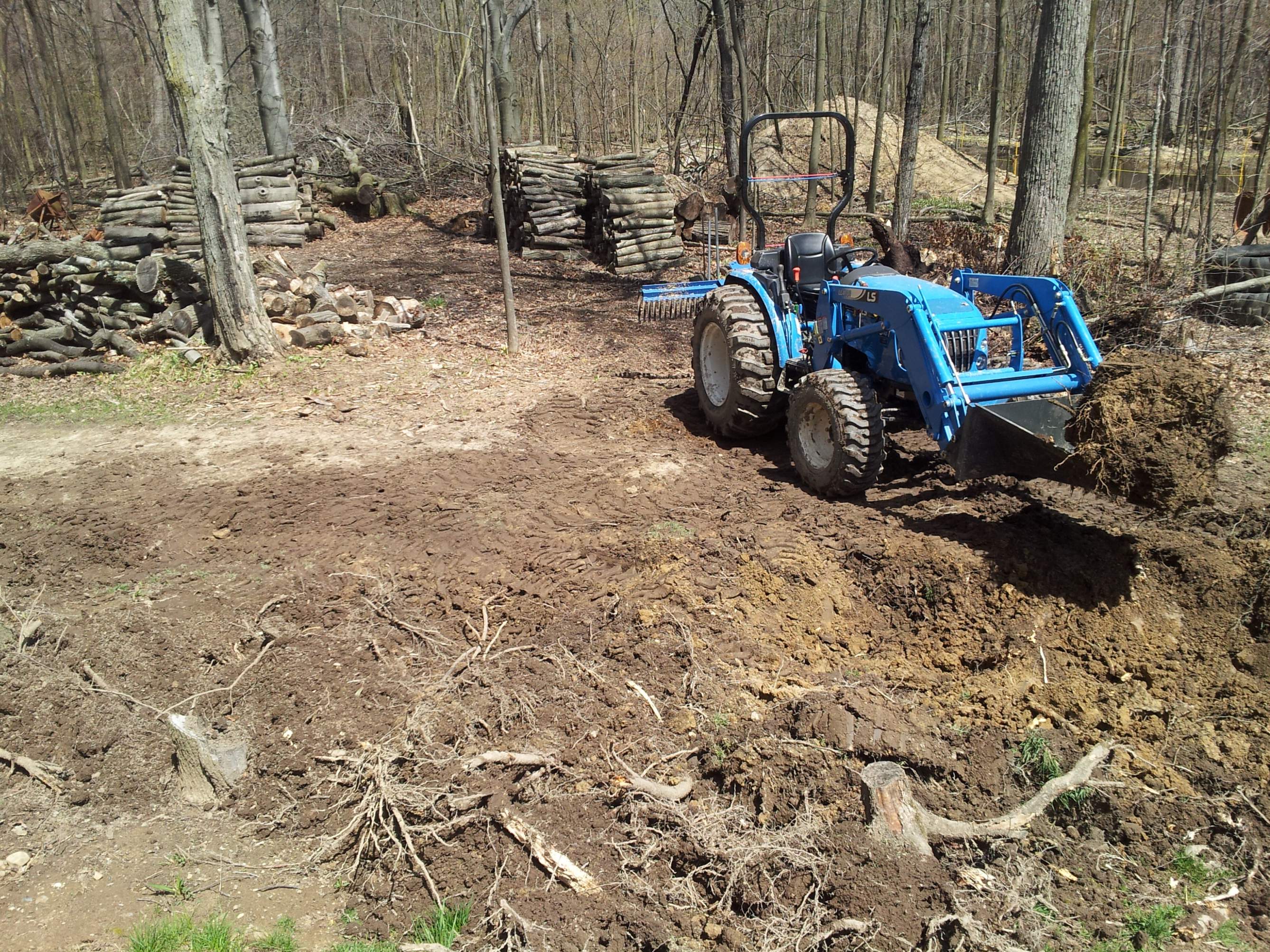

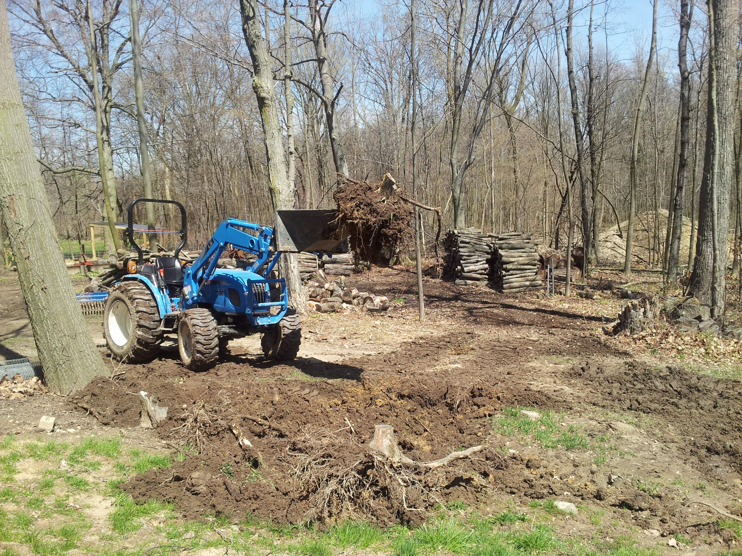

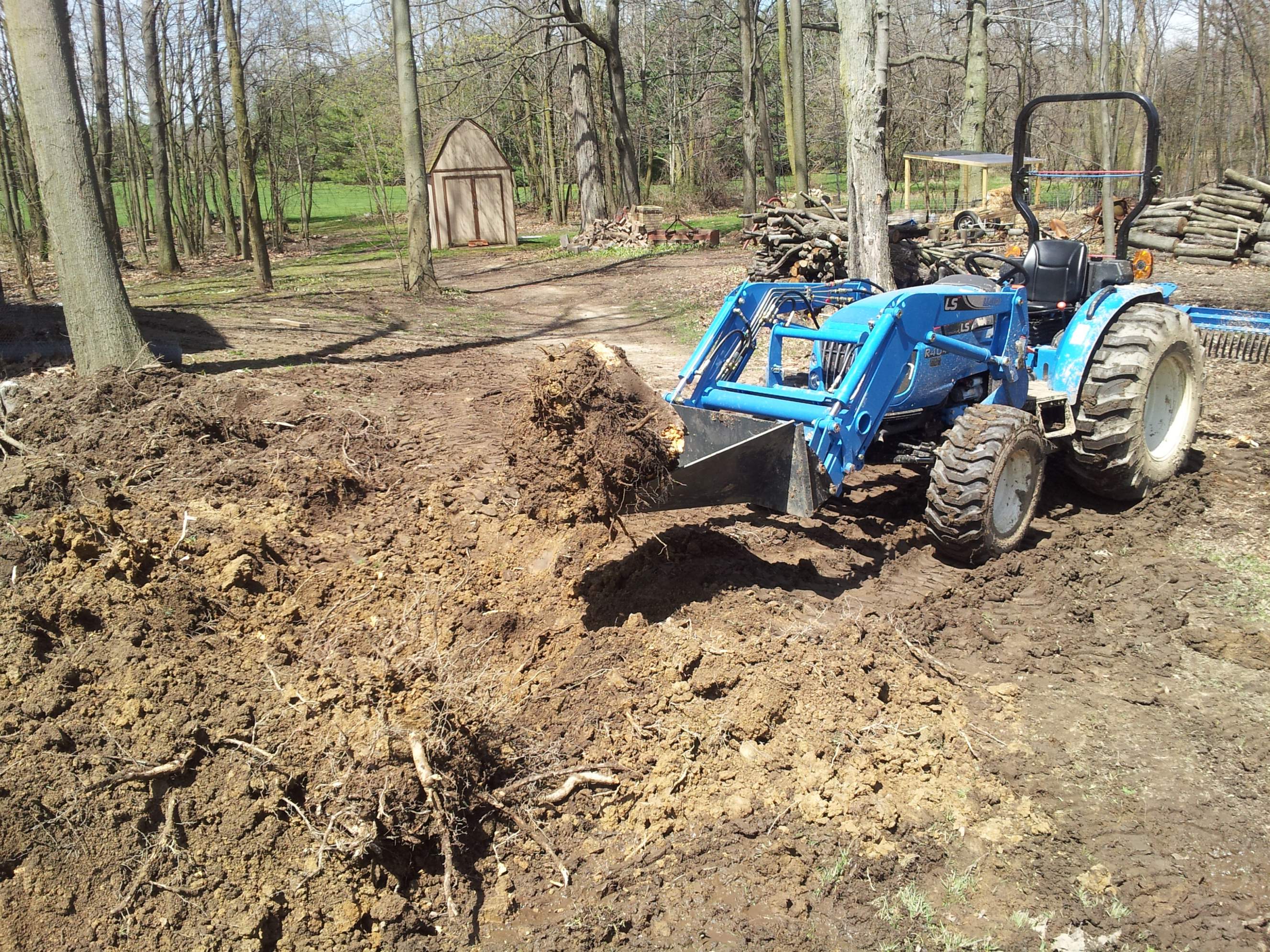

To be honest... Pine stumps are the least of my worries and aren't in the same class as what I'm digging out, which is mainly oak & maple. I originally looked at the narrower ones, and that's what I was going to order (had I not found this one at auction) based on the same thought-principle that you mention.
However, after using this one (up to about 10 stumps now) I don't think that the narrower version would make much difference, if any, on OUR SIZE tractors. The limiting factor is still the loader strength & dynamics. The actual part of the bucket that is in the ground digging is the narrow tip anyhow, so the ones pictured would have about the same functionality. With that said, I am definitely getting better with it, and learning how to use it better. BUT ... I've been sticking with the smaller stumps.
I just got done removing another 4 stumps, which only took me about 30 mins combined. These were all pretty close together, so ripping through roots of 1 probably also ripped through some of the other roots too. These stumps were ranging from 5-8" I would say. I think that this implement really shines with the smaller stumps like this. I just don't know if I would have the patience or the time (probably take several hours) to dig out one of my bigger stumps, which range from 12"-32", and I have plenty of those still.
