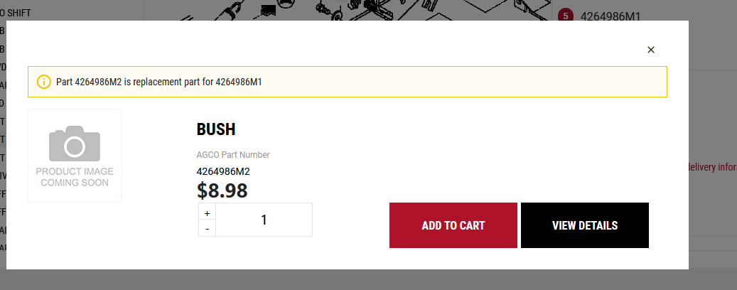

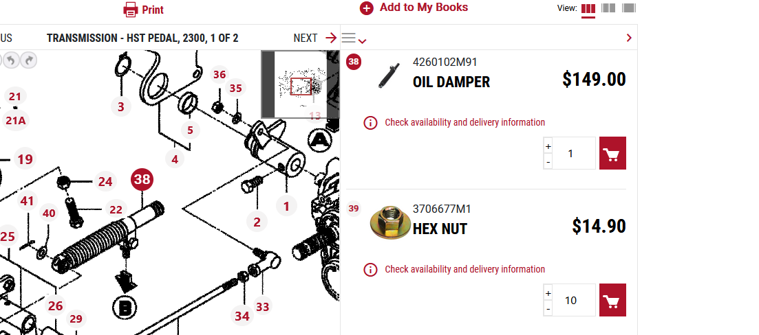

If the 2300 like the 2400 there is a bearing on the side of the frame that supports the directional input shaft going into transaxle.
That bearing can be worn and cause pedal stick also.
   / Picked up a GC2300 fixer-upper. :D :D #5
parts book shows as a bushing there, item 5
has alternate part # now

mine ALMOST returned to stop after replacing that (on my GC2400) BEARING (actual bearing and mine was missing balls) as well as replacing the return spring (was stretched out badly) and removing pedals and cleaning out the bushings there.
but the BIGGEST gain (mine now return fully 95% the time) I got was replacing the oil dampener (it acts like shock absorber and was sticking.
on the GC2300 its part # 4260102M91 and is approx 150$
item 38
after 12 years (mines a 2010 model) things wore out a bit.

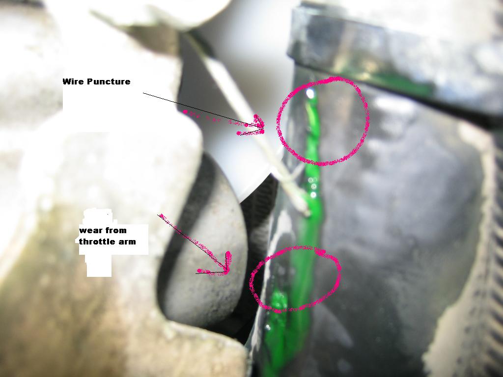

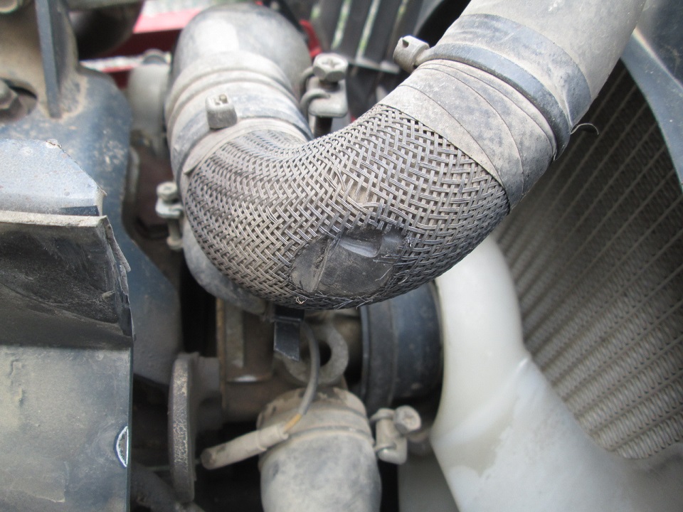

Also check the rad hoses. Vibration will wear through the hose. Upper hose on the air filter hosing, lower hose on the throttle linkage. My 2005 GC2300 had both replaced under warranty. Added buffer material to reduce the wear, but is now ready for a 2nd replacement.

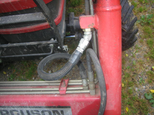

Added 45 adpters to the curl cylinder hoses to reduce bending at the fitting. They were the first hoses to go.

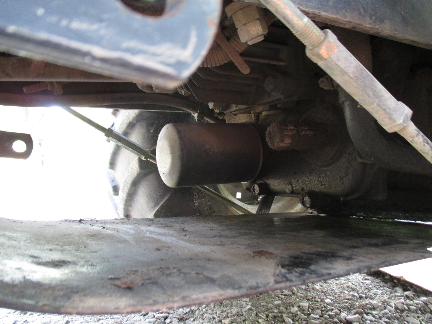

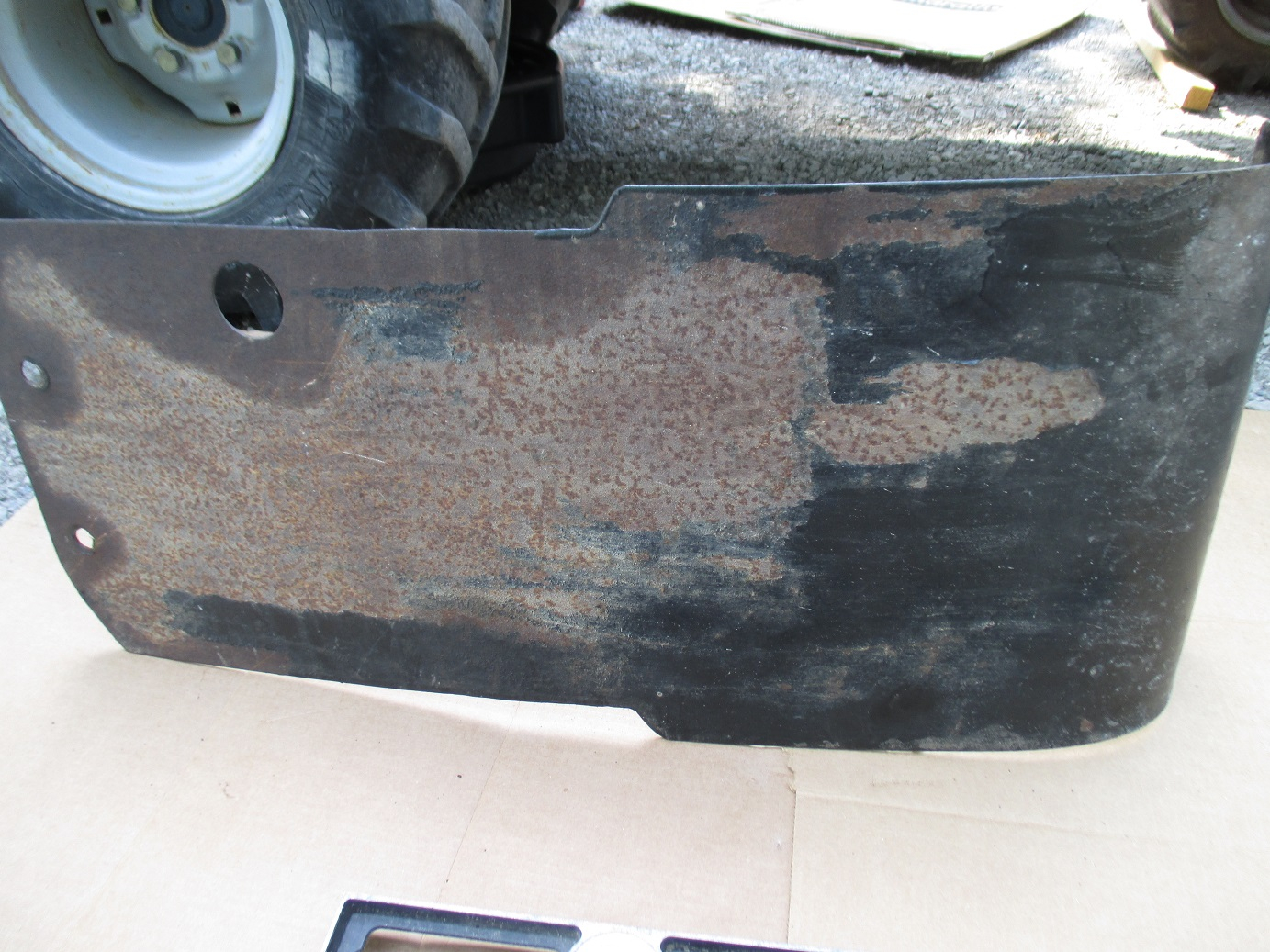

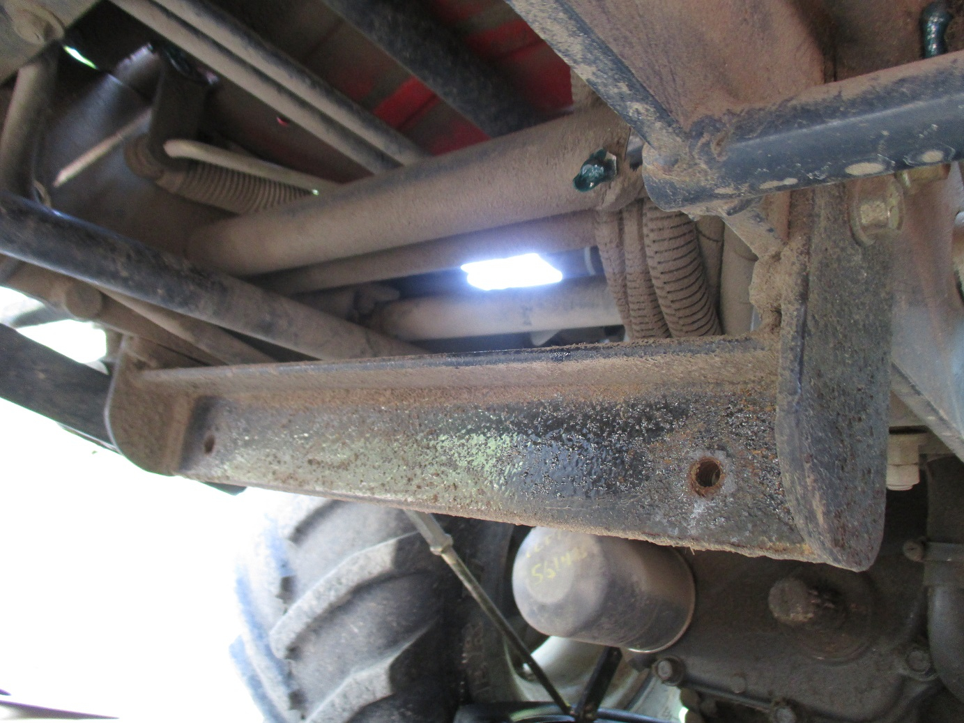

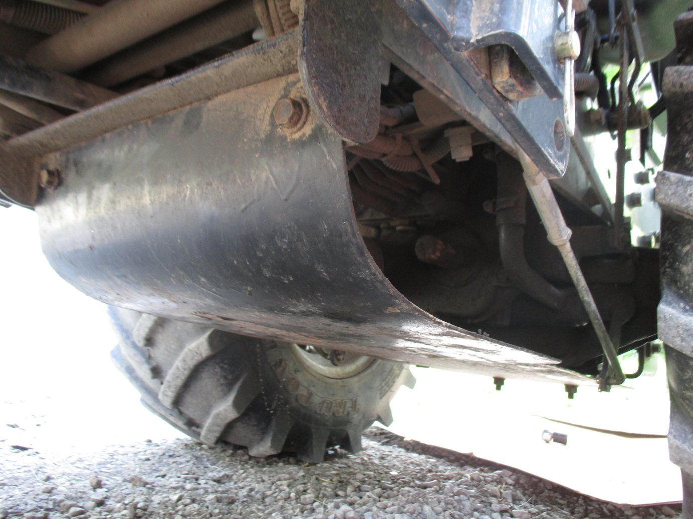

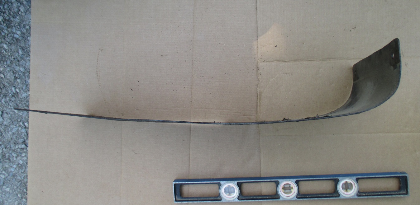

Other big question, have you got a skid plate to protect the hydro filter? If you have a welder, easy to fabricate yourself, if you don't use the mid mount mower.
