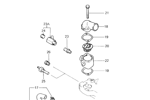

Iseki TX1510
Anyone with a TX1510 could you possibly take a photo of the thermostat housing area on your K3B engine and post it....If I look at K3B manuals many of them show a thermostat and a fitting assembly (see image No 22) mine has neither!!!
/ Photo help please TX1510 #2
The tx1510 does not have a thermostat. It should have the neck (# 18) only
