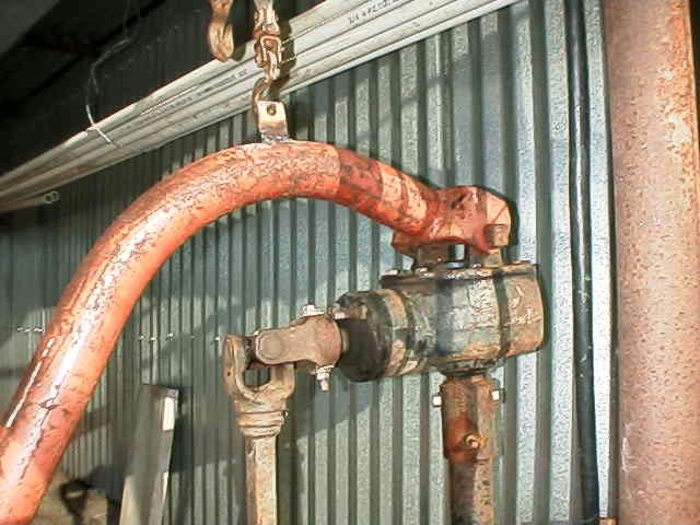

Here is how I did mine, I hook up a come-a-long to the bracket I welded to the PHD, pull the pins and jack it up in my lean-to.
To reattach it, I lower the come-a-long, put in the pens, and drive off.
It takes very little room with the auger and the frame of the PHD both vertical.
I need a lot of paint on mine,
I retired from the FAA in Oklahoma City in 1978 and moved to warmer weather.
Jim

/ PHD stand #13
I like the idea of hanging the PHD and by having a strap clamp or bracket welded on it will always hang the same way.
Wally
