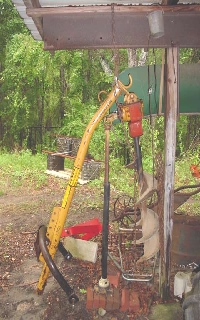

/ PHD stand #4
I use a chain over the beam at the back of my shed. Just back up and swing into place. After hook up, raise enough to unhook the chain and "away we go"
See if the pic is clear enough.

/ PHD stand #5
I hang mine exactly the same way, except from a large bent tree out back. Doesn't take much effort to hook it up or take it off.
