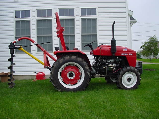

I use a 9" auger and it's mainly in rocky soil. Works great tough if you think how a 2 man auger would be to try to hold back from the torque. Bust a lot of shear pins but thats better than bustin the tractor.
more pics. http://users.adelphia.net/~gizmo/
