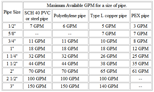

I'm considering using PEX to run water out to our drive way by pulling it in with a subsoiler across a pasture. I'm tapping into a 3/4" PVC line do I need to upsize to 1" PEX based on the attached chart. We plan to use the line to water a 300' strech of trees (using 1/2 gal emiters) and flowers at the driveway, but may use a sprinkler some. My thinking on using PEX is incase the line ever froze it wouldn't burst. Is that a good plan or should I just use PVC?
