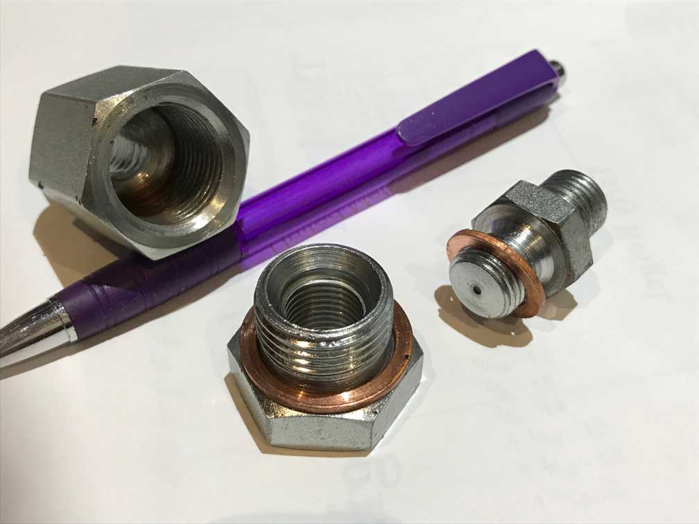

Terry- you can put restrictors in the hydraulics to make the cylinders move slower.
   / Peruzzo Fox Cross 1600 Ditch & Bank Mower Review
#25
Eric,
It came with orifices in the lines:
Is there something better I could use?
   / Peruzzo Fox Cross 1600 Ditch & Bank Mower Review #26
They come in different orifice sizes. See for example Parker XHX7 and LOHL6.
   / Peruzzo Fox Cross 1600 Ditch & Bank Mower Review #27
Eric,
Hello Terry,
You could use parker needle valves to add finer control to each cylinder
The parker metric thread needle valve with a 5 gallon per minute maximum flow rate is
part number #6N616S.
The needle valves have color coded rings to allow quick reference point and some models can be locked with an
allen set screw to prevent tampering.
The folks at Cross Hose and Fittings in Ashville, N.C., are the closest to you and they can help you quickly with what you need.
If you decide to visit them bring the mower manual with you and all your hose sizes as it should have all the information they need to provide you with the correct fittings and needle valves for all three hydraulic circuits on the mower.
You can mount the needle valves on each cylinder to control the oil flow speed on each circuit then set them and lock the needle valves in place and never have to worry about it again.
They will help you with what hydraulic parts you need for your flail mower.
   / Peruzzo Fox Cross 1600 Ditch & Bank Mower Review #28
Eric,
Are there any numbers on the orifices? That would let you see what size you currently have and either order a smaller one, or the correct flow needle valve.
Aaron Z

Sounds like what I need. But Asheville is two hours each way - not a very inviting drive if I can get what I need without going there.
#30
Aaron Z
Thanks, Aaron. Any idea where they would be? I didn't see any when I had it apart, and there's noting on the machined face you see in the photo.
   / Peruzzo Fox Cross 1600 Ditch & Bank Mower Review #31
They should be obvious. If not, I would try a drill set to see the hole size and then use the calculator on Surplus Center to see what the flow rate through it is. Then try for perhaps half that flow rate in whatever you choose whether it be a variable restrictor or a fixed orifice.
Thanks Aaron,
That gives me some ideas to work with.

Hello Terry,
The Parker folks have a find a distributor link and there were other parker suppliers and I did not make list but I can post it late tonight or tomorrow for you.
A parker dealer will also tell you whether you should leave the current restrictors supplied with the mower in the opposing port to have more control of the mower to save you a lot of headaches too.
Those are nice valves. I put one on my loader to reduce "bucket flop". But they restrict flow in only one direction. I think this application calls for restricted flow in both directions.
   / Peruzzo Fox Cross 1600 Ditch & Bank Mower Review #37
Hello ericm979,
This is why I asked Terry to bring all his information about his mower and the metric hose sizes for all three cyclinders if and when he visits the parker dealer as they can help him select the correct needle valve for his needs as they will provide him with the proper valve.
You can purchase a 2 way restricted flow needle valve to control the oil flow from one cylinder port in both directions of travel if desired but; the cost of 2 way needle valve may make purchasing 2 needle valves for each cylinder to control the flow with complete precision at one or two gallons per minute and provide complete control of the individual cylinder.
Leon

Have you had any issues with jerky operation with other hydraulic attachments? When you mentioned jerky operation it made me think that you have air bubbles in the mower hoses and cylinders.
No. As you may recall, I'm using the FEL valves, and there is just way too much flow for the two little cylinders on the mower, even with the restrictor orifice. Feathering the joystick helps some, but still they are too quick.
