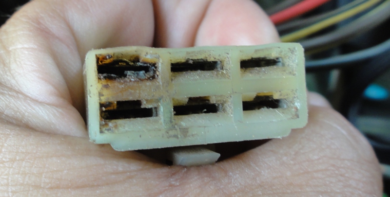

Yesterday, when I ran my mower, there was a loss of power when engaging the PTO where it appeared that the engine was running on 1 cylinder. Adjusted the (new) PTO clutch, and did a compression test on both cylinders (+/-200lbs).
I noticed the left cylinder plug was wet and most likely not firing. Per the shop manual, I tested both ignition coils and the pulsers for resistance and everything was within specs. I also tested both positive primary leads (yellow/white wires)to the ignitions coils and both had battery power.
I then cranked the engine with the right cylinder plug out and grounded to the block and had good spark. Did the same on the left side and no spark. Switched coils and plugs and still only the right side would spark. Bad igniter?? Any suggestions would be appreciated. Thanks.

Check the battery voltage when running, then again, after you engage the PTO.

I would just rule out voltage drop from a bad battery, voltage regulator or a bad wiring harness connector.
Does the alternator light come on when the switch is turned on?
I 1st thought the PTO clutch might be almost shorted and bad, but you mention the clutch is new.
Did you check the ohms in the clutch before you installed it?
The stator should be producing about 26VAC on the 2 outside wires at the VR connector.
Then the battery should be about 13.5-14.5 VDC when running.
If the clutch solenoid is sucking this way down it could be several things.

The VR plug I am suspecting is a common problem. It has the circuit for the alternator light in it, and also the stator supply and the battery charging DC supply. They heat up and melt part of the white nylon connector and you may have to replace the plug and all 6 pins.
This is a bad one..

After going through the ignition system with a process of elimination, the only component left was the ignition module. I changed it out and now the engine runs like new. Those FD501V's are tempermental buggers but when running right, tough to beat. Thanks for your help. BTW, I did change out the VR plug (melted) several years ago when the regulator crapped out. I pulled it and found some evidence of heat build up short of melting. Had a spare VR kicking around so I changed it out along with the spade connector (I had left from the last go round)for the charging wire. The nylon plug was OK.
