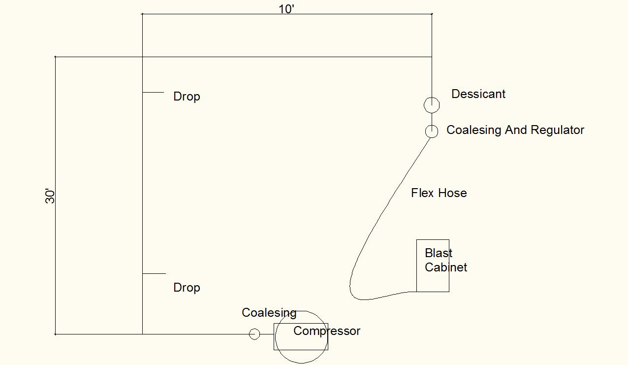

Regardless of material used, there are a couple of things to keep in mind. This may be common knowledge. If so, I apologize for stating something that is obvious. Both points concern moisture in the pipes.
First of all, the horizontal runs around your walls should not be exactly horizontal. It should have a slight fall away from the compressor, with the last drop being vertically downward with a drain valve at the bottom. By falling away from the compressor, any moisture that accumulates in the pipe will drain to the low end. You can crack the valve open ever so often to blow the moisture out of the pipe(s).
The second point concerns the individual drops themselves. Wherever you "TEE" into the pipe to make a connection point, the Tee should be pointing upward. This will prevent any water accumulation from getting in the connection for your air tools and allow the moisture to flow to the low end of the main pipe. For this reason, my main pipes are run around the shop at about waist level. I Tee upward, with each connection pipe having 3 female quick connectors.

I've been designing and installing compressed air systems for 20+ years. All have been commercial. The one I installed at work is in a 100,000 sf building. The entire perimeter is in 2" black pipe with 1" branches and 1/2" drops. Our main compressor is 100HP and can provide over 400 CFM @ 120 psi.
You can use some of the "rules of thumb" for a small system installed in a garage or shop.
You can use copper but, as has been stated, use heavier schedule pipe. The preferred pipe is schedule 40 black iron up to 2". Any bigger and copper is eaiser to work with. Never use galv or PVC.
Anytime you can, do a perimeter loop, it will insure that from any drop used you will get maximum air flow.
Always halve the drops compared to the mainline IE: Mainline is 1" use 1/2" drops.
If you can, invest in a drier, even if it's the one from HF. Water will kill air tools, and ruin a paint job. At the very least get a filter with a auto drain.
As has been stated use "T's" and go up and over and back down on the drops.
