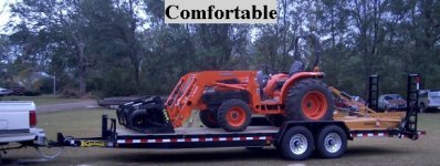

Just bought a new L3830 with LA723 FEL, R4 Tires, 72" Woods BB and 72" Woods brushhog. Please tell me what size and type trailer you feel would be absolutely "perfect" for transporting this unit. The need would only be occasional (maybe once a month) and the distance no more than 15 miles.

You didn't say what you would be towing it with,but this one works well for me.
It's a 24ft 14,000 GVWR from Kaufman Trailers, and it's long enough to carry the tractor with FEL, and the bushhog attached without overhang.
What ever you get make sure it has brakes on both axles, my rig as shown weighs 10,300 lbs on the CAT scales at the truckstop and that doesn't include the F-250 pulling it. Truck and all weighs 17,500 lbs and I pull round trip to my land about 40 miles every saturday the weather will cooperate. Trailer pulls very well and I am quite satisfied with it.l
It cost $3645.00 delivered to South Mississippi.
Hope this helps
Leroy

Thanks for the reply. That's really a good looking trailer you've got. However, I only have a Dodge 1500 (with a class lV hitch) and after buying this tractor do not have the available dollars left to upgrade to a larger truck. I am hoping that since transporting will be infrequent and the distance short I can get by with less length and weight in a trailer. According to the dealer the combined weight of the L3830 and LA723 FEL is 4950 lbs. After looking at your photo it certainly does not appear that I would be able transport this tractor with the 72" brushhog on anything less in length than your trailer. In your opinion, what would be the shortest trailer that would easily accommodate just the tractor and FEL? I am sure a double axle, 7,000 lb capacity (obviously with electric brakes) would handle it with no problem.

Looking at the picture of Leroy's tractor on his 24' trailer it looks he may have a foot or two to spare. Also, if yours just has a bucket and not a grapple like his you'd pick up another foot or two. I'm betting you could get away with a 20' trailer and still be able to haul the loader and bush hog with the bush hog wheel hanging off the back of the trailer.
