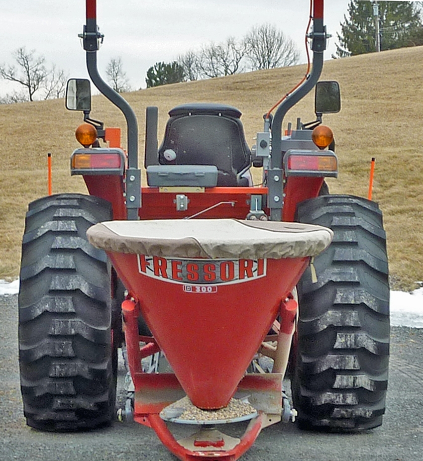

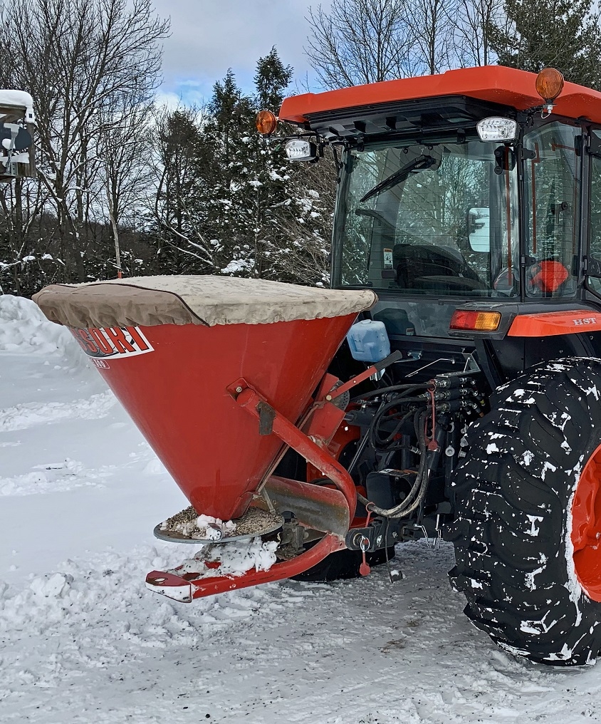

30 years ago, I modified an old Fressori steel cone fertilizer spreader to spread a mix of coal ash & rock salt. Both are corrosive, but I store it inside and use a cover to keep out rain & snow when spreading. The only maintenance I do is pressure wash it at the end of the season. I used it behind my old L3430 and more recently my L6060. The only corrosion on the spreader is on the deflector plate, and that is relatively minor. Neither tractor has any.
The trick is to keep everything dry when not in use, rig a shield to keep the spread material off the tractor, and hose it off at the end of the season.
View attachment 3522702 View attachment 3522703
I bought a poly Bush Hog for spreading sand and salt. I haven't got to use it yet. I messaged Bush Hog about a cover, haven't heard back. Where did you get your cover?
