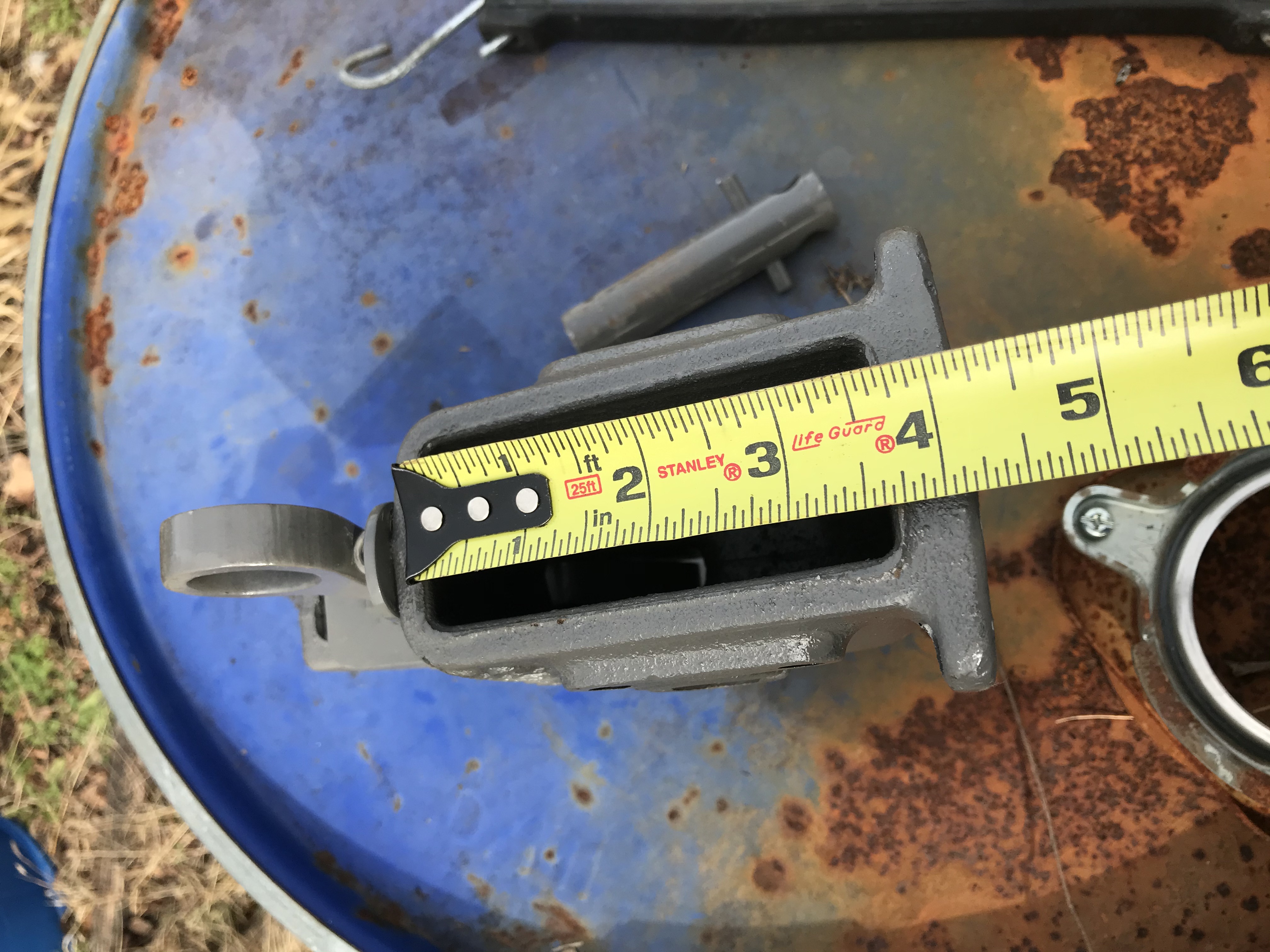

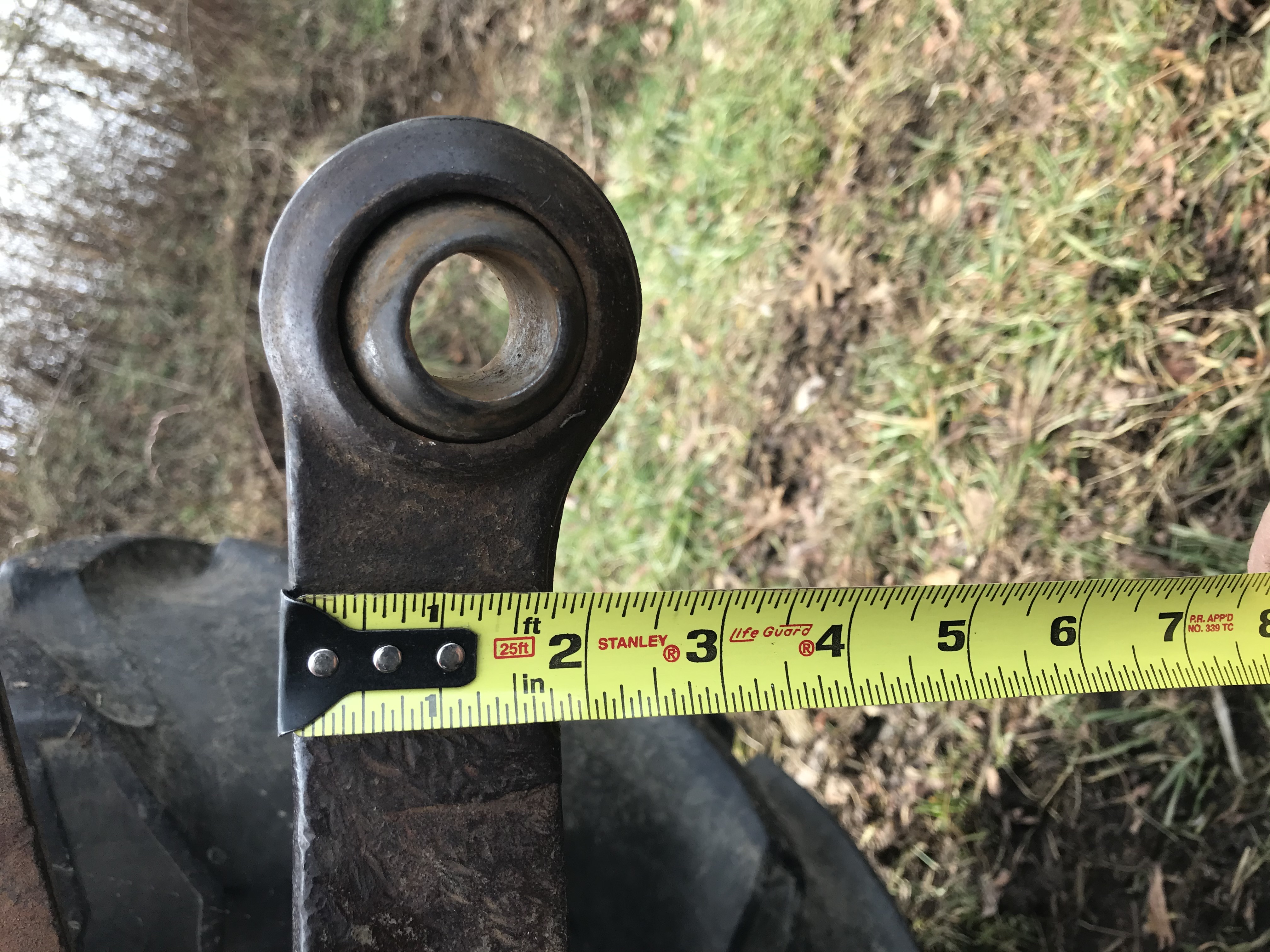

i'm not sure my point is being understood or i'm not understanding the responses. I do have the proper Pat's Easy Hitch which is Cat 1. I think the best thing for me to do is figure out how to post pictures on this forum and see what happens. Thanks to All!
I think I've got it.
If I align things up as you can see the lower adjustment nut will not even touch the lift arm. If I hold the Pat's Easy Hitch up a little higher on the lift arm neither the top adjustment bolts nor the bottom adjustment bolts are making really good contact or so it appears to me.
Notice in the picture the height (top to bottom) of my lift arm. which is considerably less than 2"
The opening of the Pats Easy hitch is nearly 4"

I think it will work fine if you are able to shim the bottom, then the sides with blocks to take up the space.
   / Pats easy Hitch #8
What I understand you to be saying is that you need to take up around 2" of space and neither of the included shims is even close to thick enough. Hopefully someone who's mounted the hitch on a MF 230 will respond.

Well, this project has taken an ugly turn. I don't think a shim will do the job. You may need to increase the height of the side pieces. If you can contact Pat's by phone you will probably get better results than by email.
