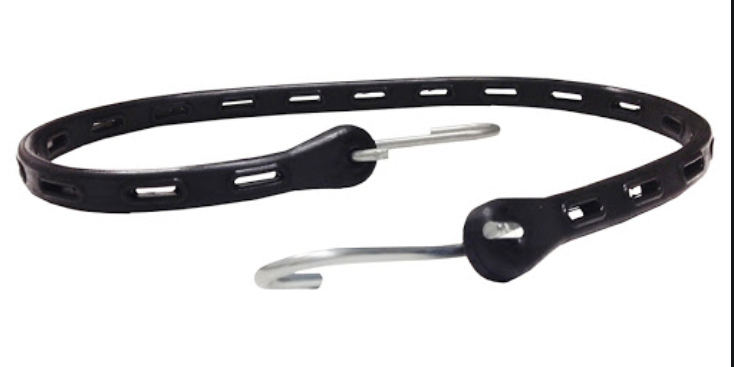

I lost my spreader bar some time ago. I started using a rubber bungee with slots and have never thought about replacing the spreader bar.

   / Pat’s Easy Change Spreader Bar Mount #26
Where do you attach the bungee(s) to spread the lift arms?
Your question stumped me - I had to scratch my head!
I had to sit and think about my process when hooking up implements. In conjunction to the bungee, use the check chains to tweak the spread.
It seems to work for me - trust me, I'm lazy, and if I had to struggle with it I would not do it.
   / Pat’s Easy Change Spreader Bar Mount #27
